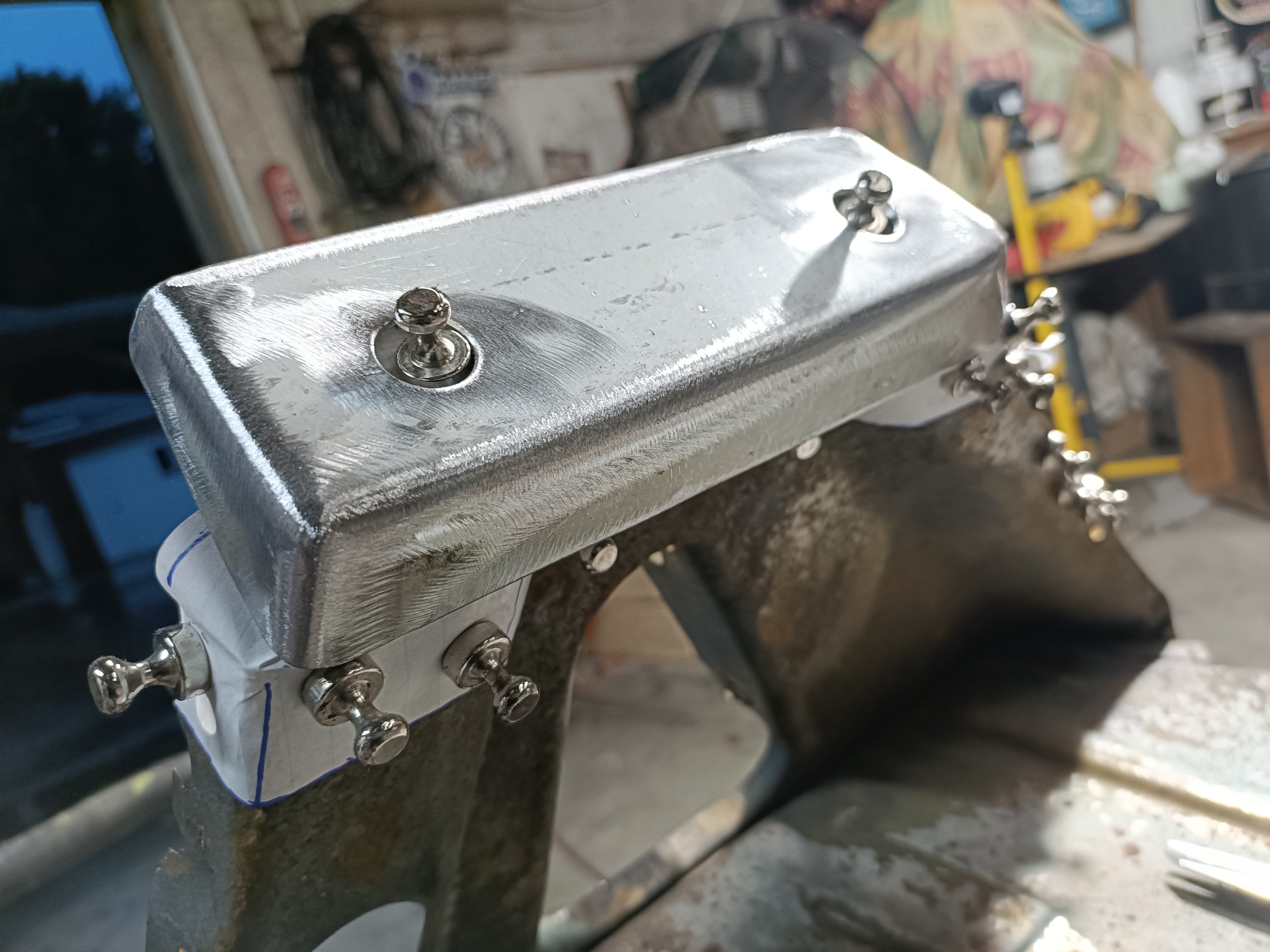

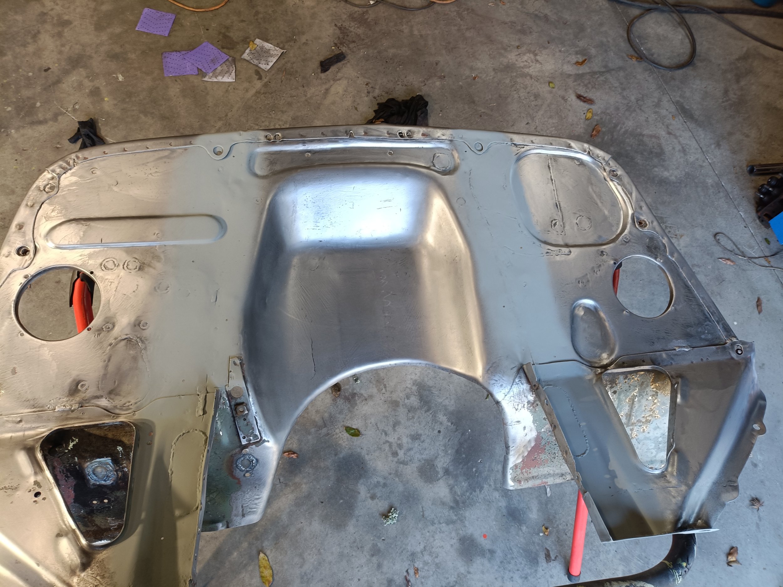

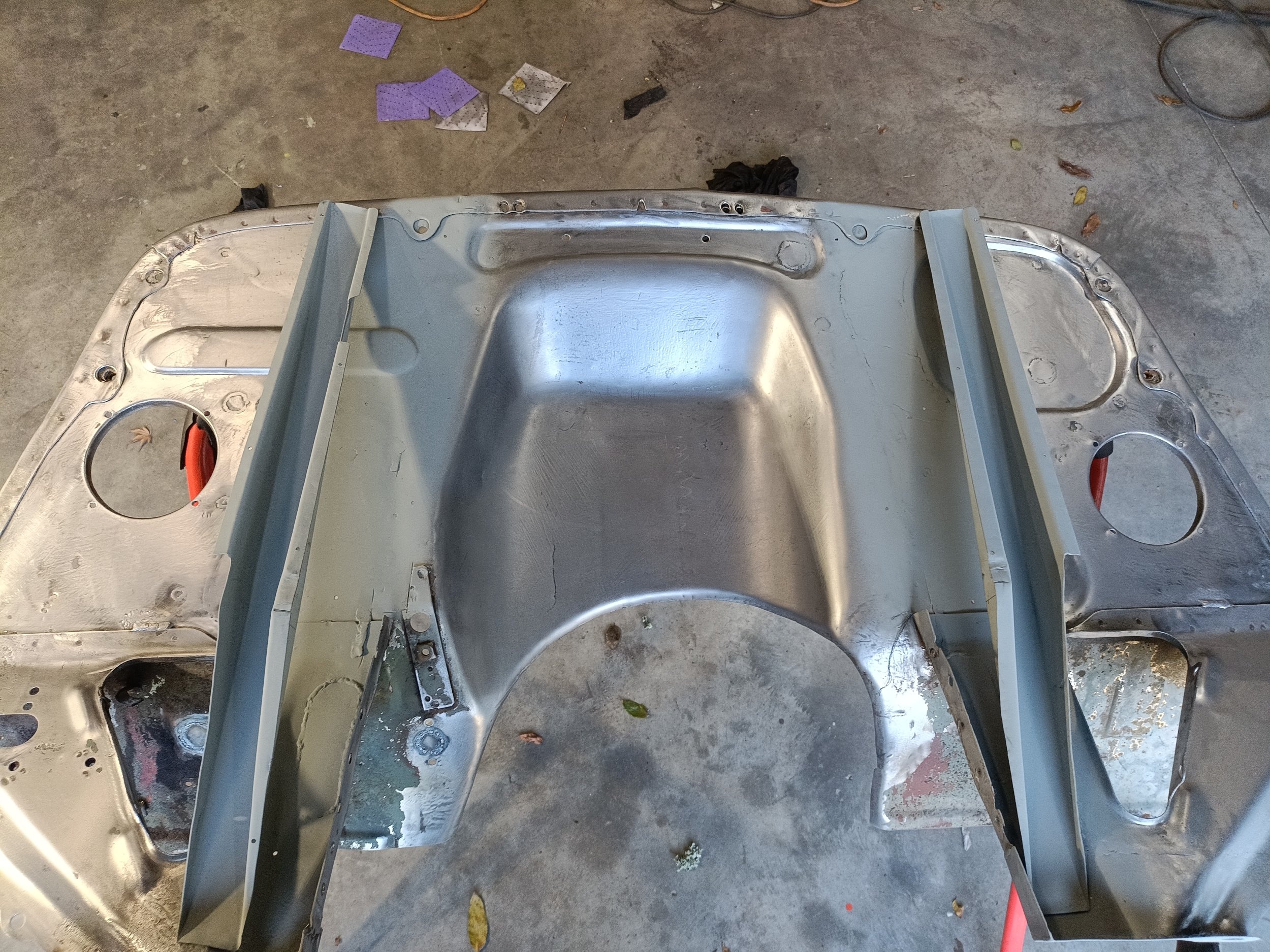

    I finally got back on the job this week after a brief interlude. I started out by grabbing another load of panels out of the mol***es, straighten a few then decided to make a start on the firewall repairs and mods.
    The firewall came with the car from an earlier donor because the delivery one has been unceremoniously removed in the past by someone.
    Filled a bunch of holes so I can set them where it suits me later.

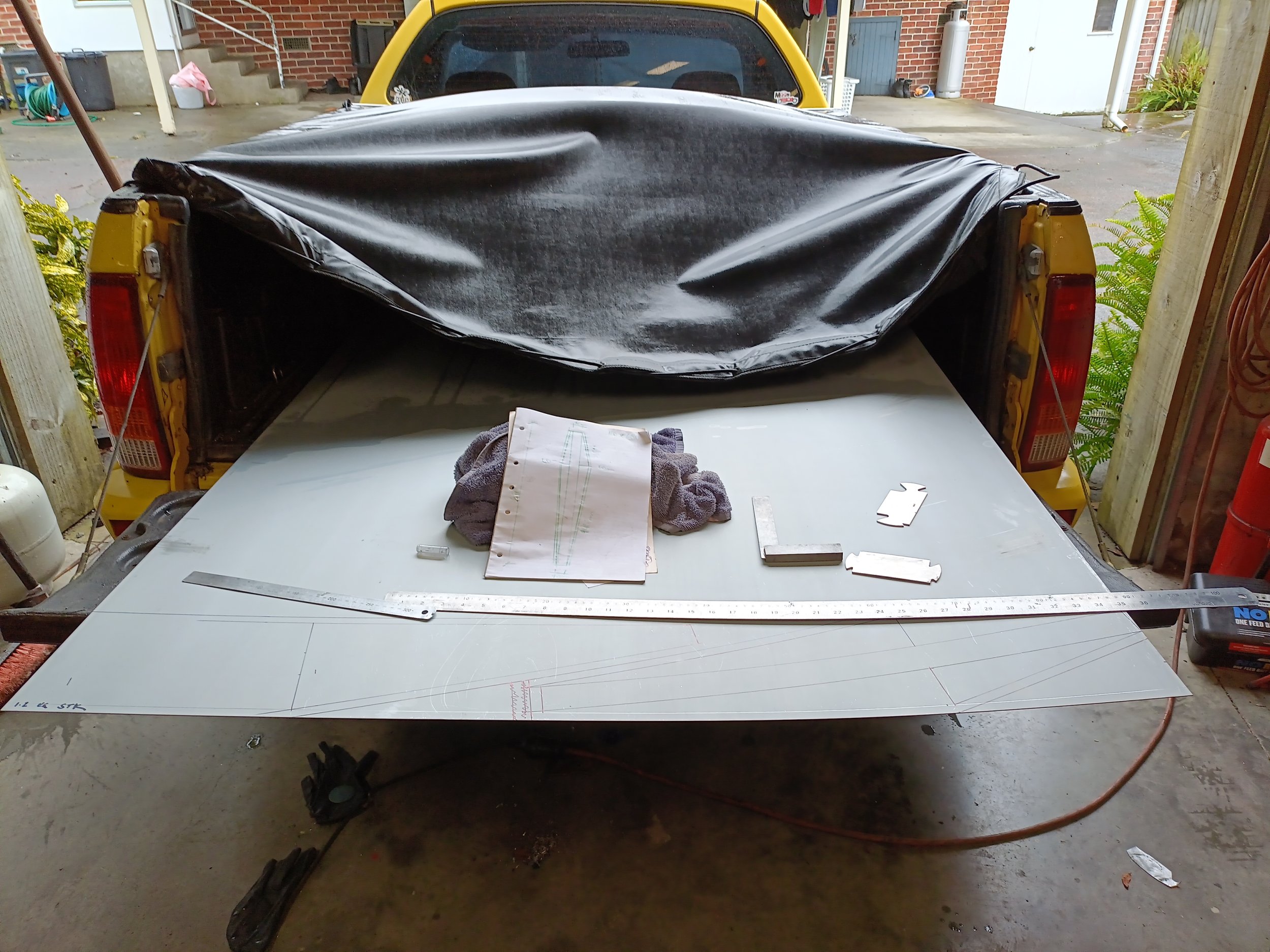

    A trip into town for a sheet of steel.
    The original vertical braces were in the way on the right side, interfering with the head and have suffered from a bit of cancer at the base. So I have redesigned them and given myself more space.
    One side sorted to a cleco stage and happy with the form and function, this format should help with the firewall mounted booster and master, adding stiffness.

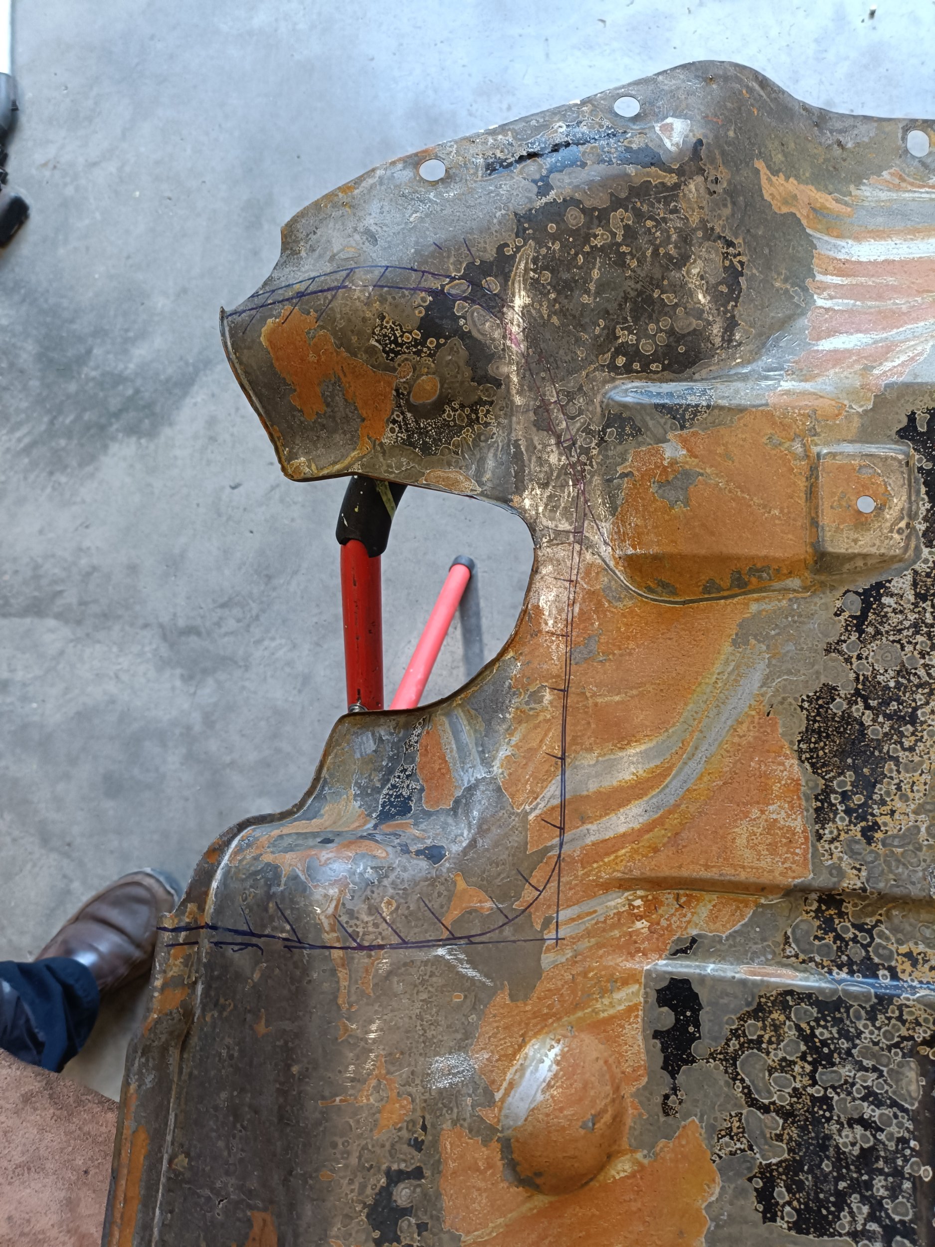

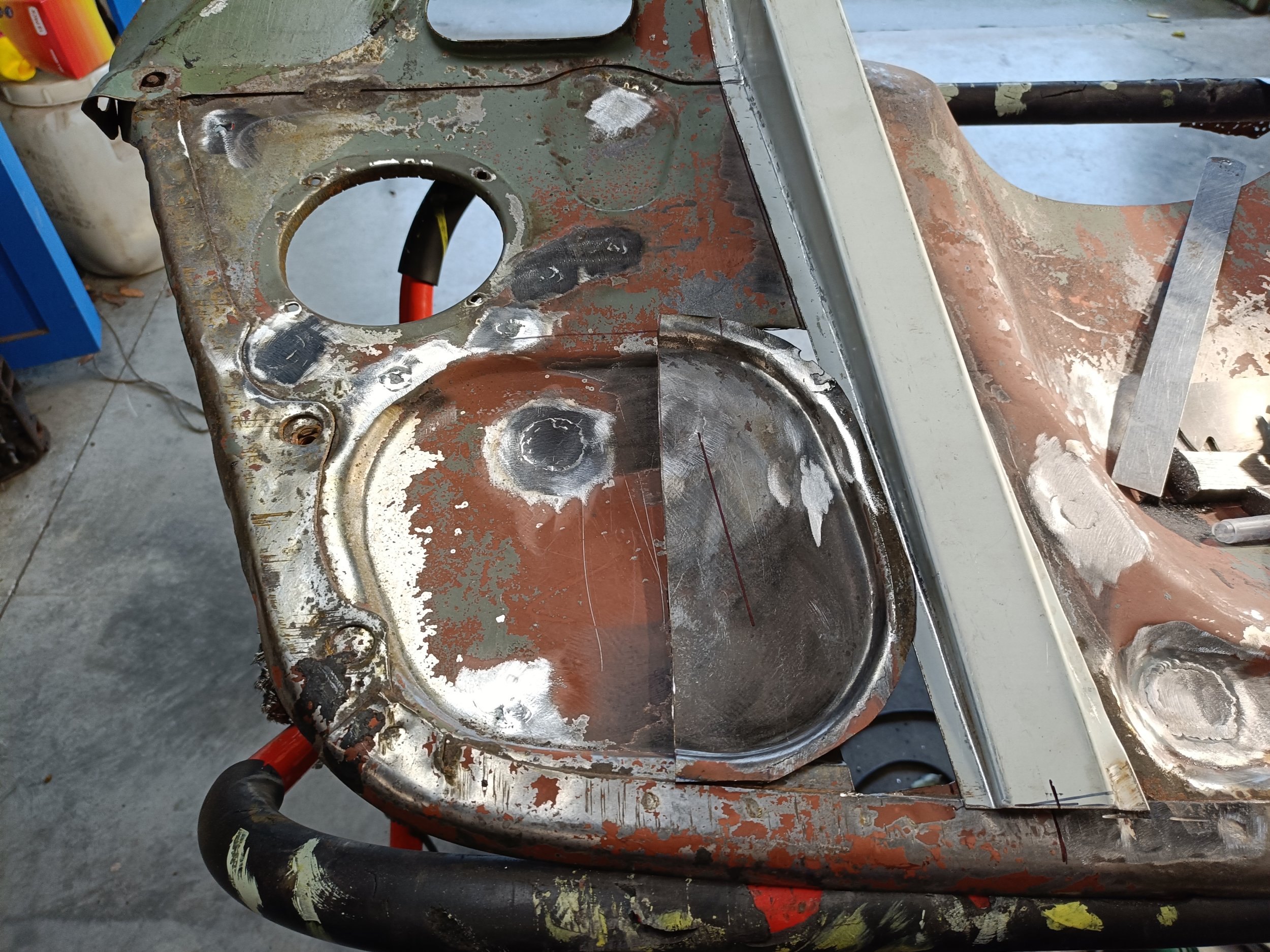

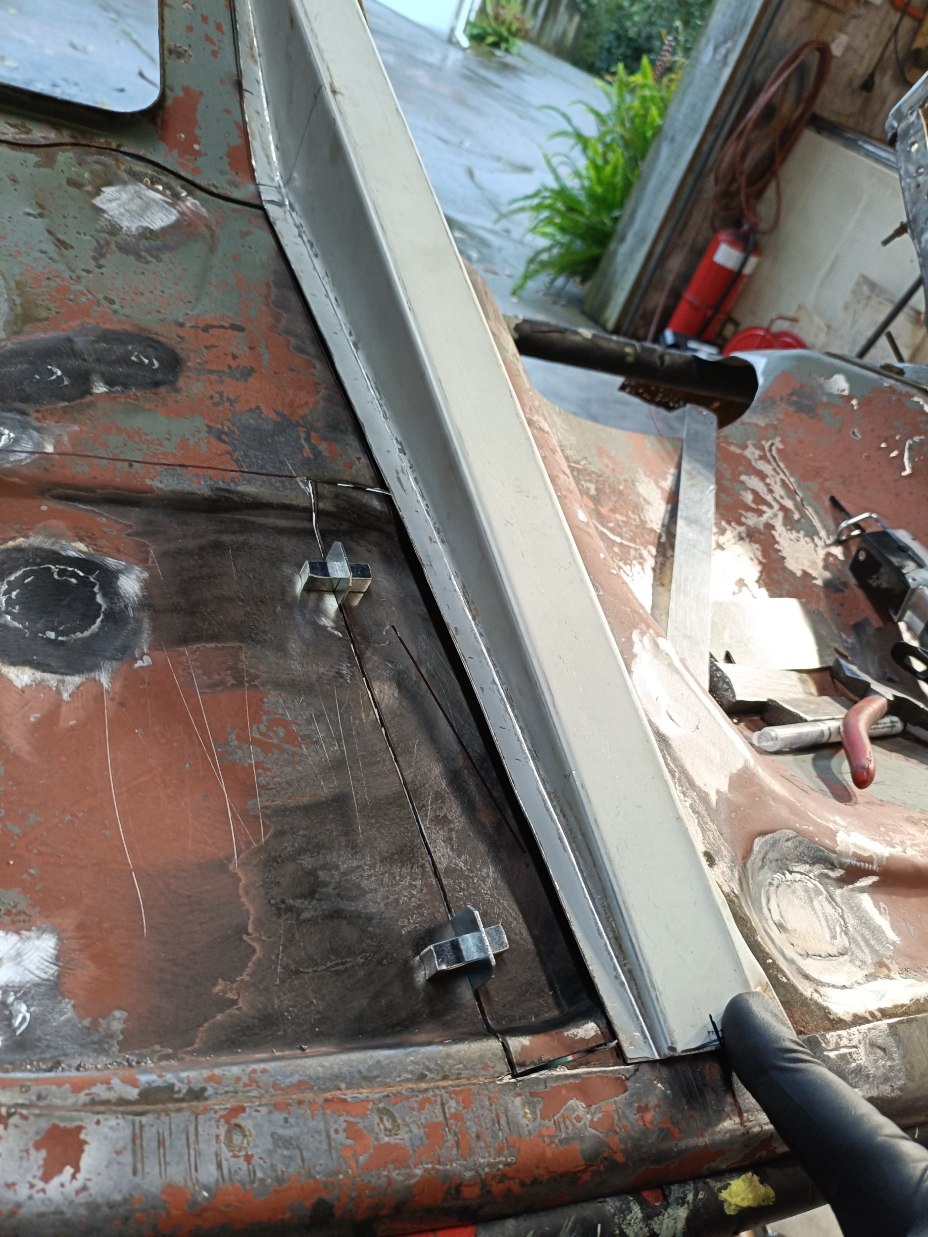

    Another busy day today, dodging the rain. Working on the left side of the firewall. Where I am changing the brace on this side was going to interfere with an existing depression formed. So out with the saw and make it fit. IMG20250711110124.jpg
    As you can see here.
    I got to play with my new air saw to cut the corners.
    Chopped out and......
    ....moved over to clear the new brace.
    Frankensteined to fit and clamped in with the panel clamps from timu!
    Lots of welding and hammering later.

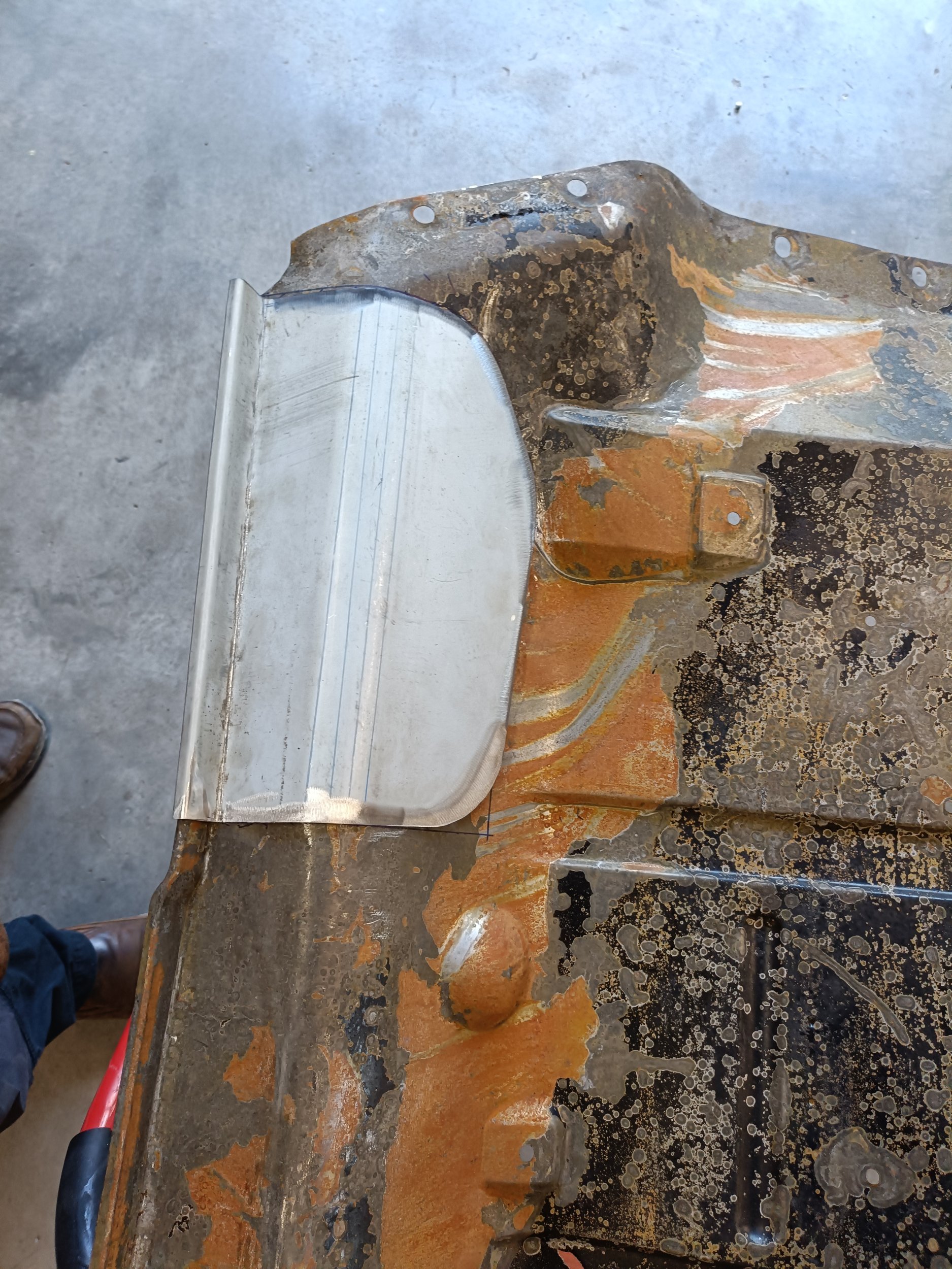

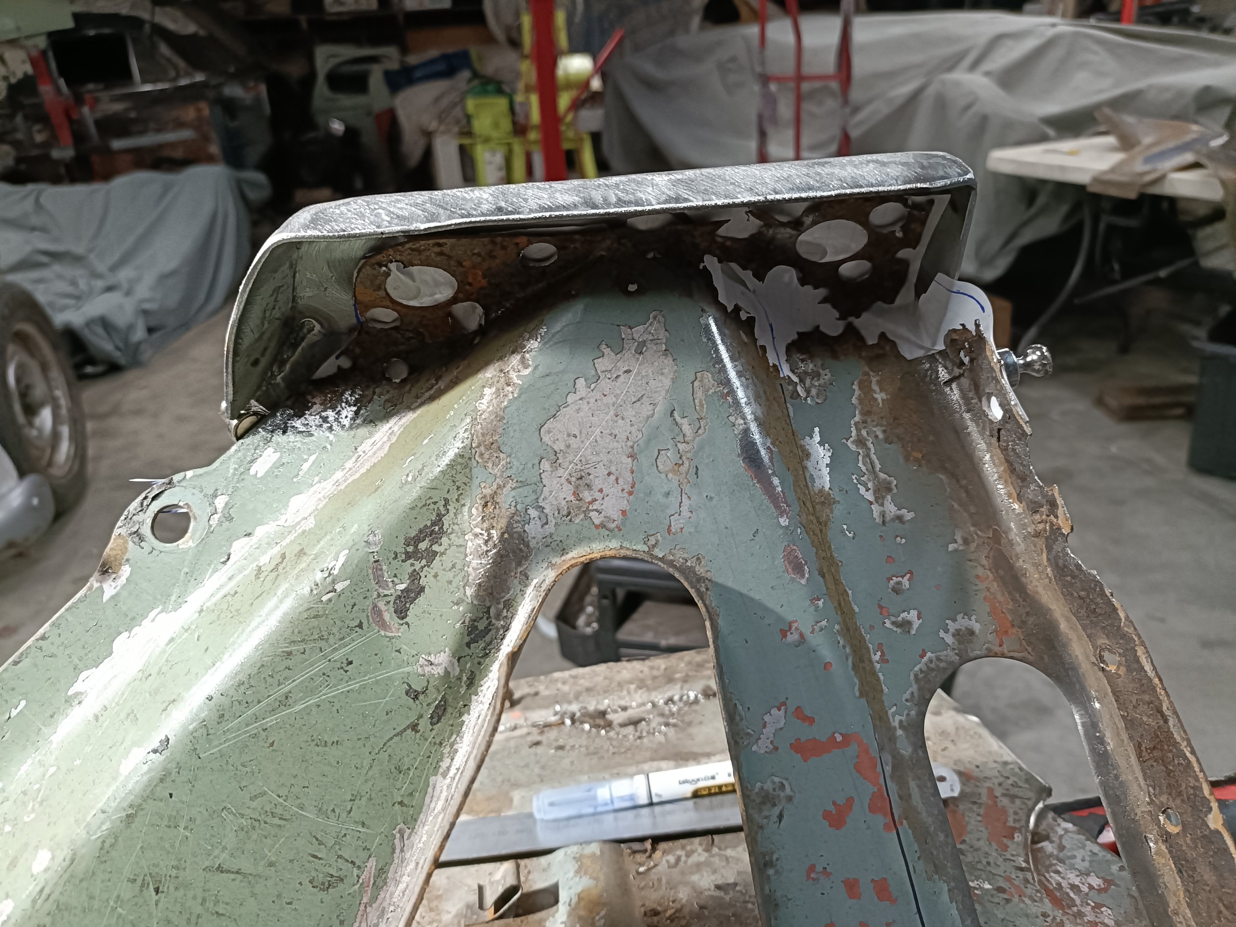

    Then on to the foot that had some cancer issues. I made a new foot from 2.5mm with a bit of bending and a few welds.
    Tomorrow I will make the light gauge pieces to finish off the foot.
    Pretty happy with progress so far.
    Will look tidy and easier to paint and clean than the original braces too.

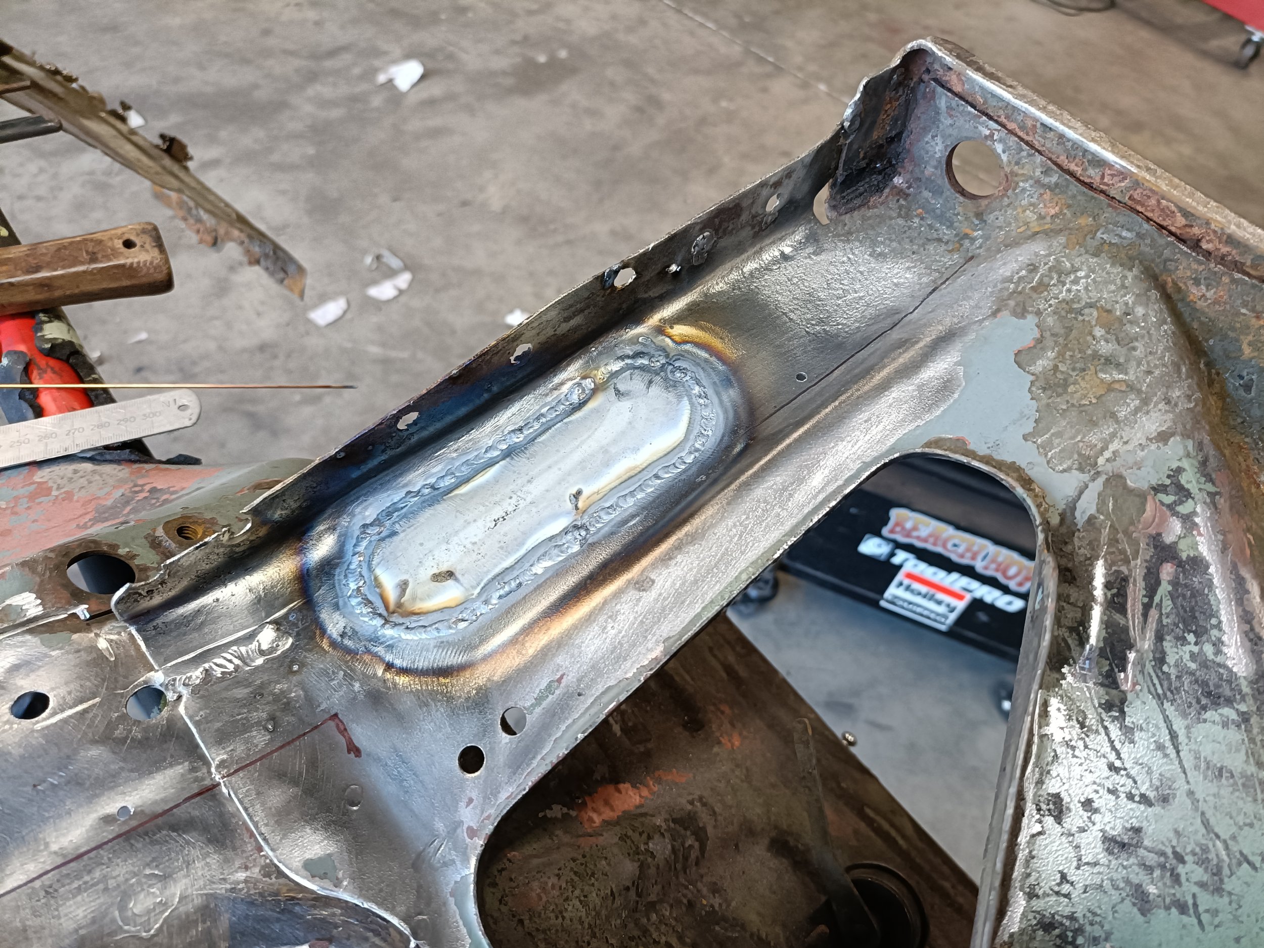

    No resting on a Saturday, carrying on with the braces. IMG20250712155941.jpg
    Replacing the gangrenous left foot took most of the day.
    And filling in a couple of holes to make the new braces sealed boxes.
    Basically ready for some weld through primer inside the new braces and blind pockets and it's off to get spot welded onto the firewall.
    Left side sorted.
    And the right.
    Cheers fellas, time for a brew!

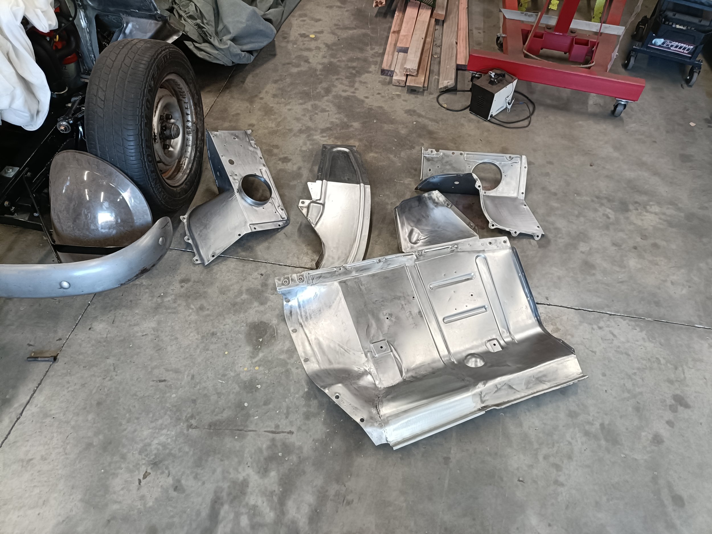

    Chopping out the ugly and cleaning up panels ready for etch and epoxy today.
    The left side inner fender had an ugly deviation to go around the steering box, not any more!
    Trimmed and fitted.
    Welded and cleaned up.
    And a bunch more panels cleaned up ready to etch and epoxy.
    That makes nearly the entire front clip all cleaned up and in epoxy.

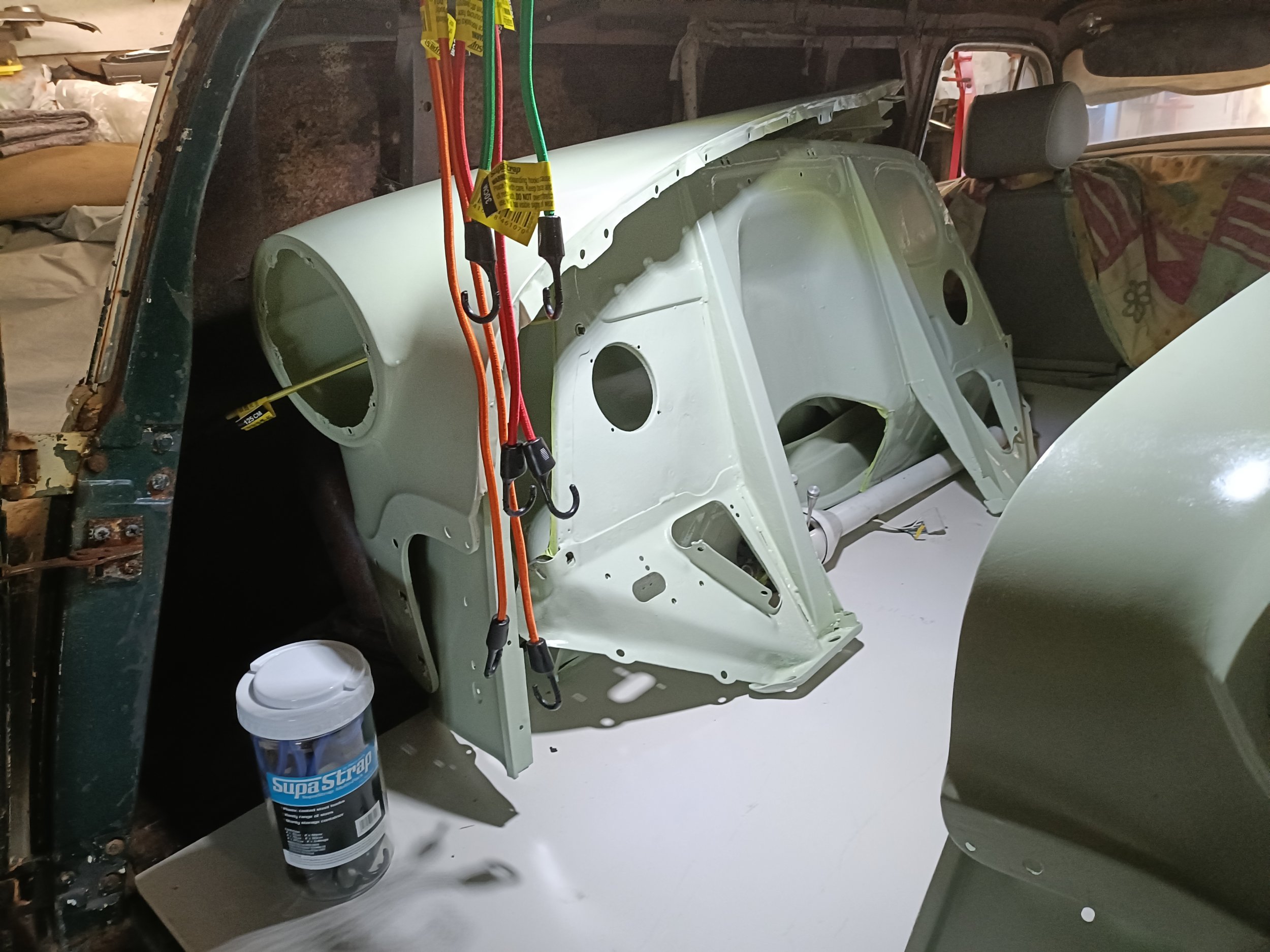

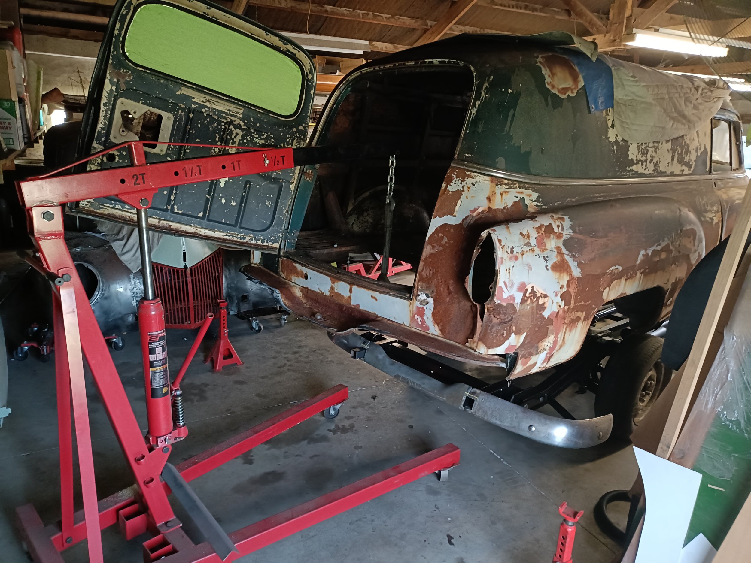

    We had a big day today resetting the shop so I can do a bit of maintenance and finish a couple of jobs on the coupe. To make a bit more room in the shop I decided to put the delivery ch***is under the body.
    So I lifted it up nice and high to roll the ch***is in.
    I only have a couple of tall stands, so I had to hoist the back up with the engine lift through the door.
    Then I lowered it all carefully down onto a couple of blocks on top of the ch***is because there are going to be a few spots that don't fit......yet!
    Once down and happy I decided to make use of the space in the back to store all the panels that are painted.
    Playing panel Tetris in the back worked well.
    Both front fenders, inner fenders, both halves of the hood, firewall and plenty more all went in.
    Now it is all tucked in the corner with the seats and steering column in there too! IMG20250721163253.jpg
    I found the front valance sitting on the roof too, so it is in the mol***es for bath.

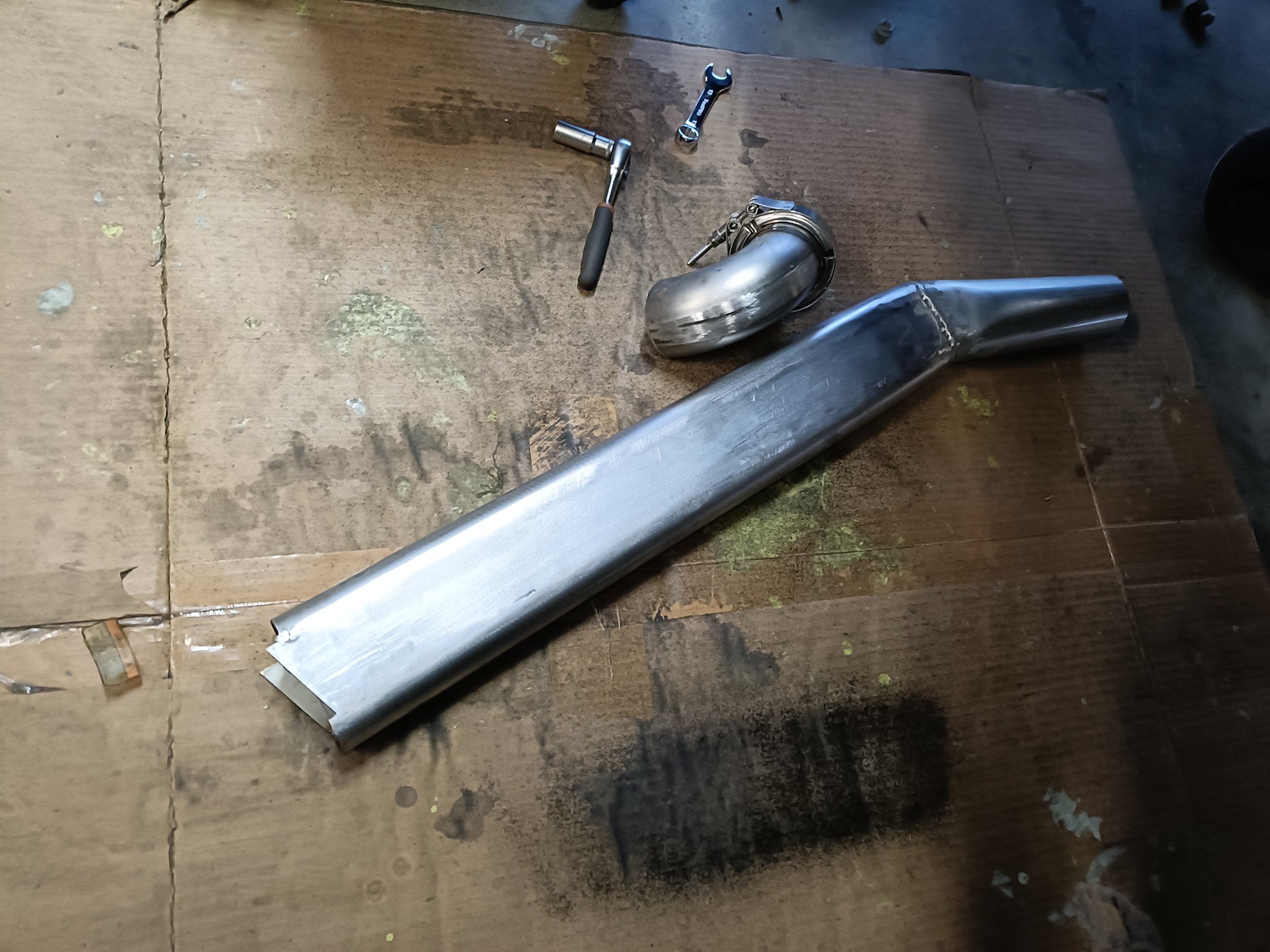

    I calculated the cross sectional area of 2½" tube and made a flat profile tube that had the same cross sectional area, and didn't hang below the bottom edge of the ch***is.
    To make a transition piece from round to flat, I simply squashed one end of a short tube in the vise, then hammered the radius over a heavy wall tube to get the profile right.
    A little t******* and fettling to get the pieces to fit each other.
