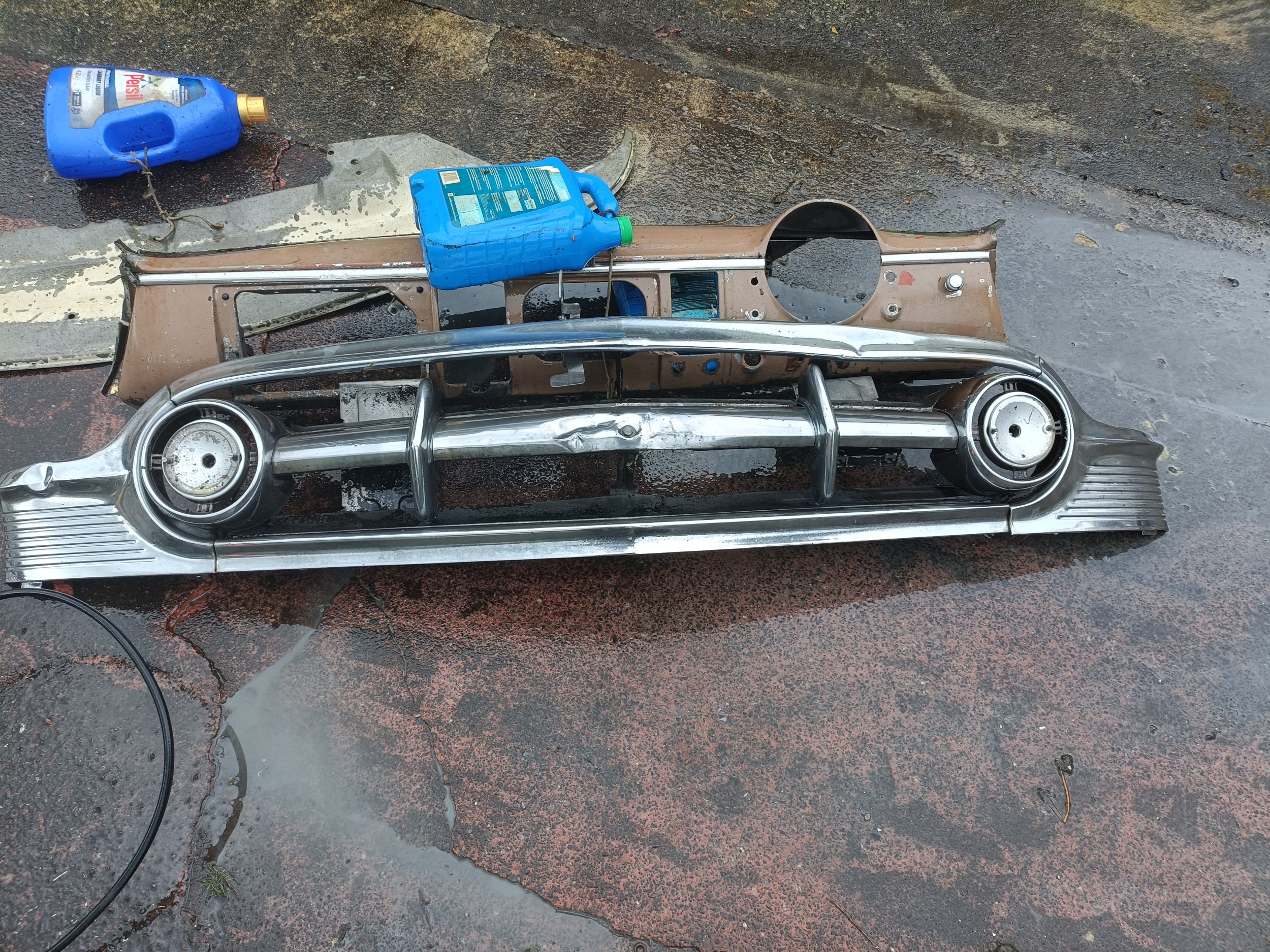

    I placed the door in the mol***es bath for a spell and pulled the panels that were in there.
    The front valance, spare dash and grill had been in the bath for a while so I have spent some time on them
    I tied plastic bottles to the panels as floats to make it a bit less messy to get them out and shuffle them occasionally.
    I proceeded to break the grill down to all it's individual components to get access to all the surfaces to treat them all and coat for future protection.
    After mol***es dip, water blast, sanding, Scotch pad, phosphoric acid wash/Scotch scrub, water wash, heat dry, dry Scotch, prepsol wash they are ready to etch prime.....phew!
    So glad the pieces are cleaning up nicely with very little rust or damage that a few taps with a hammer and dolly haven't fixed.
