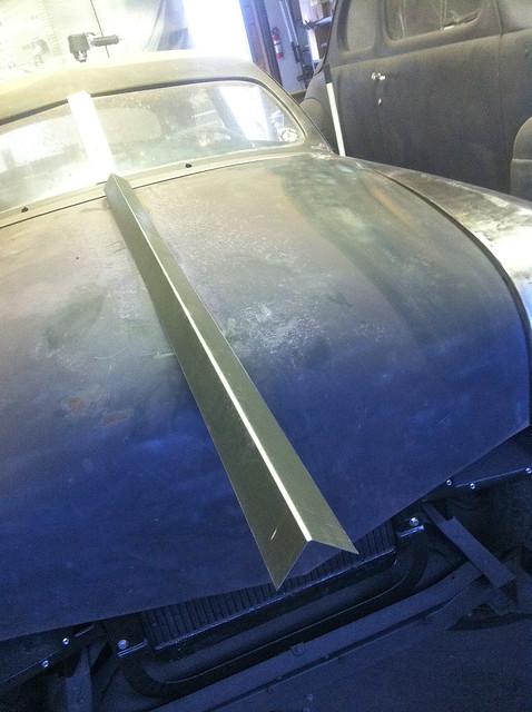

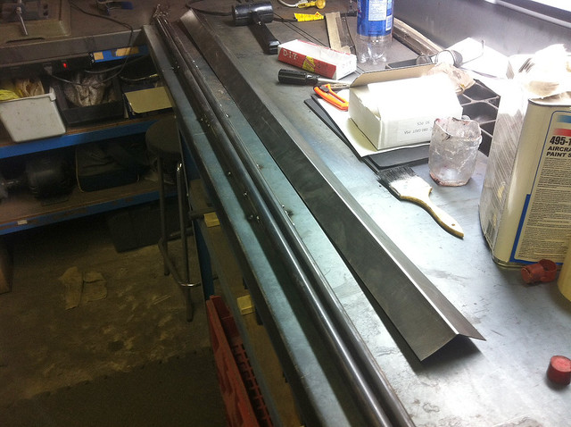

    I do have a homemade hillbilly bender that is ok for not-too-accurate bends up to about 30" wide, but for this I ordered a pre-bent hunk of 18ga 90° angle...
    I thought about stopping there, just duct-taping it on and calling it done, but it kind stuck out like a proboscis monkey...
    ...which come to think of it would've come in mighty handy in a joust. I haven't had to defend any maiden's honour lately, so I decided to go ahead with the rest of the job.
    I ordered 60" of angle, I would need about 54" or so, so some bending and t******* was in order.

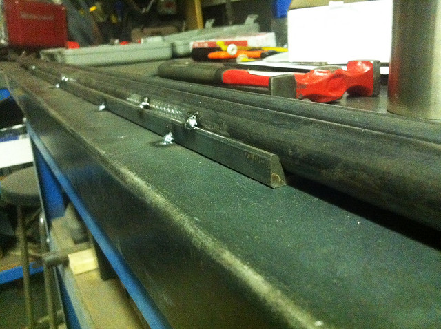

    I came up with the brainwave to make a jig and bash the **** out of it...
    With the theory being something like this would leave a nice rounded peak in the steel...
    I keep a 12ga under the bench and the 14ga on top, for just such an occasion...
    Testing my groove...

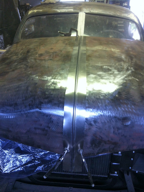

    I slapped it on the car and started to think this might actually work...
    I used a steel bucket that was handy (and surprisingly not full of ice and beer) to bend the strip to roughly the right wang...
    Here's the part where all the real metalworking guys out there in HAMBland say "you did WHAT?!"

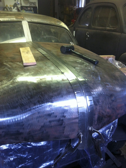

    Since I don't have a shrinker, I made a series of cuts to get the steel to lay down and play nice. I also tacked the strip to the hood and used a hammer and wood block to gently(!) work it into shape...

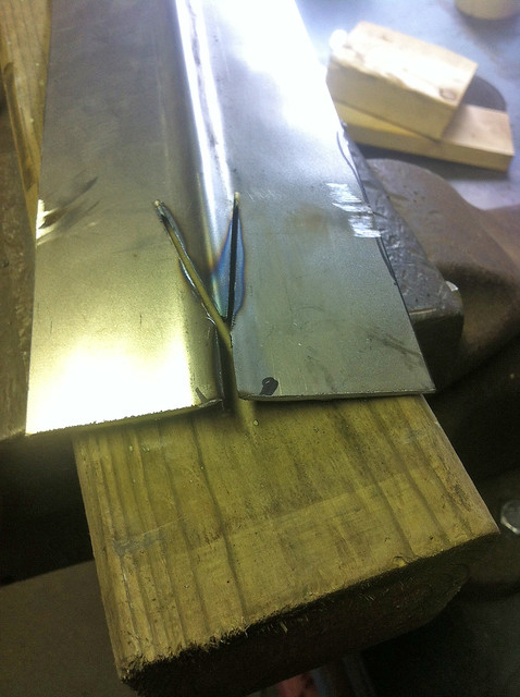

    Then I turned my attention to the tapered ends of the peak, they need to end before they get to the edge. If I knew what I was doing I would have hammer-formed the metal, but since I'm kinda clueless about stuff like that I planned to make some cuts. Again, the metal guys are laughing...
    Cut a V and notched the centre out to give the metal somewhere to go when I hammered it flat...
    After a bit of finagling, swearing and shimmy-shystering, I got the darn thing tacked in...

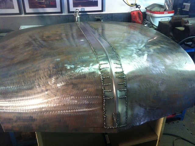

    Patience is a virtue. Tack... go for lunch... tack... go watch some tv... tack... crack a beer... tack... don't drink that beer because my welding skills are ****ty enough as it is... tack... tack... tack... keep it cool...

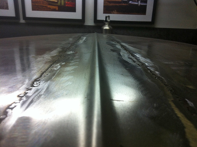

    Jump around, tack tack tack, until it's all welded up and hopefully not warped too damn badly...
    Our burgers can't be beat 'cuz we grind our own meat. Grind grind grind grind grind...
    Pardon the ****ty welding, this thread is more about making the peak and getting it to fit rather than trying to showcase my poor-*** welding skills. I'm not proud of my welding, but I did get the damn thing straight...

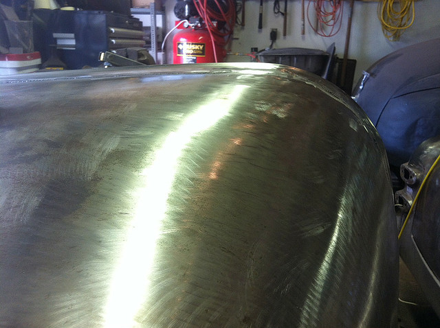

    ...and tapered...
    Still have lots of welding and grinding to do, lots of chances to screw this up yet, but so far it's looking good like a hood peak should...
