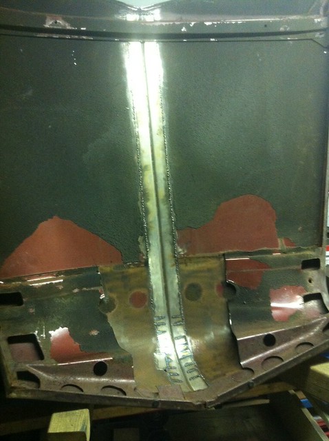

  12. I REALLY wanted to update this thread today with pics of the inside of the hood all finished and lookin' spiffy. Instead, I got precisely this far...
    I cut out the inner support structure and started to clean it up, then just had to take care of one little household chore that wouldn't take any time at all...
    Well, there's always next weekend. :rolleyes:

  28. Managed to squeeze in a couple hours on the weekend, to so a bit of an update.
    Got the underside cleaned up a bit. This is a driver (or will be... I hope... some day), so I didn't worry toooo much about cleaning off all the existing undercoat ****, but I did make sure my welds were solid... ugly, but solid...
    Stuck the bracing back in and tacked it up. Had to get creative with my clampage...
    I'm not planning on opening my hood in public, but this will be seen so I spent more time cleaning up my welds and grindin' 'em down...
    And when in doubt spray some black **** over everything...
    But then I wasn't happy with the exposed welded seams, so I went back and whacked 'em down a bit with a flap wheel then resprayed more black ****. Looking better now...
    Then I got bored and took some artsy shots. I guess I need to figure out what the HAMBigram thing is all about if I'm going to keep this up :D
    It's pretty obvious that I'm no metal finisher, but once this is epoxied and filled a little (not a ton) it should clean up nicely. Hard to get a shot of the peak with so many reflections...
    This is where the magic happens :D
    Next I'm going to have a look at those really nice fenders that took me so long to find... and I'm gonna cut 'em up. But that's a story for another night. :D
