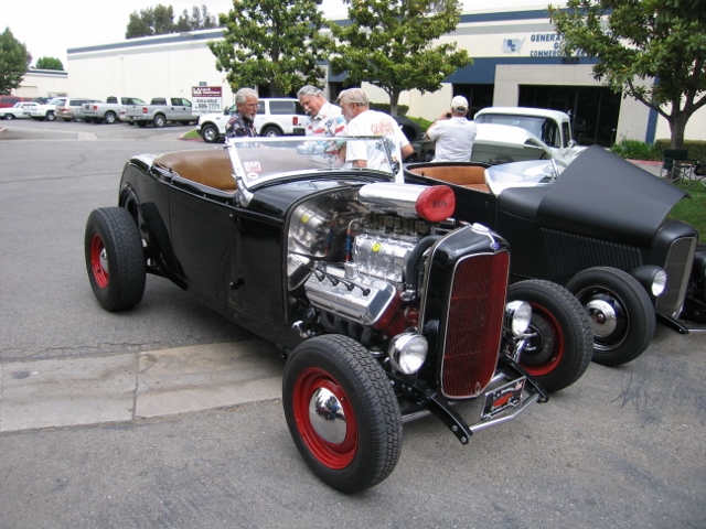

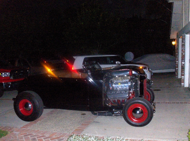

    Oh, you mean this Roadster tucked away in the corner, with the Blown Chrysler Hemi.
    Yes, years after Dennis got his 32 3-window coupe, he picked up his other favorite car of all time, this 32 Roadster, the then stepped to the blown Chrysler Hemi. I can hear this car pull up a block or two away. Everyone knows when Dennis has arrived in this machine.
