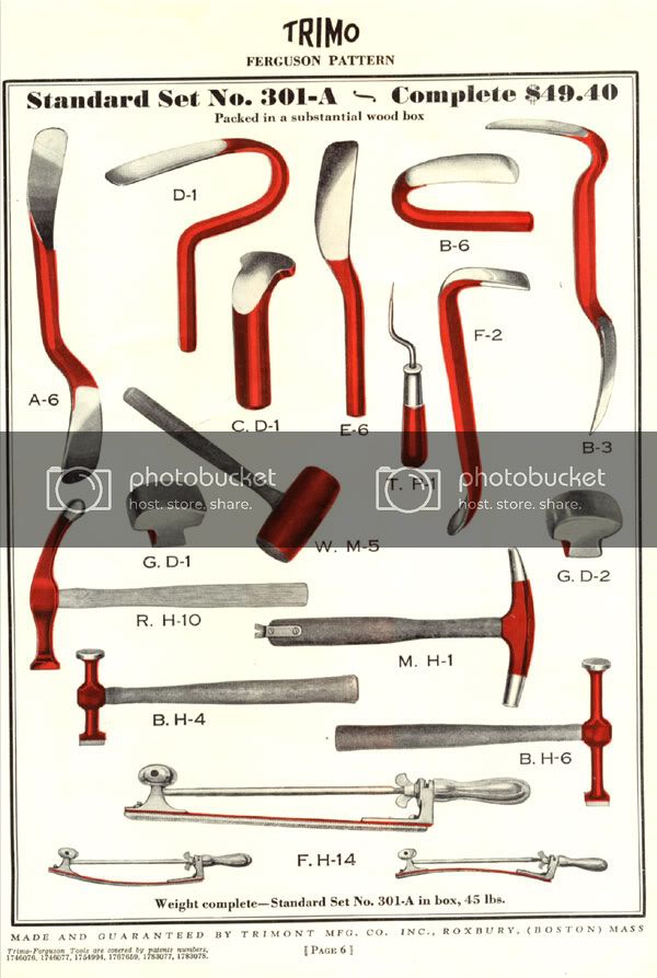

    Try and find a set of s****s like these to lift the lows and knock down the highs like other have said.
    The37Kid, 2Blue2, pitman and 2 others like this.

    I literally just dreamed up versions of D1 and B6. I grabbed a leaf from a Model T spring. We'll try that once it's bent and cleaned up.
    I'm a glutton for punishment but I'd rather mud the whole thing before I take that route. I have an hour and a half into working on it and it's 75% better.
    If I can't get it closer with a s****, a stud welder/puller has to be able to get me there... or a paintless dent removal guy has to have some trick tools.
