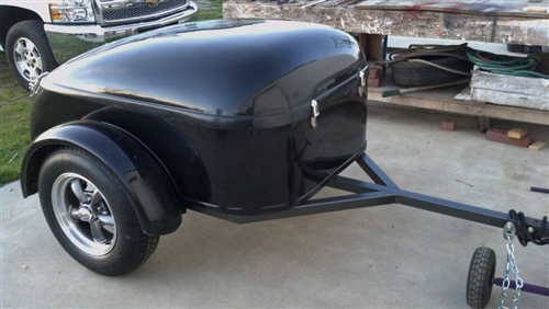

  1. I discovered last night that I have a huge dent in the crowned top of my Mullins luggage trailer that I haven't used in at least 20 years and realized it was caused by a large Styrofoam ice chest full of water,seems I have a leak in the roof of my barn.
    Now any normal dent can be easily remedied but my Mullins trailer is a reproduction fiberglass and the weight of the water made a big dent in the top.
    I tried popping it out with my hand but that didn't do anything except hurt my fist, I didn't even know fiberglass could be misshaped like this.
    Any helpful hints about how to repair the top? we are making plans to use it nextyear when we go to the nationals. HRP

    I removed a dent in roof of my car with a heat gun, have no idea if that will work but may be worth a try.
    I was extremely careful, not letting it get over about 150 degrees. I could touch the area but just a second...

    I have owned a lot of corvettes and I know that glass is in a constant state of motion. You can block the crap out of one prior to paint and have it ripple up a few years later. More than likely that weight on the trailer roof was accompanied by some heat and the combination reformed the fiberglass.
    There was a story on here once about a guy that left the back window up on the nomad and ended up stacking wood on top of the car over the years and the weight and heat actually warped the back glass.
    It can probably be fixed the same way. build a frame inside, jack it up and reheat the glass. It may take multiple tries to get it right. Sucks, those are cool trailers. Your a handy guy, you'll figure it out but stop slugging it.

    I would just try to spread the pressure point from the jack out as evenly as possible to avoid having a small upward dent in your larger downward dent.

    ...or even form a 'buck' out of something like Styrofoam to mimic the finished contour of the roof and use it to jack against. I'd approach it this way while gingerly applying heat and pressure.

    Put the cooler inside Danny and then stack stuff on top until it pushes the lid back up to where it should be when you close the lid.
    Then park it in the hot sun for a few days.
    You can even sneak up on it a little at a time.
    The heat and pressure should do it, once it cools down it should be fine.

  10. Is the inside able to be accessed ?? Could also be a good time for a propane heater. Open the windows to vent excess heat .... but put the heater inside the trailer to make your own Mullins oven.
    I'd use a similar flat shape to top whatever you're then pushing the top dent out with. Floor jack .... piece of lumber cut to fit height aka dead man ... and your flat pusher piece .... with heat through out the trailer done.

    Hi. I wonder about jacking up from inside and covering with an electric blanket? Fiberglass under both pressure & heat does easily take a set.

    A pic of the damage inside and out would help.

    On a serious side, if the lid is removable, could you turn it upside down and fill it with very hot water. The combination of heat and weight might reverse the damage.

    Remove lid and pour sand in lid to slowly press back into shape. If you are not in a hurry I would not get too aggressive.

    I'm with the school of thought of taking it off and pressing down on it. Heat would help, but if you put weight on it and wait long enough it should press down back to it's original shape. How big is the cooler in gallons? Figure roughly 8 lbs per gallon of water, put that much weight with maybe a little more added in. I wouldn't get carried away trying to put too much weight or pressure on it at one time, you run the risk of cracking the fiberglass. Slow and steady is the word.

    I would be very careful about putting a strain on the hinges. Being the material I believe you would probably do more damage. I think I would take the lid off & turn it upside down, make a box & fill with sand ,shape the sand,cover the sand with a tarp & then place the lid in it. then put your weight on it. No guarantee that the dent won't reappear. Ask Karl Wescott what he would do is best .

    Put 20-25 lbs of sand in a pillow case and sow/tape/glue the open end. With the lid upside down lay your sand bag in there. Apply heat to the underside with heat gun/ electric hearer/ keno salamander blowing from a distance just keep an eye on how hot it's getting. Go round and a round giving it light wraps with a large rubber mallet. The sand will help hold and distribute the heat. Good luck.
    Ooooops I forgot. You'll have to support it. I suggest 2 saw horses with a tire on top. Set the dent in the tire.
