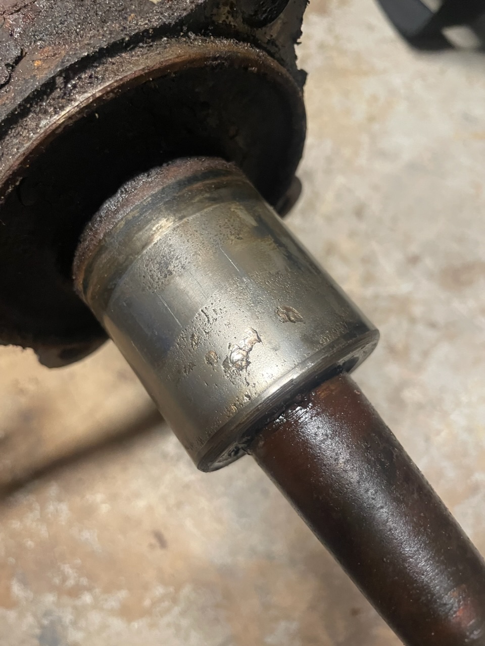

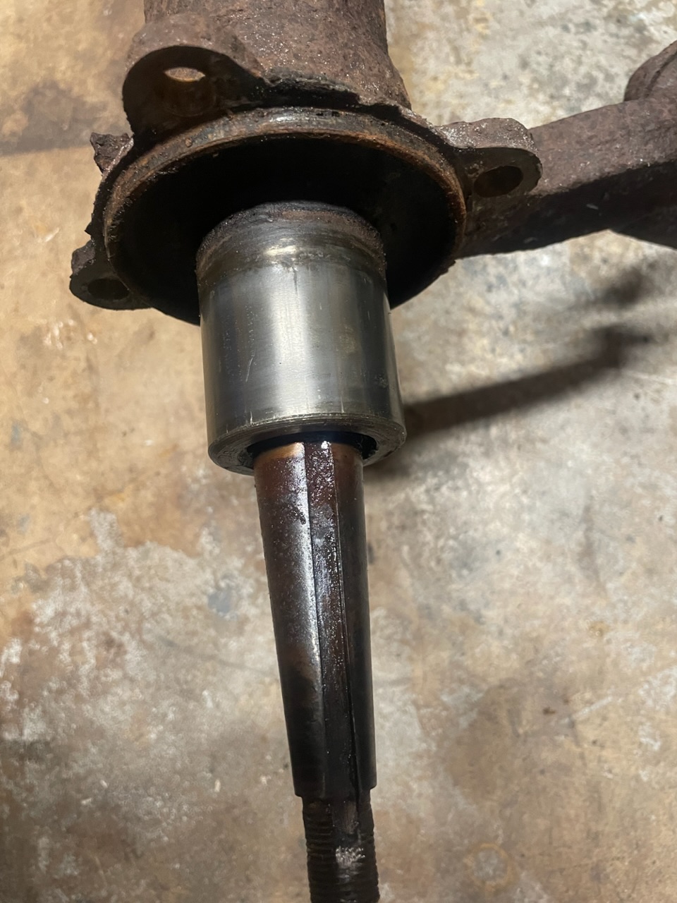

    Got it all apart last night. P***enger side housing looks useable. The top side of the bearing surface on the housing with the dent looked ok (first picture) but the bottom side has some gouges. I don’t think they are sent related as it seems the bottom half of these surfaces typically has more wear since that is where the weight is resting. both axles look good and straight with good key ways and seal surfaces.
    Again, I appreciate the feedback. I will keep looking for another rear as this dented housing will need too much work to be worth it I think.

    That bearing surface needs to be sleeved to be usable. The amount of rust on that thing would make me look for a better one. It would be to your advantage to plan on sleeving those bearing races. The biggest problem with that is finding a machine shop that can, or will, do it. Those races are case hardened. The Hotrod Shop in Idaho is the best at fixing these and usually has a couple in stock already done and ready to ship.
