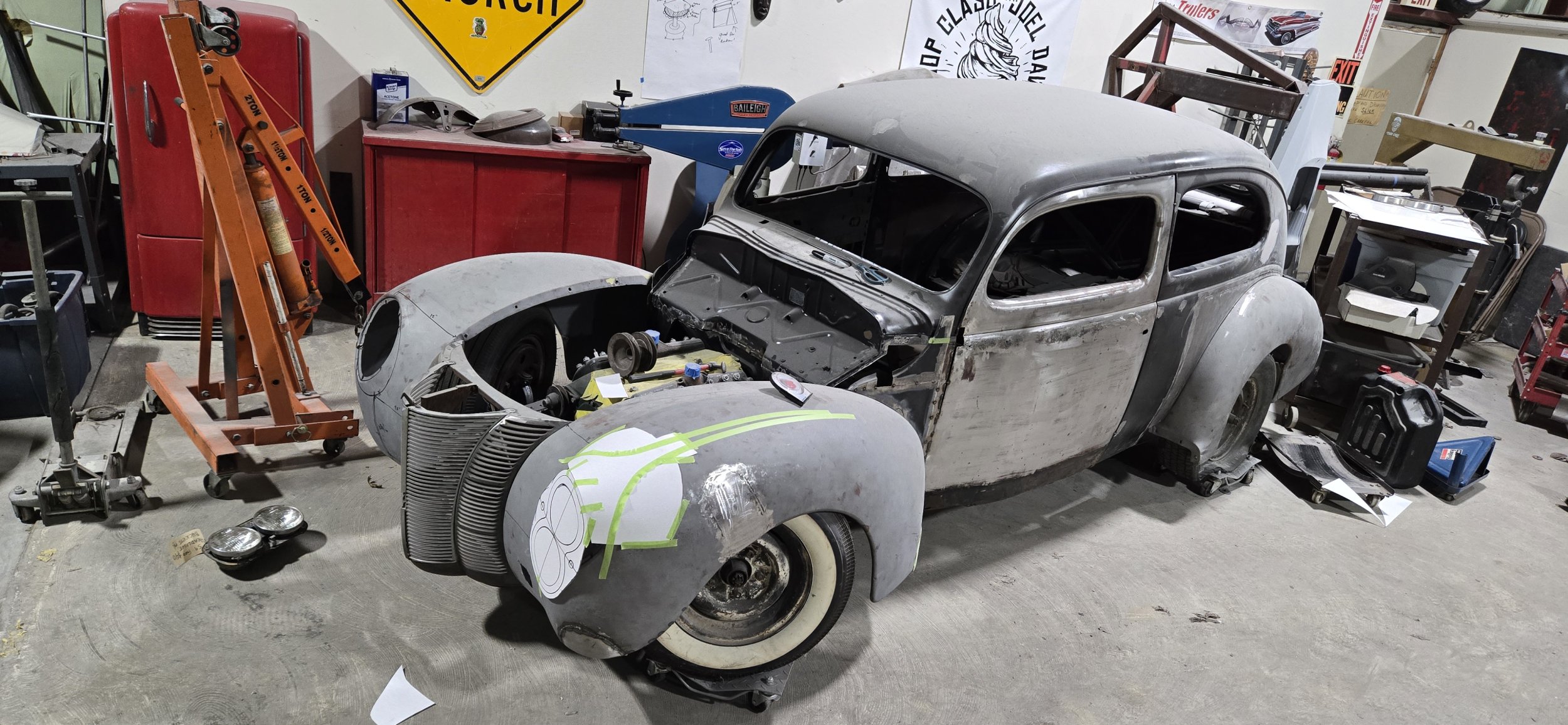

    A couple days' work and it's mocked up with tape and junk I found!
    The '59 Ford headlight buckets were narrowed a tad to fit the '59 Plymouth headlight bezels, which were set in a french-American bucket of my design.
    The whole deal will be snazzed up to the max, and I am working on a vanilla-infused paint formula that will really give a new meaning to "sniffing paint". Have you ever opened the case of a fresh Gibson guitar? The nitrocellulose laqcuer has a distinct Vanilla smell.
    Anyways, it's about that time. I hope you enjoy! 20250510_191908.jpg IMG_20250510_184238_998.jpg IMG_20250510_184239_026.jpg 20250510_114726.jpg 20250509_150318.jpg 20250509_150307.jpg 20250508_211708.jpg 20250508_211602.jpg 20250508_211406.jpg 20250508_211349.jpg

    A lot of very good work, but i am not fan of quad head lights, Just my opinion.
    Pinstriper40 likes this.
  19. Pinstriper40
    Joined: Sep 24, 2007
    Posts: 3,685
    Pinstriper40
    Don't worry, I realize they aren't for everyone, and I will get a lot of people who will think this car is "ugly" when it's done, but it's not their car, it's mine! No hard feelings.

    Cool! Do you have anything planned for the expanded area next to the headlight bezels?

    Pretty sure that is just tape with some primer shot on it now? I was ***uming he might sink them back into the fender some?

    Of course I do! Expanded/textired metal, gold bullets, maybe even some plastic bits.
    That might have happened!
    Front edge of the buckets will get trimmed some still, then 3/8" round rod added around the edge, then metal shaped to that. But yeah, tape for now to get a decent visual.

    Hold onto yer hat! It will get a "little deuce coupe" -esque tail pan cove with a bunch of tricks in it after the headlights are done.

    Could even do a fogged plexi cover with some gold bullets over the light centers

    Really digging the proportions of the channel. Well done.
    This shot right here makes me want you to run hoodless with 3 2s hanging in the breeze.

    I have a '57 caddy engine with an edelbrock 4x2 setup...
