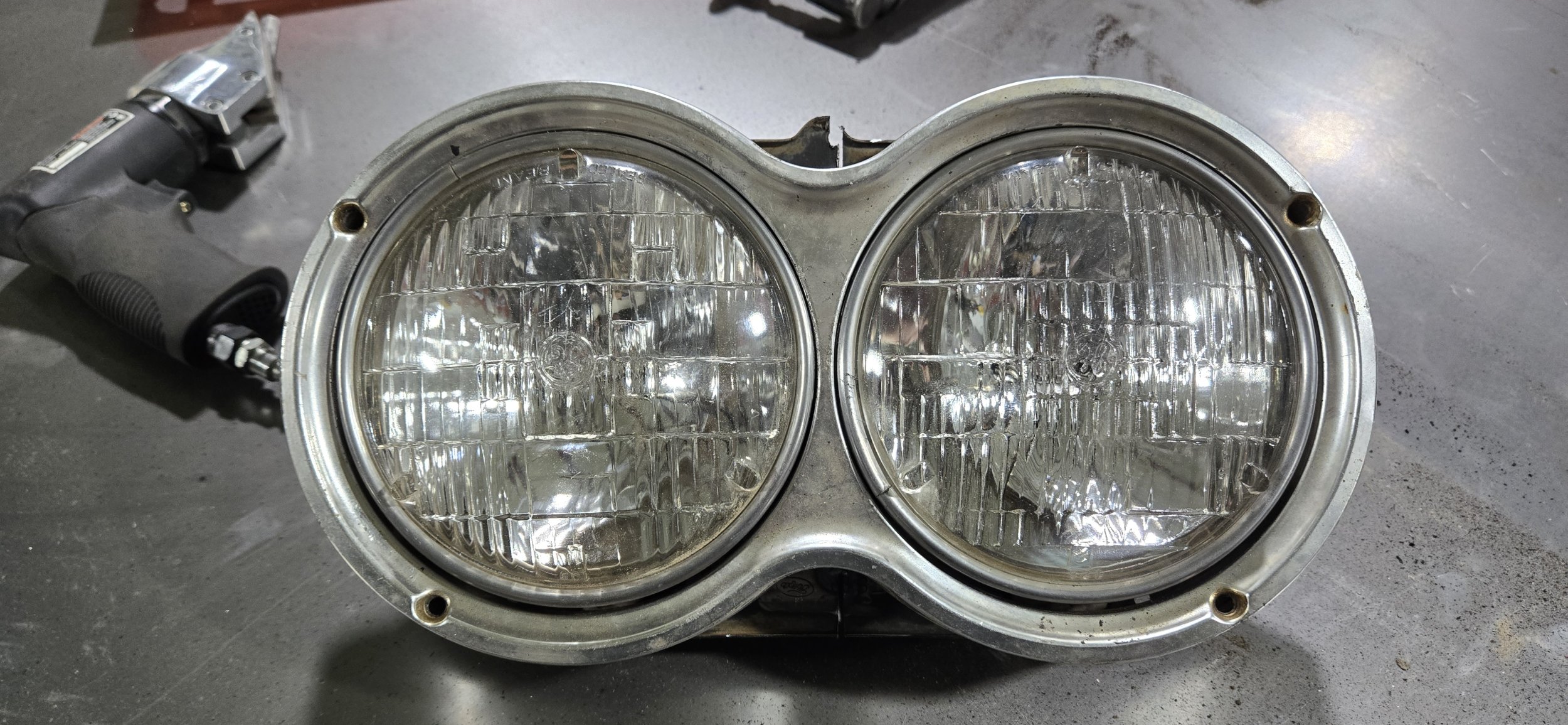

  2. My kind of custom! One question though... Is this a daylight-only car, or do you plan to drive it at night? If you plan to be out after dark, you'll want to rotate the lamps/buckets so the lettering is parallel to the road. If you don't, you'll be lighting everything except the road and ******* off the poor SOB coming at you with glare...

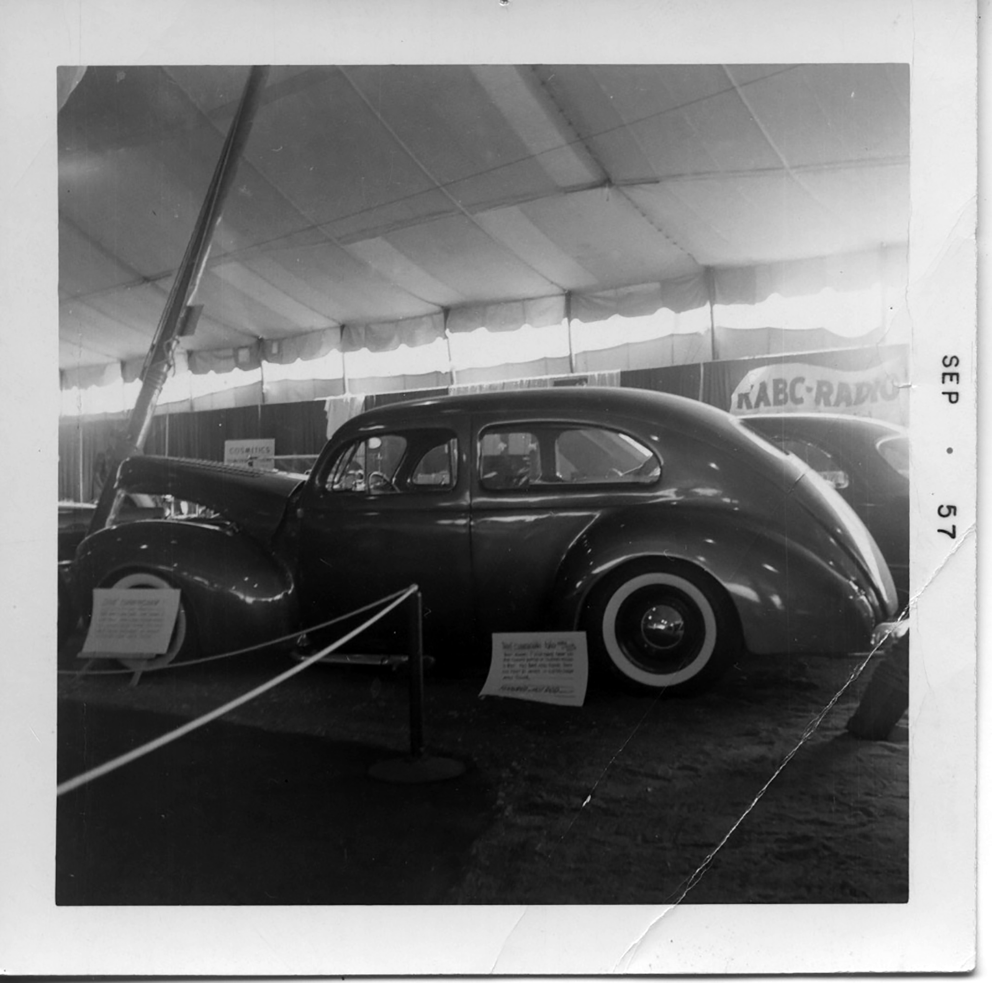

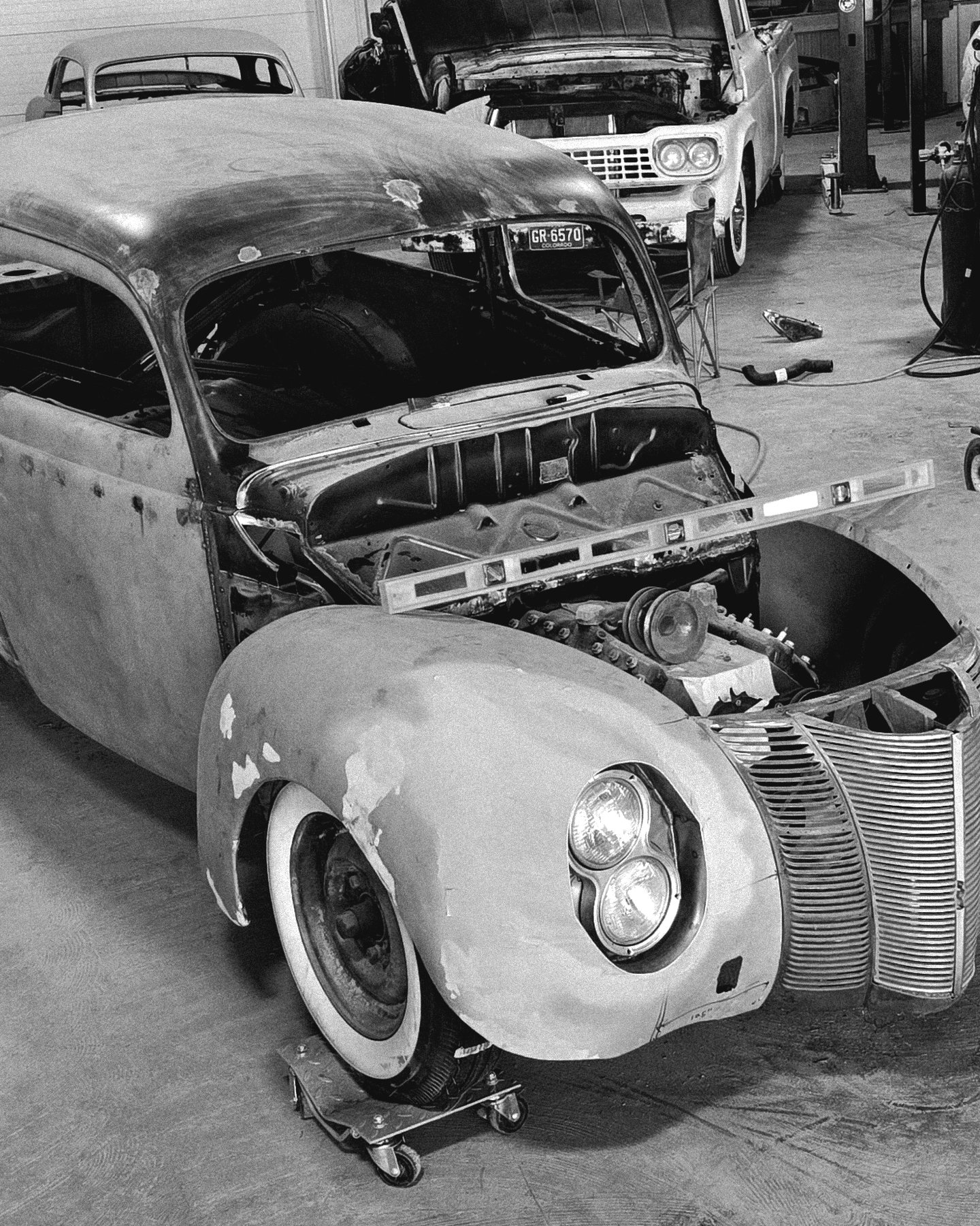

    This must be the Cunningham car? Pre fender coves?
  4. Pinstriper40
    Joined: Sep 24, 2007
    Posts: 3,685
    Pinstriper40
    I will be spending a fair amount of time adjusting headlights when it is running and driving. Can't be much worse than these new LED headlights! I know my 2015 cadillac gets flashed quite often for having "brights" on when the low beams are on. But generally this will be a daylight car. I don't like driving at night in an old car unless I am in town.
    Sure looks like it! I never liked how the rear fender height interrupts/ muddies the bodyline back there.

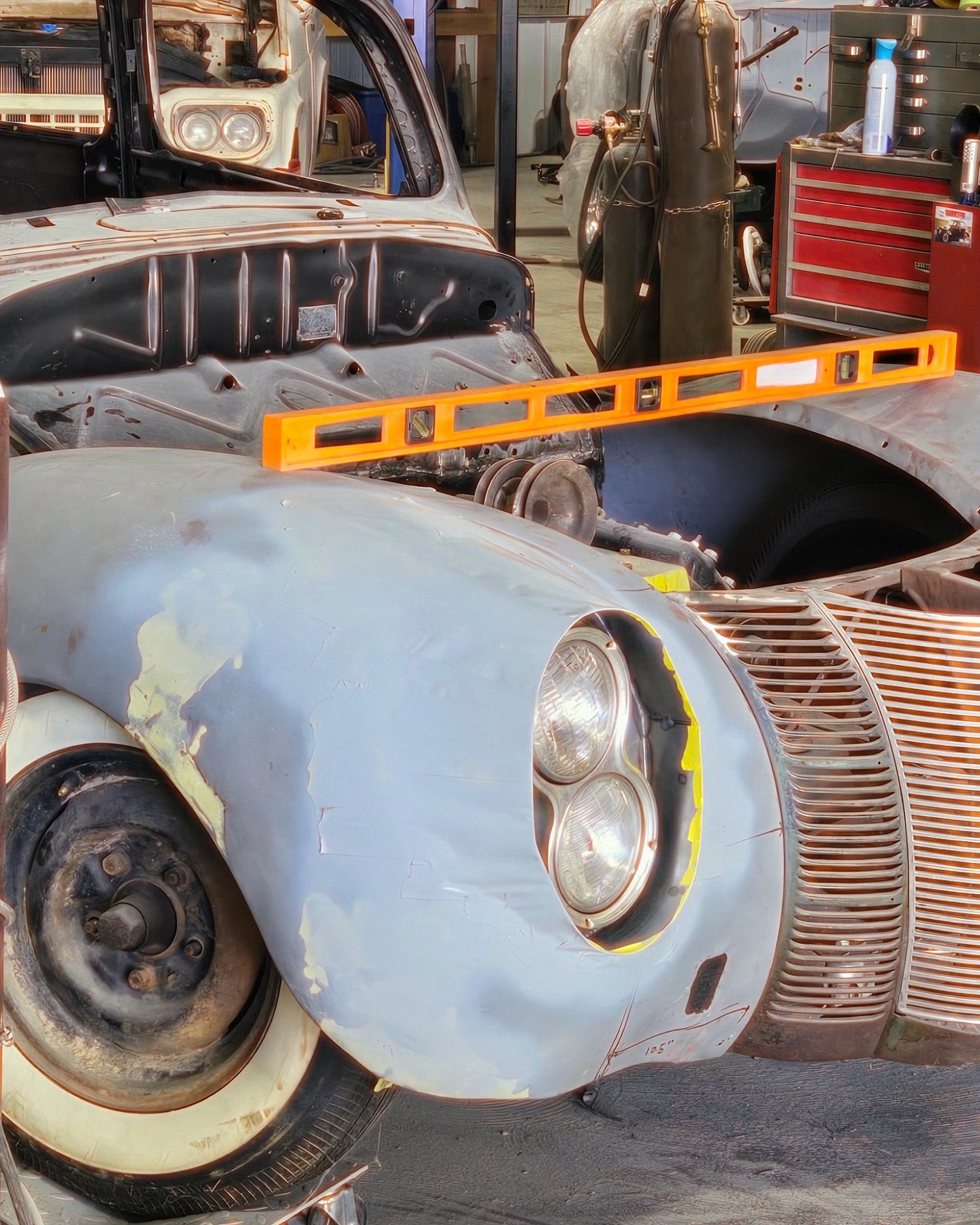

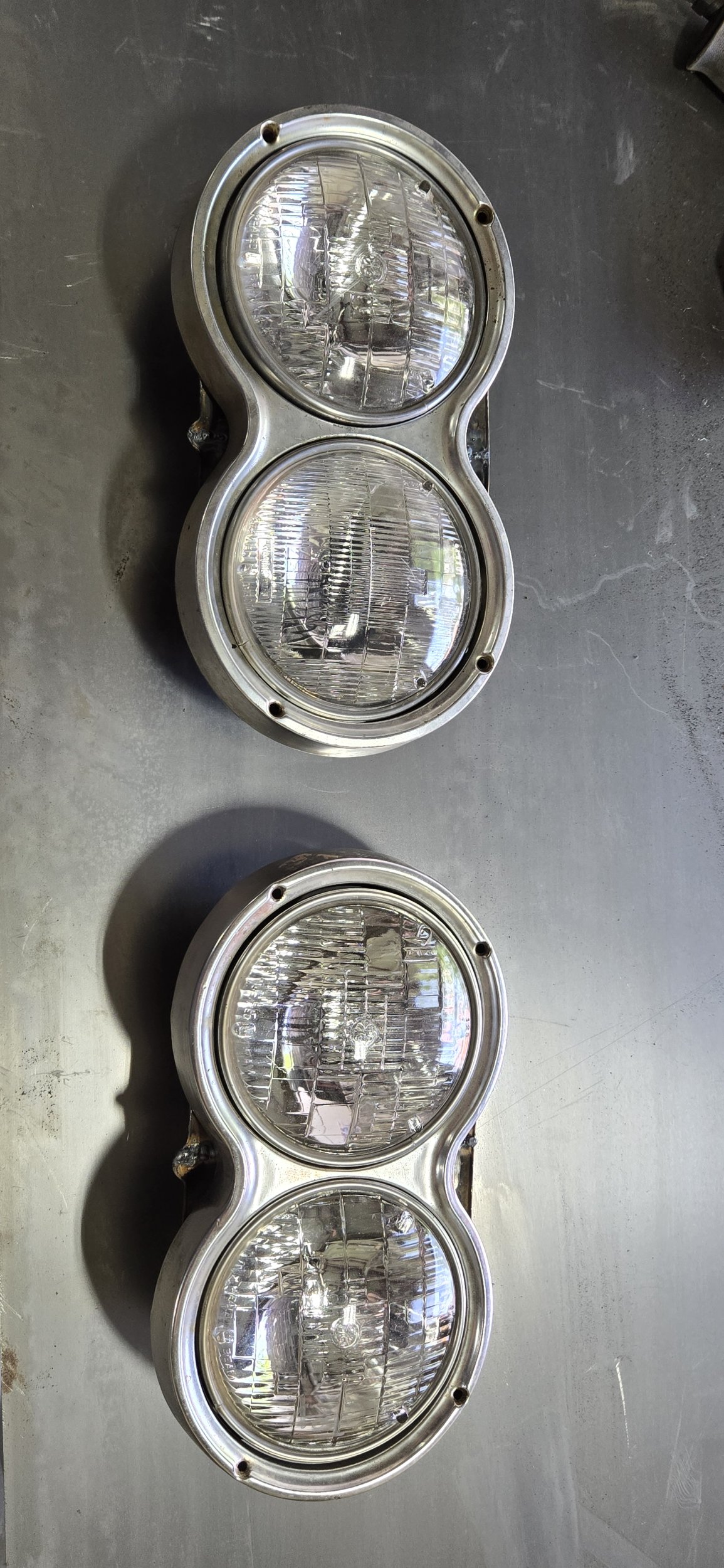

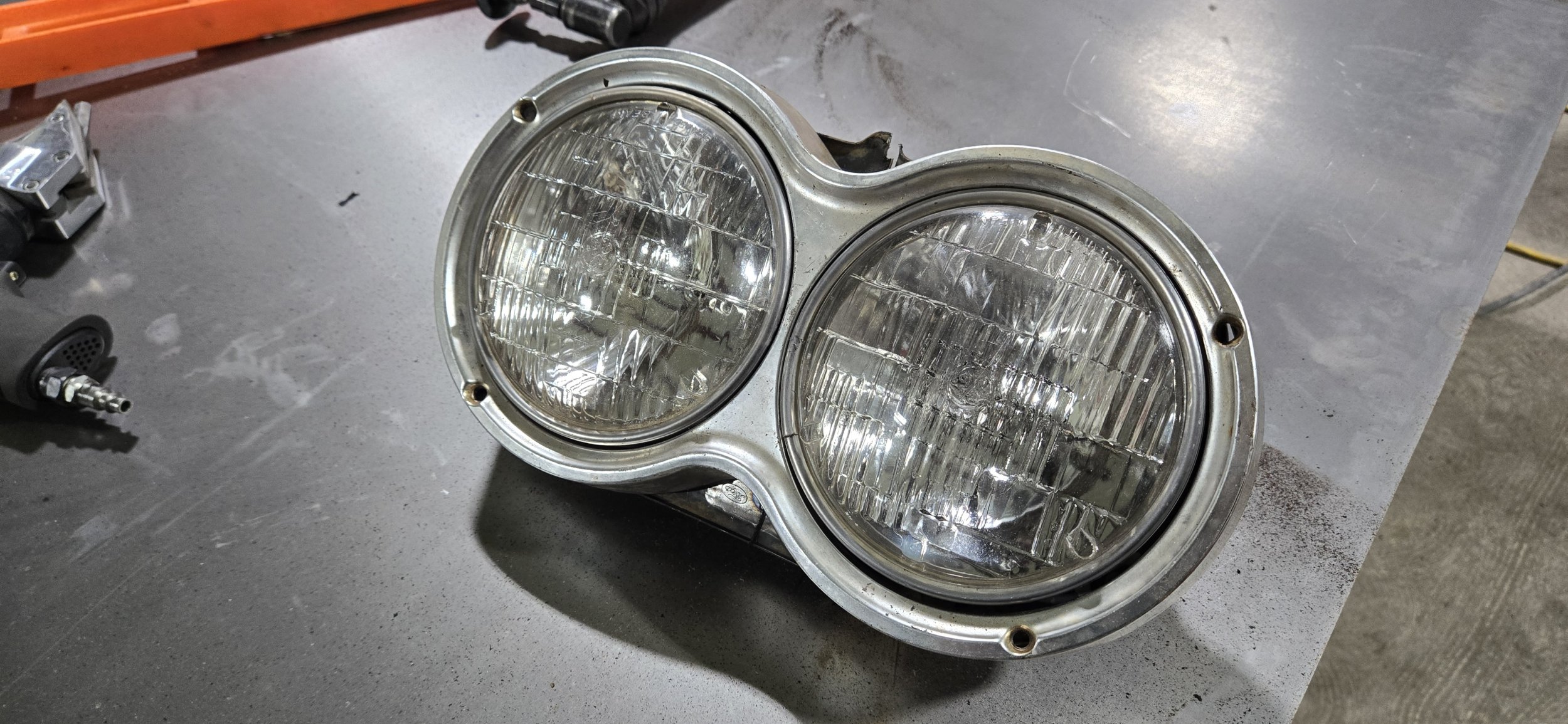

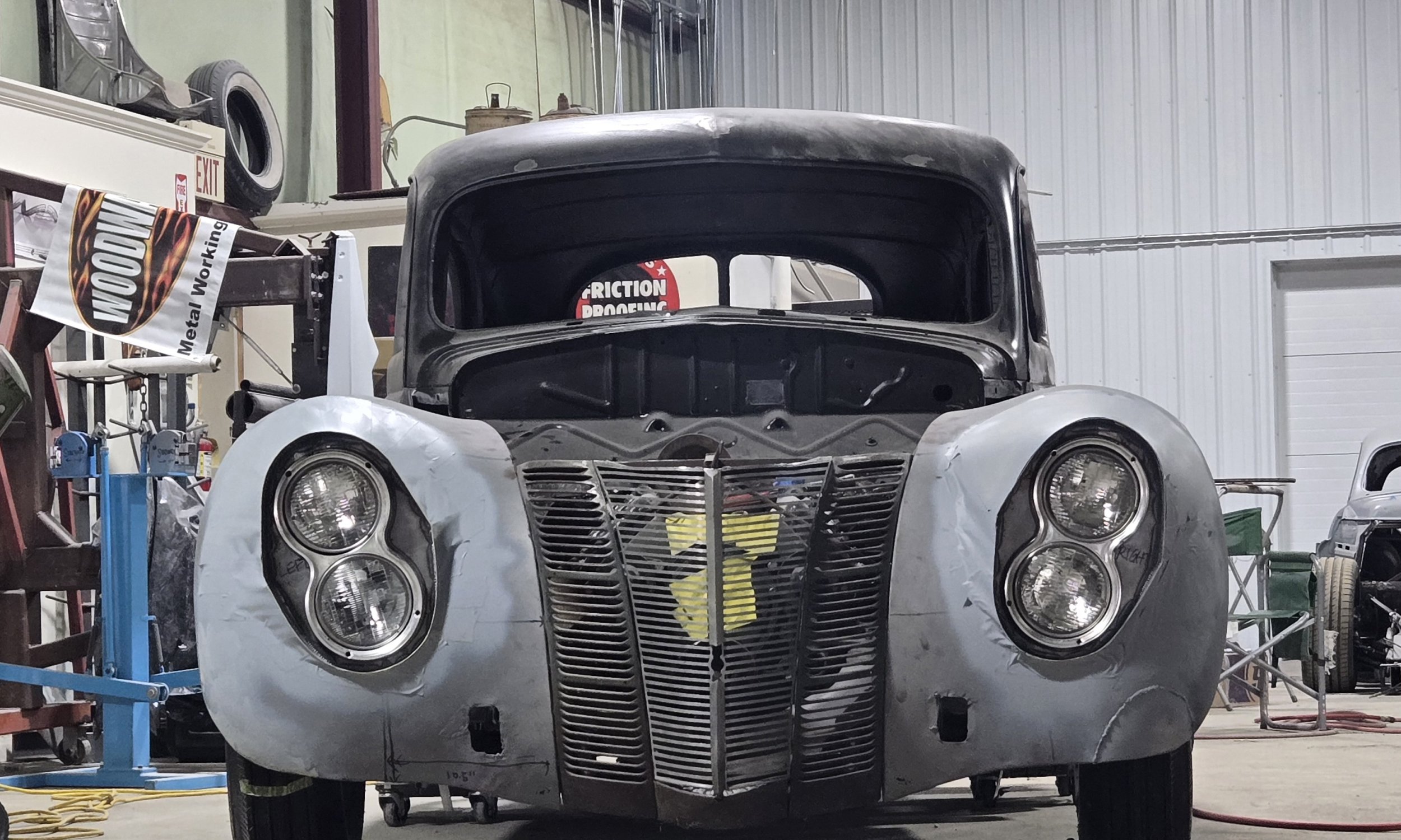

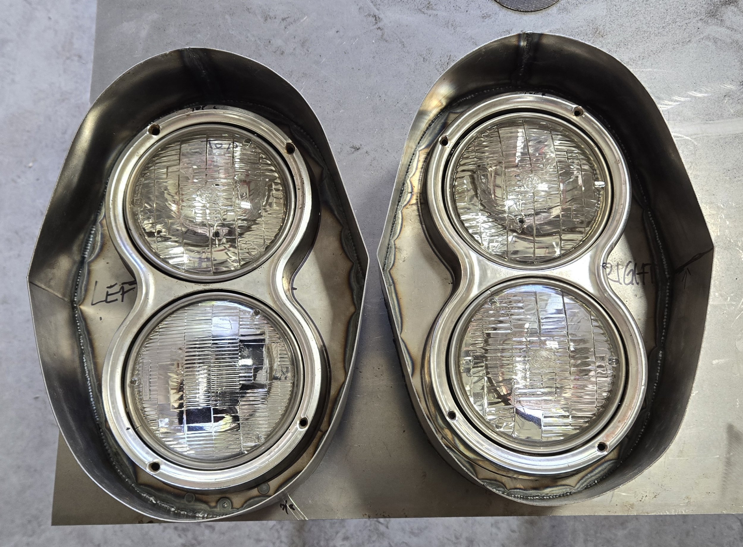

    It's kinda coming together now...
    20250816_031725.jpg 20250816_035759.jpg 20250816_035808.jpg 20250816_051742.jpg 20250816_051752.jpg 20250817_022401.jpg
    If you're like me, you spend a fair amount of time walking circles around your car. If you're REALLY like me, you can "see" in your mind's eye (I call it hallucinating) whatever stance, modification, color, interior design, wheel and tire combo, or any other design aspect you might be thinking of.
    It's a shame I don't practice drawing, because there are hundreds of custom ideas in my head. I can see it and sculpt it in metal much easier than drawing it with good proportion.
    Anyways, headlights.
    Stogy, 1pickup, adam401 and 20 others like this.

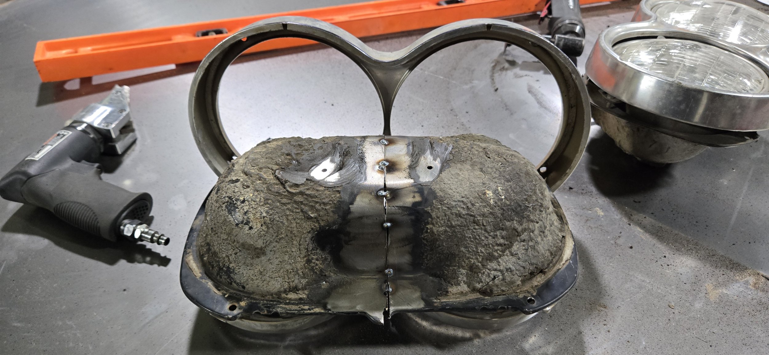

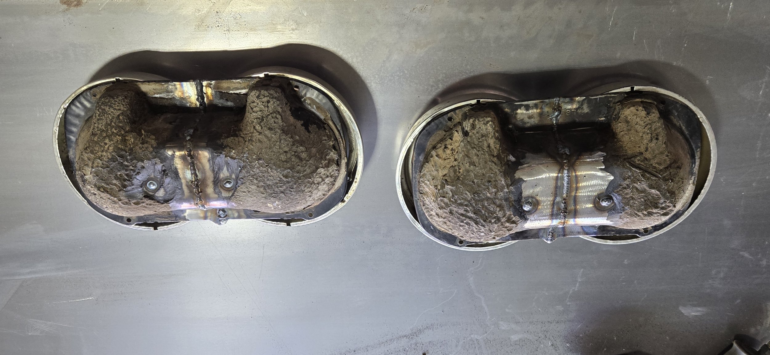

    Bottoms of the headlights are about done, using a deep jaw shrinker stretcher and a pipe anvil. The fenders need to be radiused for tire clearance eventually, so that's what that line is for.

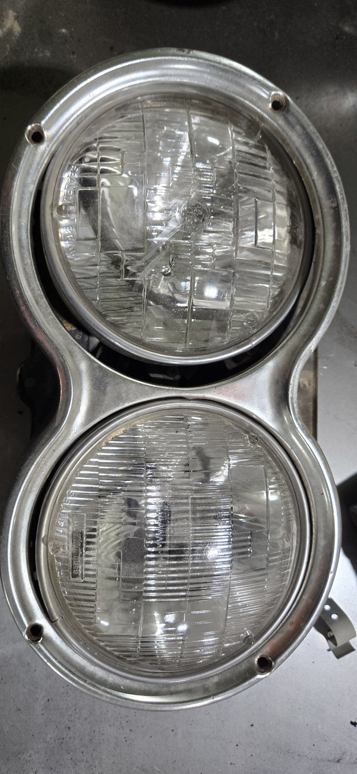

    As I stated before, the headlights will have some other tricks going on, like gold textured metal, white pearloid inlays, and these gold bullets. 20250824_144606.jpg 20250824_144547.jpg 20250824_144527.jpg
