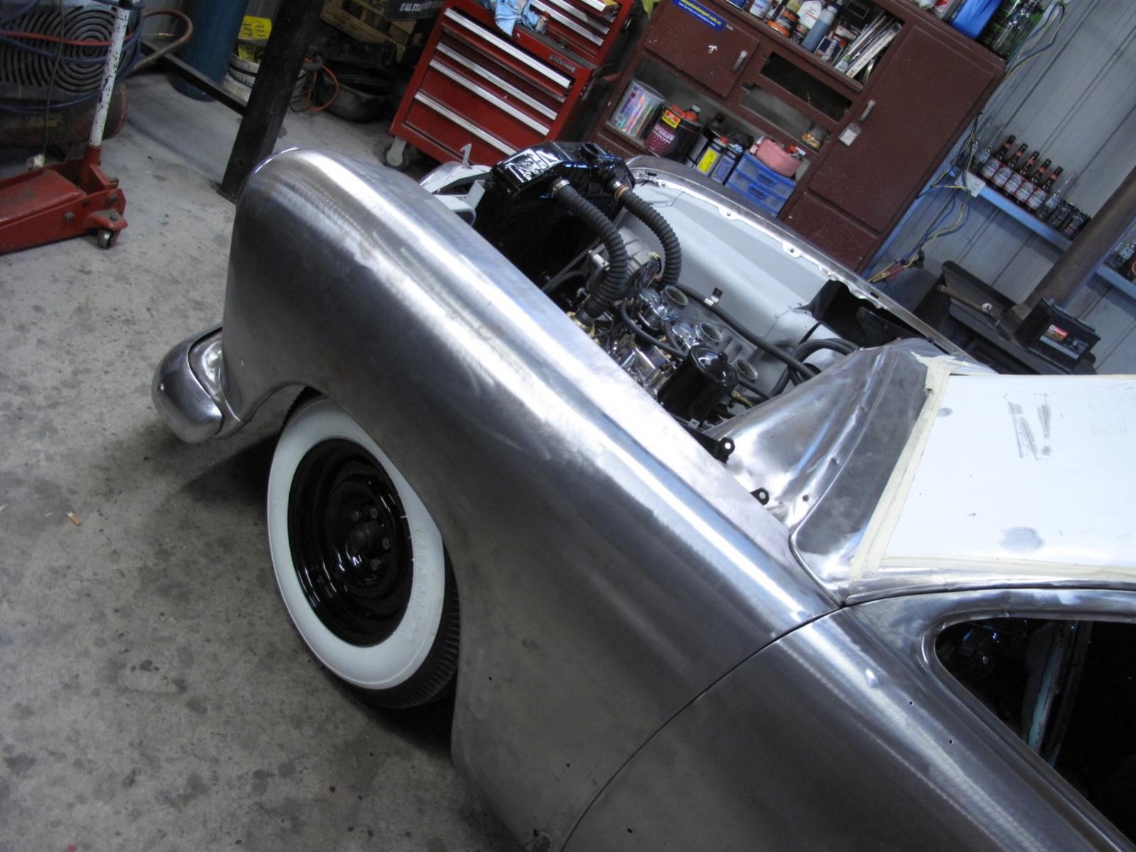

  5. Gl*** gettin done today. Rubber but down with new gl***. This is gunna cost alot I think.
  6. Gl*** was put in yesterday. Theydid a really good job and was pleased to
    come home from work yesterday and see it. Nothin like brand new gl***.

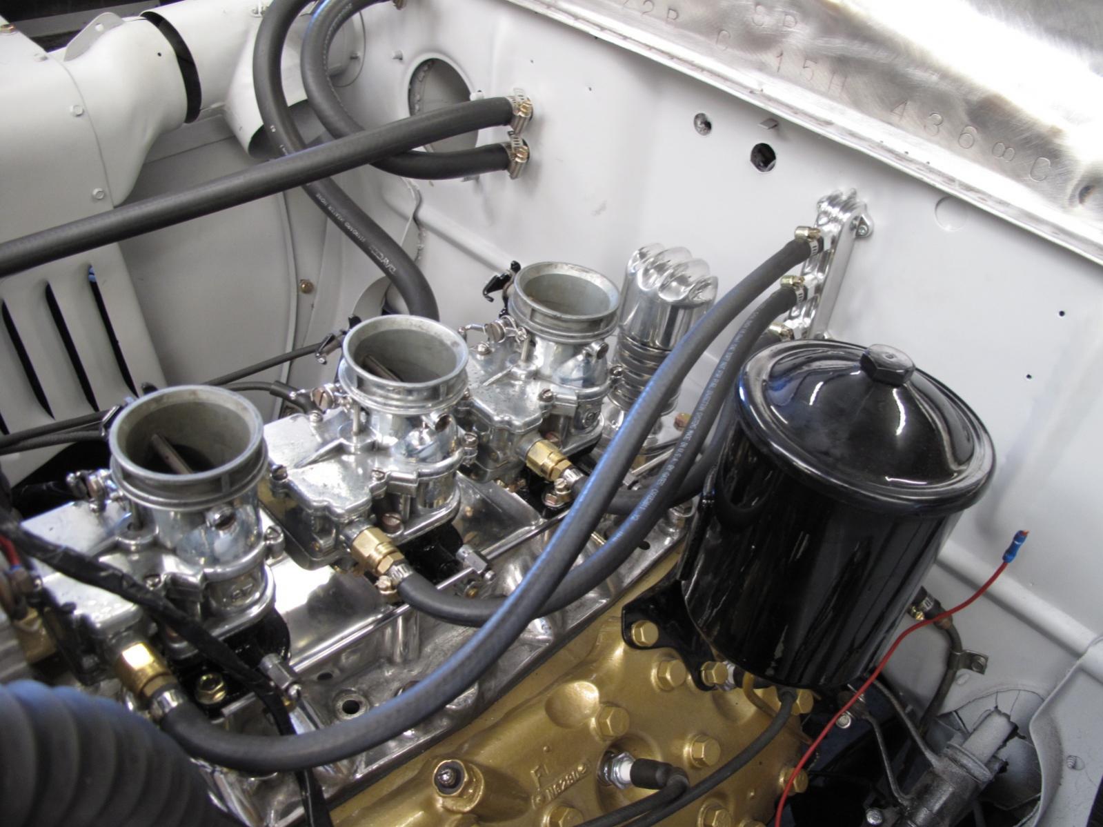

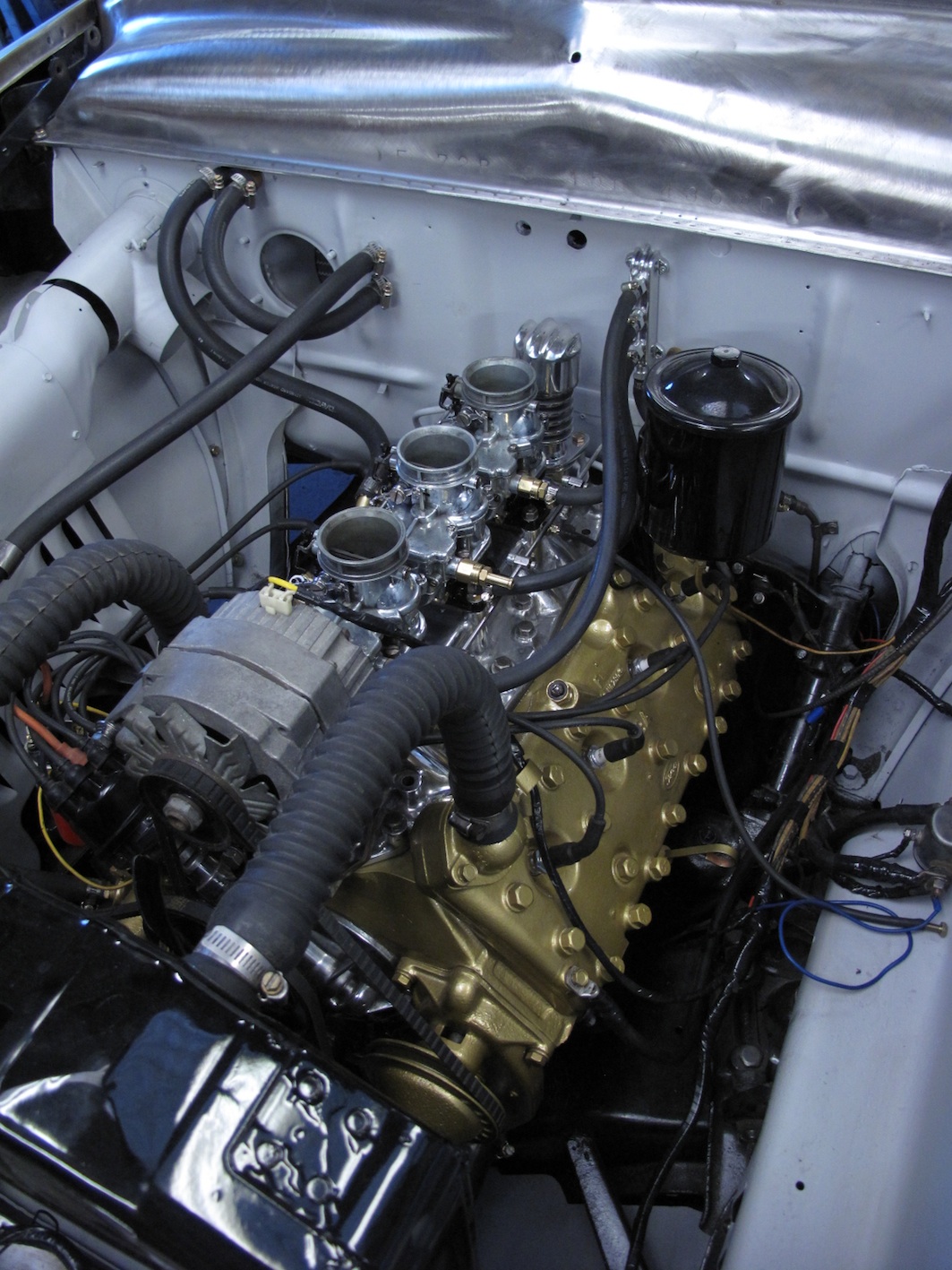

    Intake manifold is on and all carbies with new jets and all linkages hooked up.
    Fan belts, alternator, fan, harmonic balancer, oil filter,
    oil in engine and gearbox.
    Had to put a couple ends on the drivers side exhaust header and then cut and weld on some flanges onto the exhaust system. All painted and headers on. Just bolt up the exhaust pipes tonight,
    radiator gettin some gloss black tonight,
    just need to mount fuel block and run hose and fittings. Run battery cable from boot ad crimp/solder on some lugs and put my new brushes in the starter and paint that and I should have it running by the weekend which would be ****in great.
    My buddy Paul Librio from Eldorados came over last night and wearied and cut the front screen stainless to size and have it all set up not for him to tig weld back together then I can grind file sand and polish tem up. It looks so
    much Better with the stainless in it.
    I'll do pics after the weekend for now I will be flat out.
    130am last night and I'll probably do te sane tonight.

  9. thanks for all the great comments fellas,
    well, the ****er runs, and well.
    got it all hooked up the other night, put some oil, water, fuel all the jazz in it, had a couple issues of course in the way of the a rebuilt starter playing games, but to de honest me and mitch put the new brushes in the wrong spot, thinking that the positive and negetive brushes were both insulated in the base, so when i went to turn it over it made a funny noise then smoked a whole lot, after a bit of messin around and changed the brushes over to the right spot i realised that the springs that hold the brushes in had lost all there strength due to gettin hot so the next morning went in tp castlemine and found some exactly the same that were strong as, went home put them in and she turns real nice now, alsodizzy being 180 degrees out, easy fix, then had some kind of fuel blockage in the fuel line bewteen the electric pump and the fuel block, but a bit of air down there from the compressor hooked everything back up primed the carbies up and checked for leaks, then turned it over, ran and idled like a dream, moved the dizzy a bit and she is awesome, gott get a new thermostat housing cause its leaking but once i get that tomorrow i will be settin the timing with the vac advance hooked up and play around with the idle screws, the exhaust is gunna need a couple muffler which im ordering tomorrow and it should only require clutch and gearbox linkage adjustments and ill be dirt draggin with the best of them,

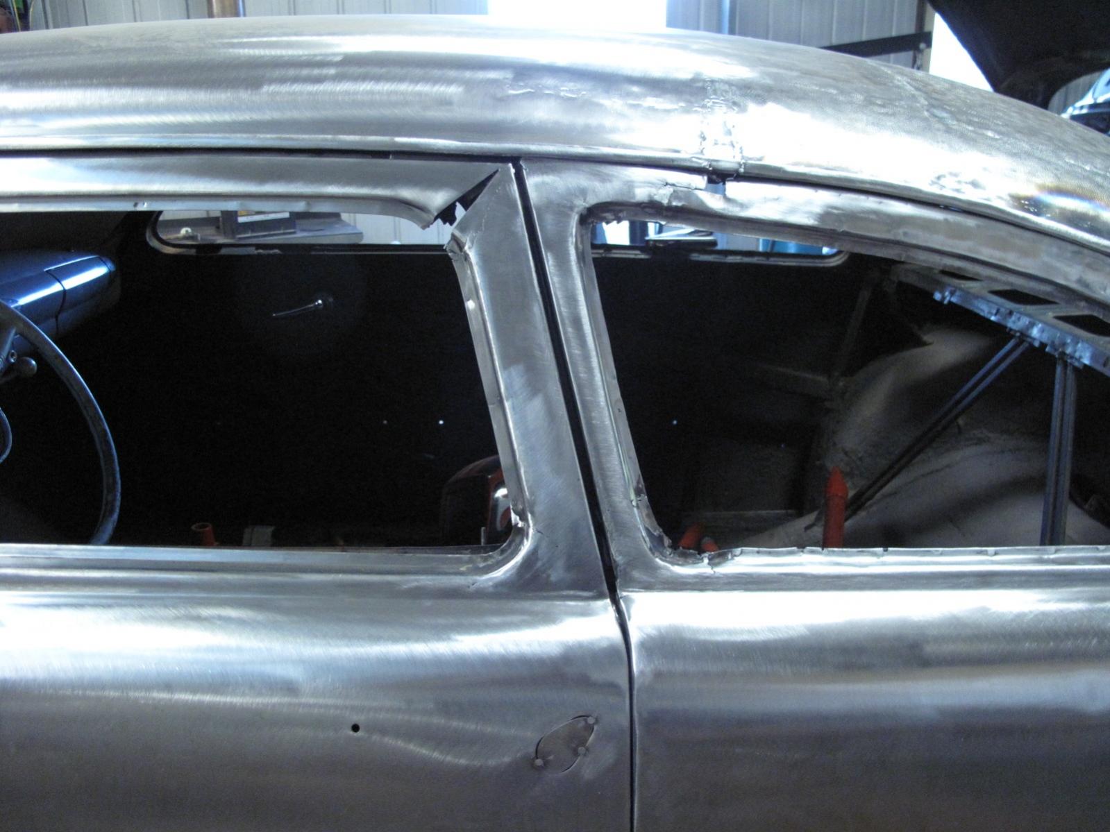

    more welding cuttin and panel beatin on the roof areas, ahron has been just beatin the roof a little and its coming up real nice while i have been doin all the door frames and b pillar inner and outers, its really gettin there now, after sat i would say its goin to be pretty close to finished,

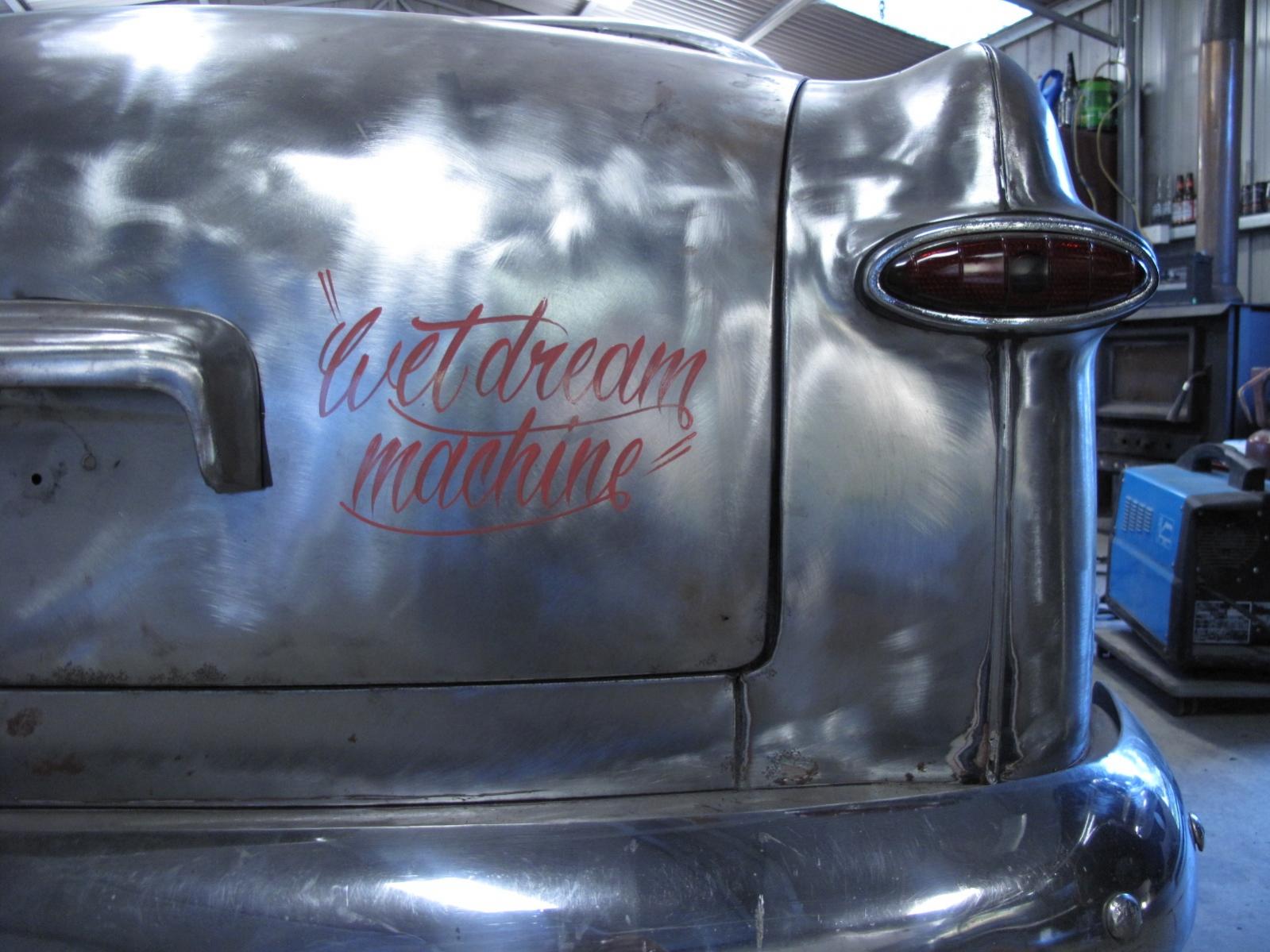

  10. thats what happens when ur mates with ryan ford and u let him go to ur house while ur at work, he sign writes ur boot lid, wait till he attacks chickens olds soon.
