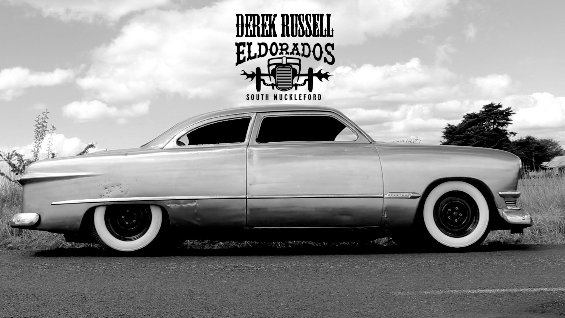

    and just a couple shots of its stance at the moment, looking good i think but still alittle to go,
    amazing how much the change of the look of the chop and the car is given once its slammed...............
  10. just a little before (friday) and after (sat) aloow for another 2 inches to cover the rim and maybe even a further 2 inches once and if we do a wheel arch drop
    the before was axle sittin on the bump stops too.
