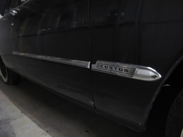

  3. indicators are all working and polished a bit more chrome and **** for now, will have to continue tonight wet rubbing boot lid and stuff to match the rest of the car now. will put up some more pics when i do some more progress.

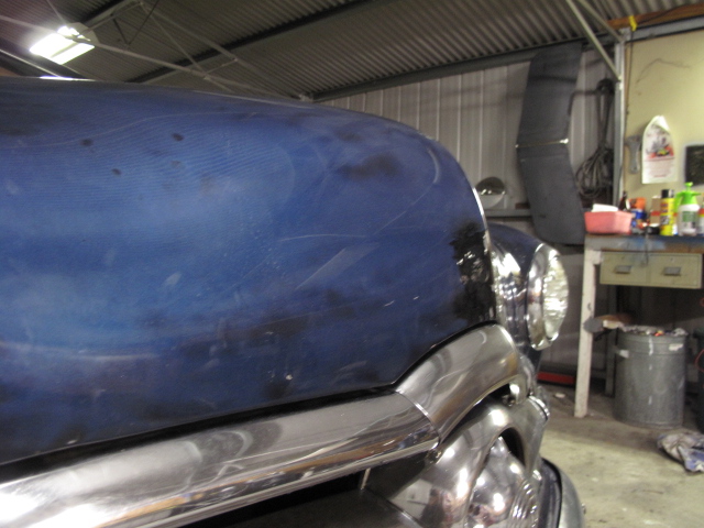

  10. made the bonnet match the rest of the car now, only problem it lost all shine after a couple days, looks kinda cool now though its all gone a patchy satin look,

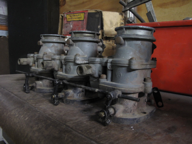

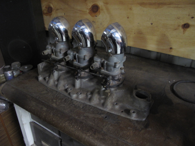

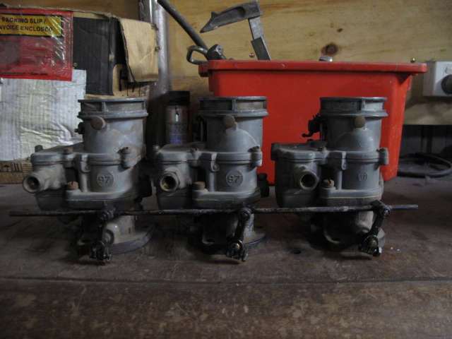

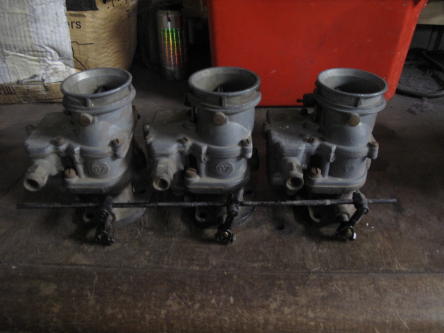

  11. while the bonnet was off i decided to clean up the engine bay a bit and shine up the cowl panel, it came up really really nice wish the whole car looked like this, also my triple 97's rocked up in the post, going to rebuild them soon and make them look new, i think im going to jet them down so that i can possibly run all three at once cause i really like the linkage that came with them, there going on an old fenton intake that my buddy Ryan Ford of kustom linez was nice enough to part with, that will be fully polished.
    has anyone jetted these down, i have read a bit about jet sizes on here, just curious what size works well, for all i know this is a rebuilt stocker and 3 carbs is way over carb'd for this. but i want the look and sound of triples.

    As for the carbs, three on a stock flatty is overkill. If anything I'd block the centre carb off (rebuild it though and keep it as a manifold mounted spare in case of emergencies :D ). I've got twin 94's on my stock flatty running 42 sized jets with 3.5 power valves from memory and they aren't too bad. Not quite sure on 97's if they'd be similar setup wise though nver had any to tinker with.

    yeah the carbs are a bit of overkill, i have thought about other options like progressive linkage, running just the two outers, i will deffinately rebuild all 3 but i will have to read up quite a bit and see what people have done running triples jet wise,
    it runs so nicely now, i tunes it all up and its great i really dont wanna ruin a nice running engine buy over carbing it but i really also want them on there they look too good all sitting on the manifold.
    what size thickness plate did u use and did u space the other two up as well so they all equal the same height or is it that thin that you cant notice it.
    cheers
    des
  17. I've only got a twin carb manifold. But a flat piece of panel steel with gaskests either side would probably be enough to block the centre carb off. So long as it seals alls good.
    I had your dilemma, mine ran a single carb for years and it was brilliant. Finally bit the bullet and put it all on, should have done it along time ago. Do some research and see what others have run set up wise. Well worth the effort.

  20. hey mate, thanks, yeah i was thinking just cutting some panel steel exactly like u said and would still be fine with the other two running, i will probably still run a fuel line to it so its not obviously a dummy.
    should look good but its going to be a fair amount of work to get this all polished up but i wanna do it so looks like ill be sitting out in the shed by the fire and sanding and polishing for a few long nights.

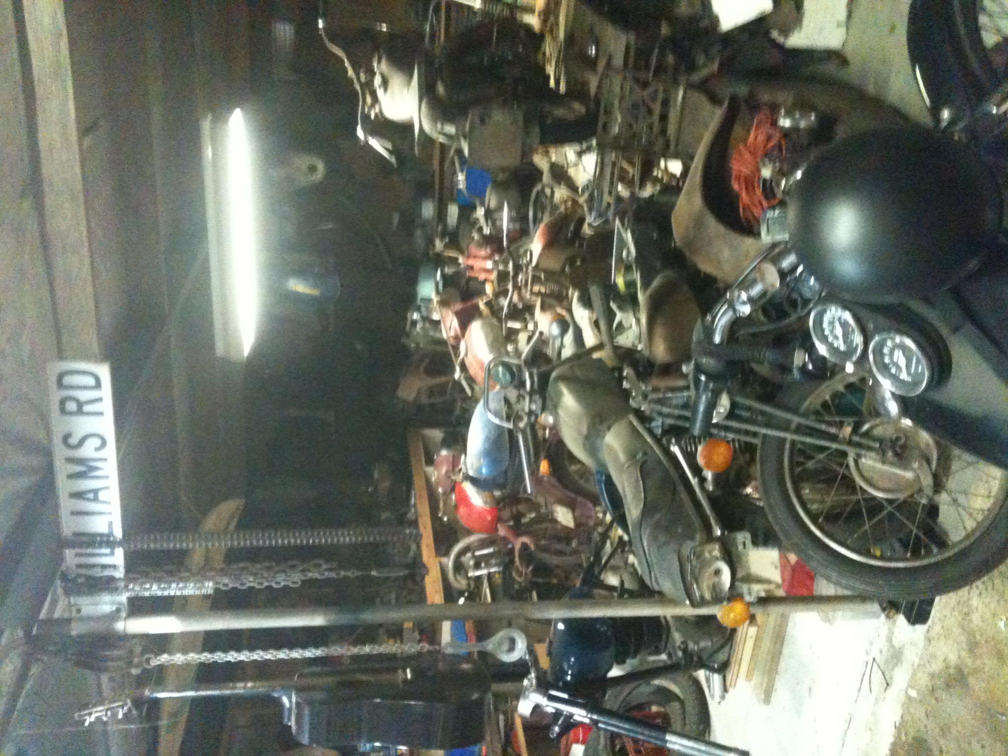

  23. set the points gap and timing, tuned the carb a bit better, bonnet back on and went to chicken williams shed for a beer, chicken and his old man are right into old bikes, they both own harleys, chickens is a 60's sportster and is building a honda 4 chopper, pretty cool, whicle he waits for his 53 olds to come from the states.
    just thought id show you ow many bikes there jamming into there little shed, as we had a beer by there fire listening to chain on vinyl, they discussed the options for there new shed and the size and im thinking, yeah good idea, chicken is going to have a big long *** olds and there aint a hope of even getting on fender off to fit in the shed.

  25. heres my new manifold and carbs, only really learning alot abut flatheads now so not sure what happens with your draft tube and oil filler tube, but man it looks cool, if this manifold will work ill have to polish it all and rebuild the carbs. so cool.

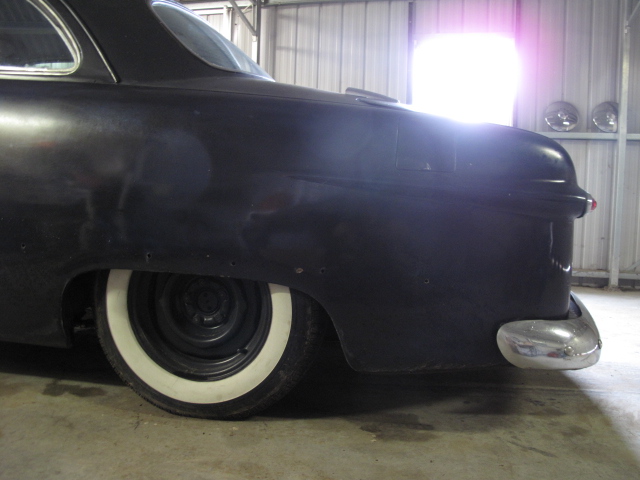

  26. well i got the spinner registered this morning, a little bit of trouble with the douche bags at vic roads, deciding they were gunna play captain road worthy instead of just putting the numbers into the computer, taking my money and giving me pates, but after a short trip to bursons and put in a dodgy $3 battery clamp, they gave me the plates and i went straight down to the post office were my lowering blocks were just sitting waiting to jump in.
    this is temperary till i possibly bag it one day, i say that now but i'll probably just drive the thing and not do them.
    the backs down ran outta time to do the front that will happen tomorrow morning,and im off to the states in 6 weeks so i think ill just grab the drop spindles when im there and throw them in my bag, along with some other cool ****.
    heres some before and after shots, i really like tail draggin sleds so it will always have a bit of reverse rake.
