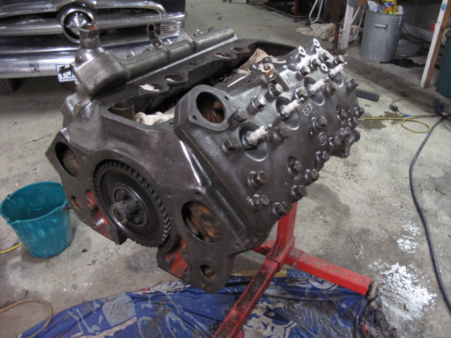

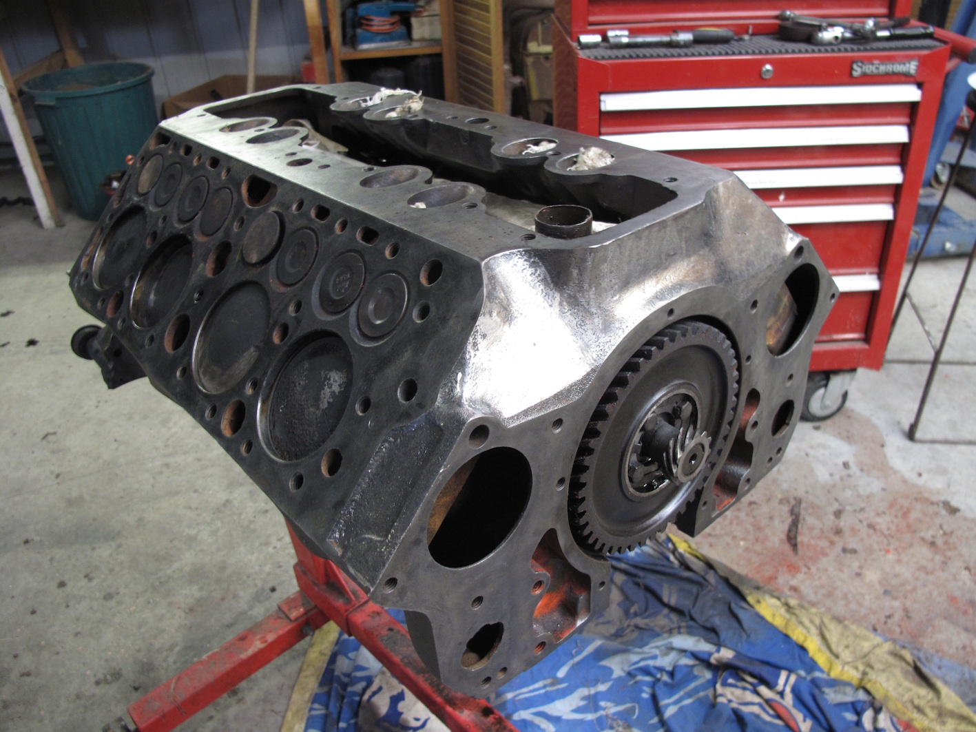

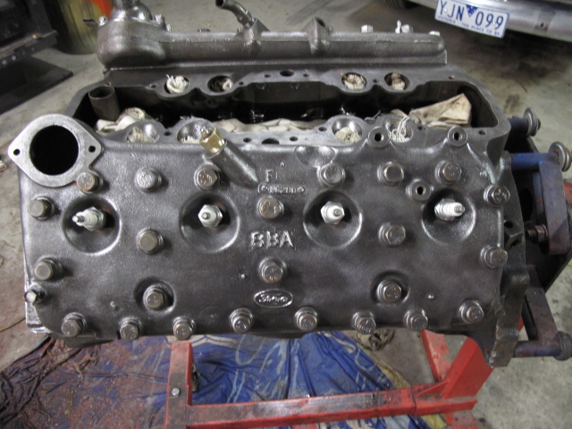

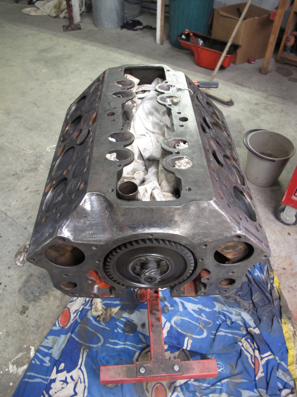

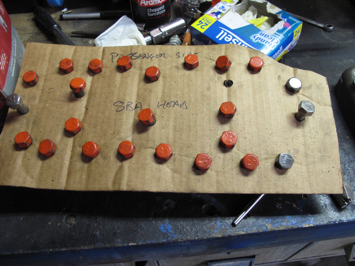

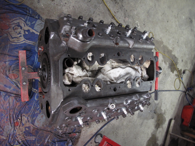

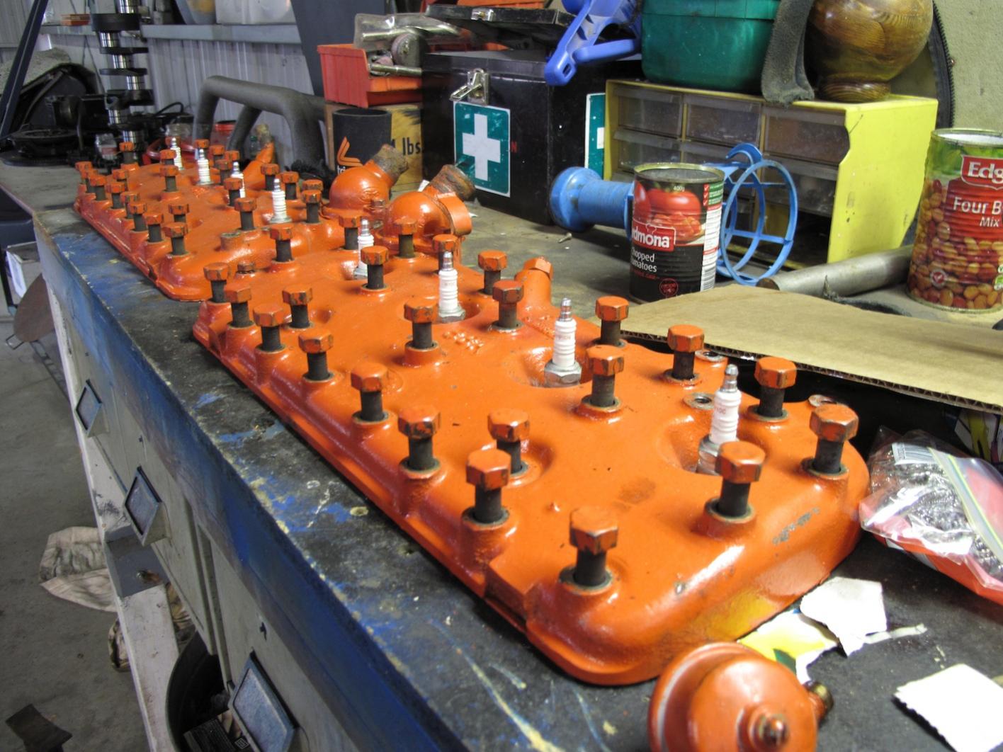

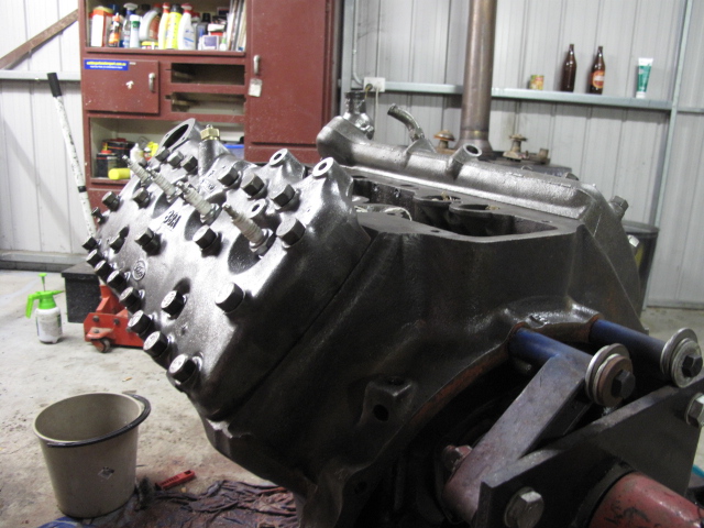

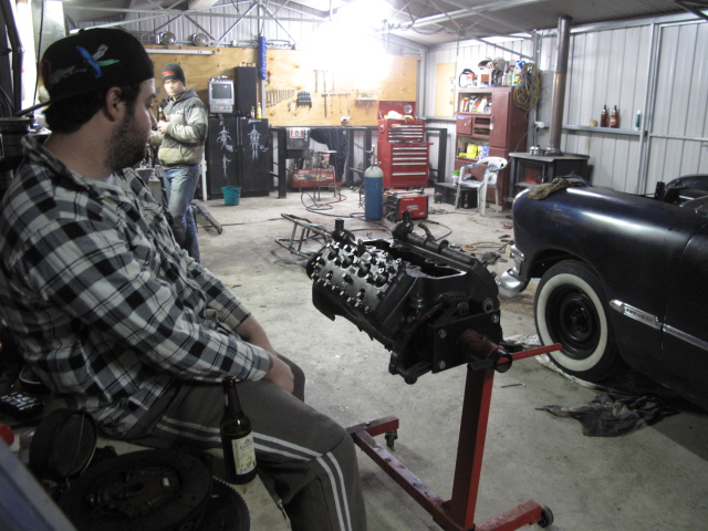

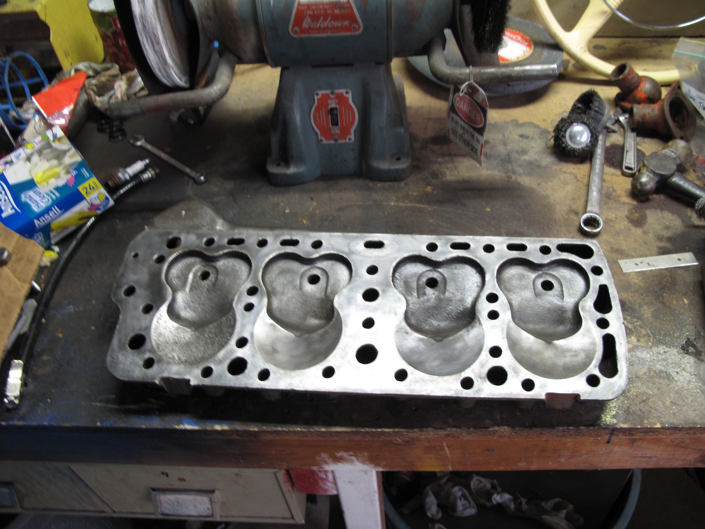

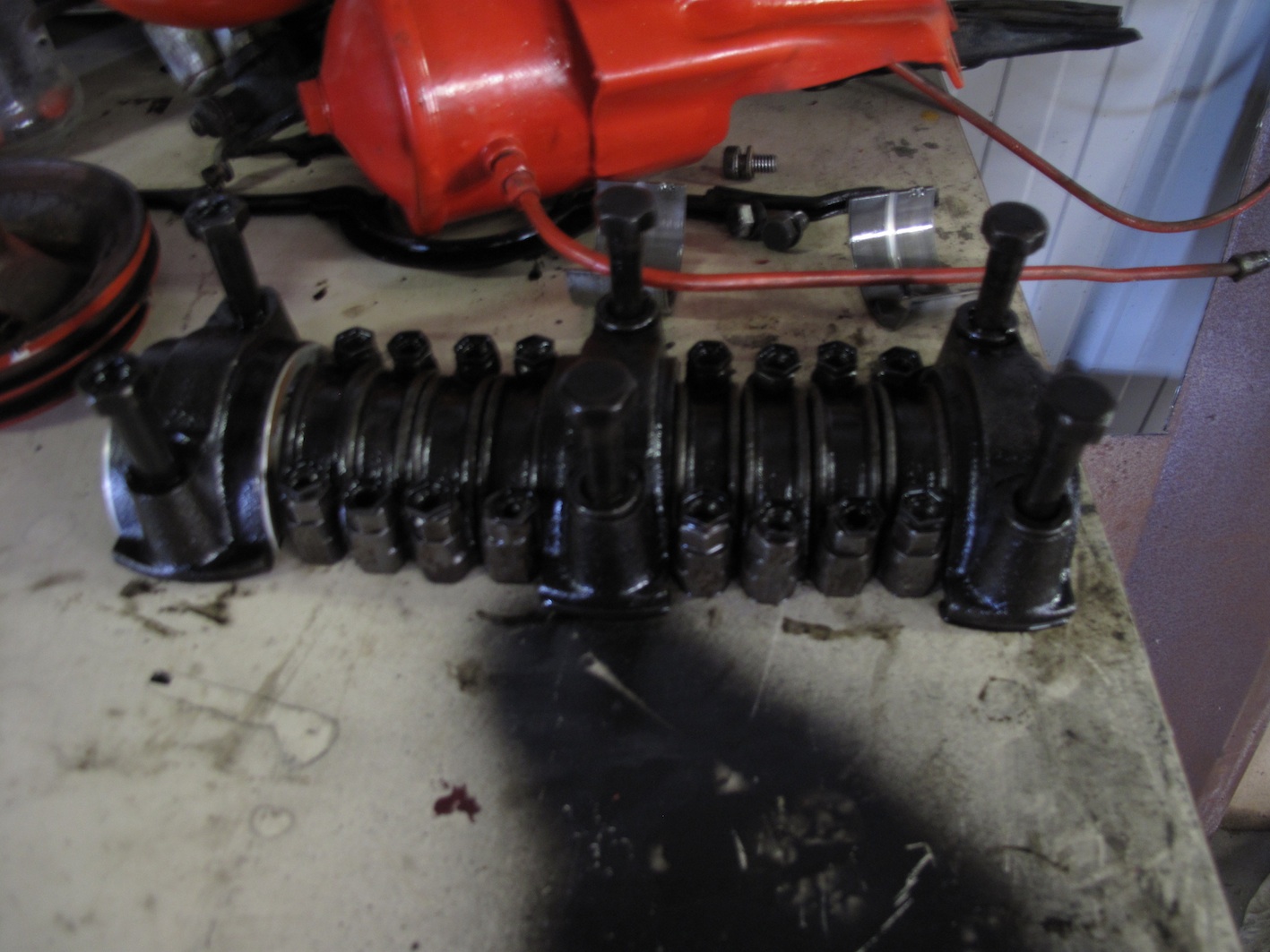

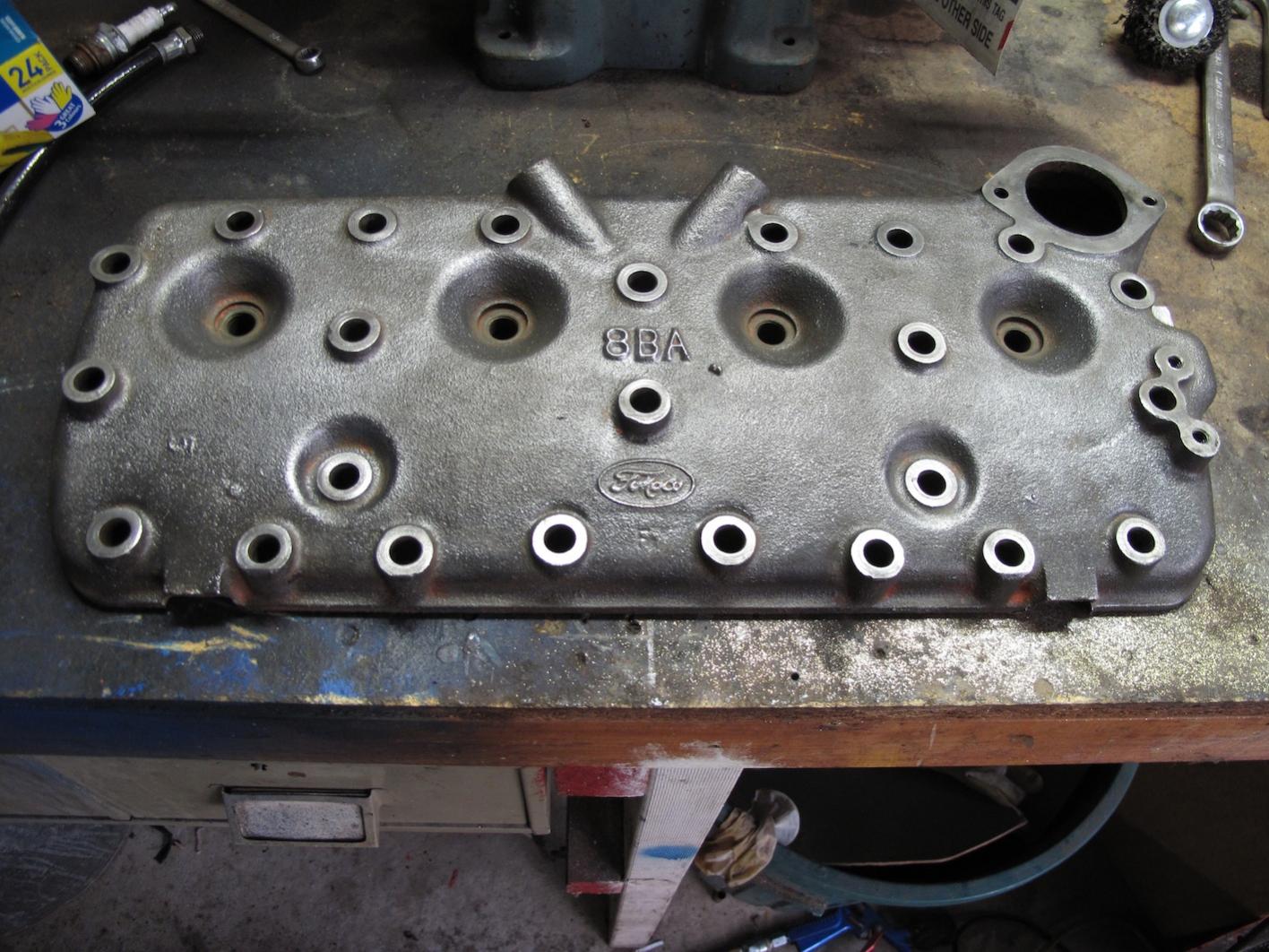

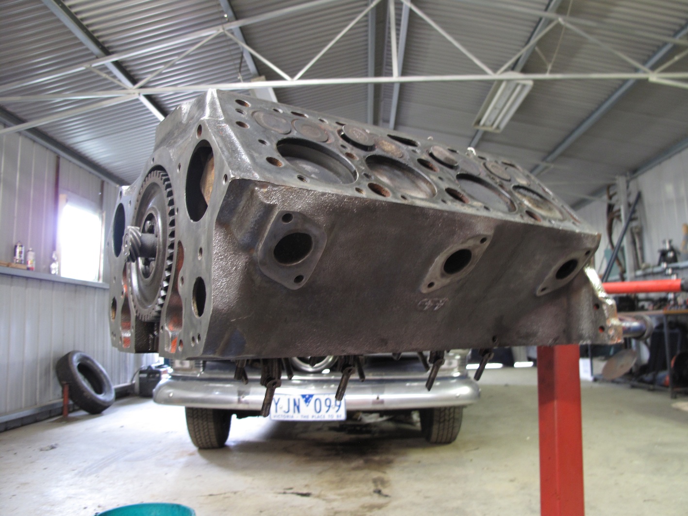

  8. out in the shed till 11.30 last night then had a half day strike at work, so got a bit of cleaning up and stuff done on the flatty while i wait for my full gasket kit from vanpelt spares aswell as the gearbox kit. nice and cheap, all the **** ill need, gasket, seals, input bearing, selector shaft seal, the works.
    good bloke to.
    so heres a few pics of how its coming along.
    alot of paintstripping, wire brushin on the drill and wire brushing up bolts,
    48 HEAD BOLTS= NOT TOO MUCH SKIN LEFT ON MY FINGER.

  13. Thanks mate, yeah seems to be a clean old stock flatty that's had a freshen up at some point not too far back. It's had a hone, rings, bearings and a valve or two changed. It will get a full rebuild one day but it's too good and it runs awesome. Hence the nice clean up job for now see how goes for a tear or so. I'm gunna be driving the **** outta it at chopped fingers crossed. Don't see why not just gotta keep up the pace.

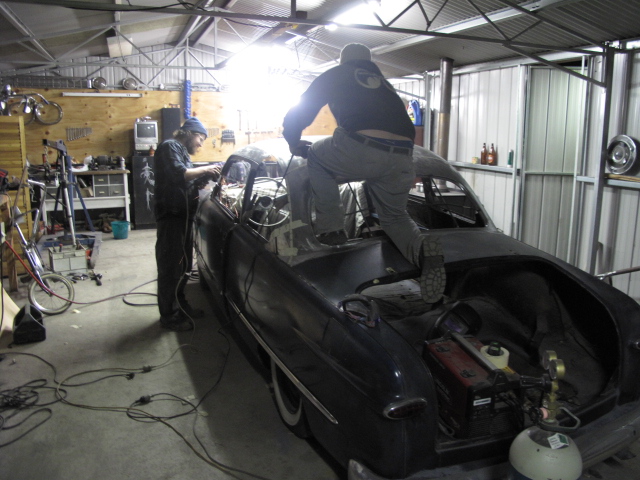

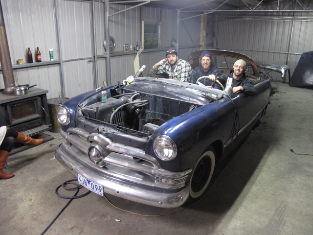

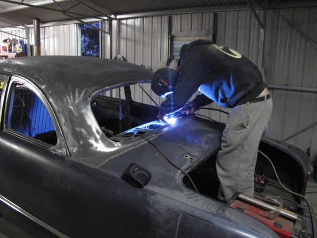

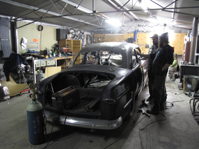

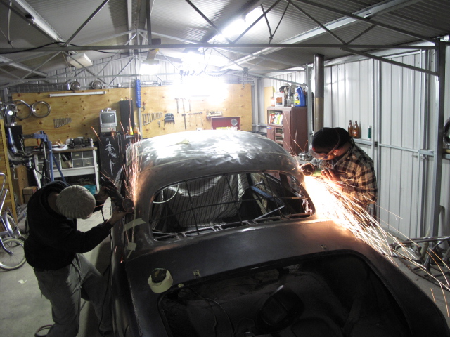

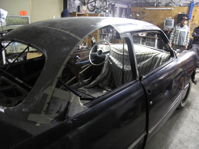

  17. friday night, got a bit more done, chicken bought his chopper frame over to smooth up the welds and stuff while i keep working on the flatty. ahron came over later on and started planning out the cuts and measurement for the roof chop start tonight, we are heading in a different direction to the norm, there is plenty of info on choppin tudors, not a great deal on coupes, we both have a good understanding of how people genereally do it, the way we want to do it is alot ore work, but we think it will end up good, fingers crossed, our plan is to b***ically, try keep the quarter windows at the same length but lean the radius, so as to not loos any length or not much and fab up some panels for the window frame, not sure if that makes sence but our goal is to try keep some of the size in the quarters instead of draggin everything forward which is cool for a tudor but on coupe "can" give you that small window on the quarters which i really dont want, slanted b pillars will also give it more size, Ahron is confident that it will work after talking about it for a couple hours and doing measurements last night, and i have a lot of confidence in him and we will make it work, may be a lot more work but we think it will turn out cool with a nice shae to the roof and not to small, rear window will lean down to meet the roof somewhere or near abouts to give the rear gl*** a nice rake type look.wish us luck. hope we dont **** it lol, gotta have a crack though.
    cheers
    heres a couple pics of hit last night,
    oh and i have found the eldorados club meet new food now, hotdogs in a pot on the fire in the shed, tooooooooooo easy.

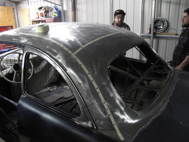

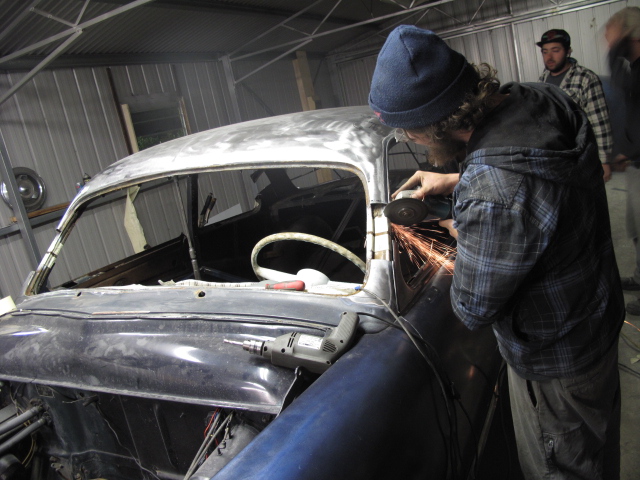

  18. it would appear we chopped the spinner, alot of planning and measuring and we have deffinately gone about it a different way which is going to keep the roof at the same length and and the quarter windows long, is a lot more work and a bit of fabication will be required but **** its a roof chop and it s not supposed to be easy and straight forward. other wise you probably wouldnt do it cause everypne would do it.
    heres a few pics of the roof before

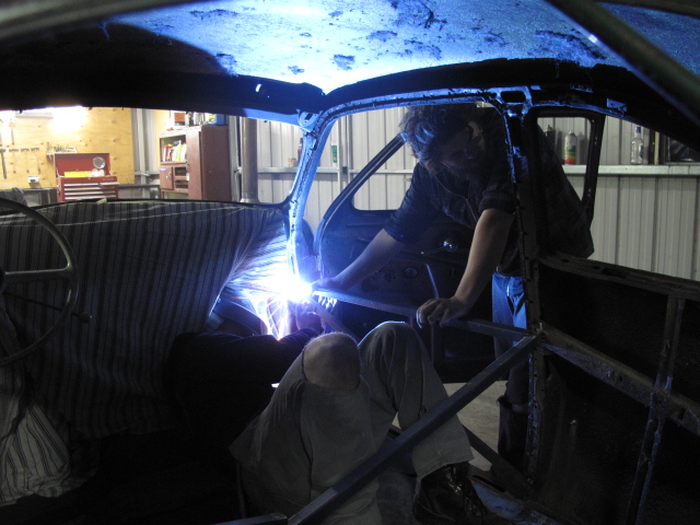

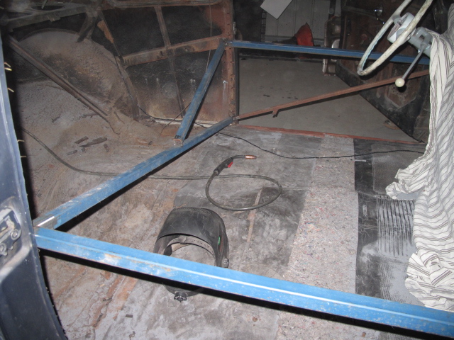

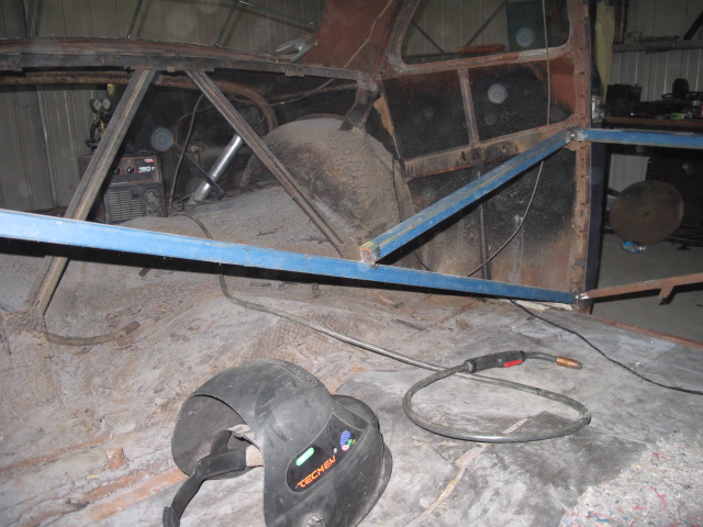

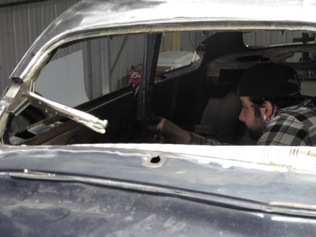

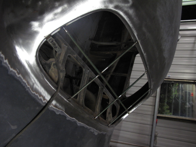

  19. once the roof and the door frames were stripped we got the back gl*** out and started to brace the rear window and then the inside of the car so as to not move and go weak when we started cutting

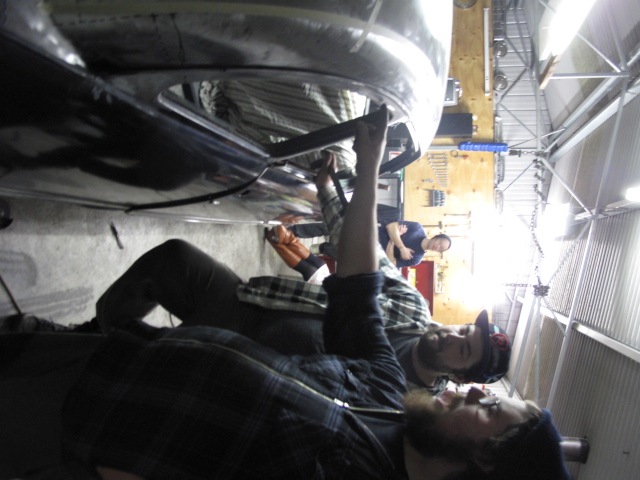

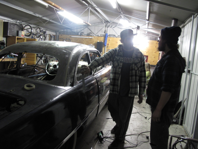

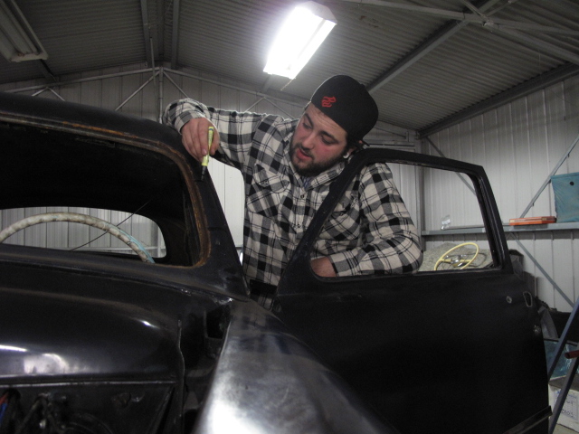

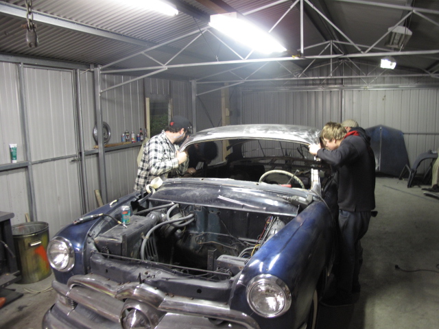

  23. ok, so after me and tex had something to eat sat night waiting for Ahron to get here,

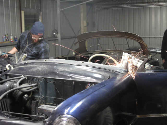

    Ahron turned up and it was measuring and talking about it for a couple hours before we made any cuts, this has been discussed alot with other people aswell to get the desired look we are going for, so with ahron and tex on the ruler and me talkin it out with them for a while we had our tape lines and cut marks all measured up ready to go, i will try give as much detail on this as possible,

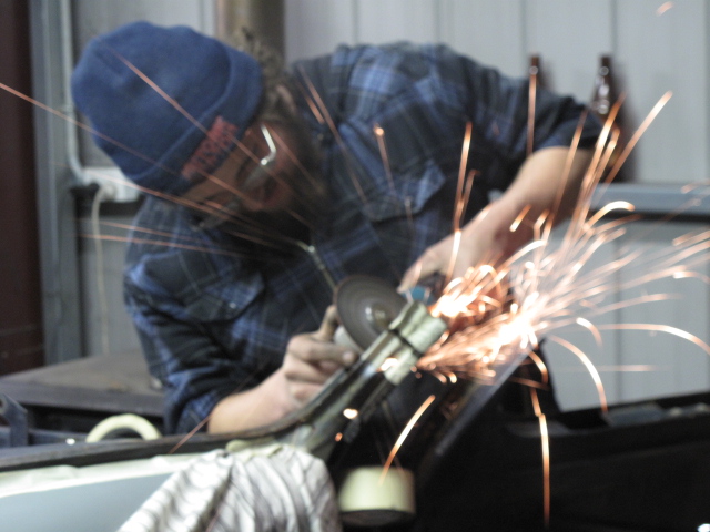

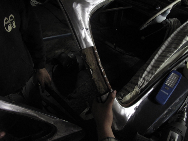

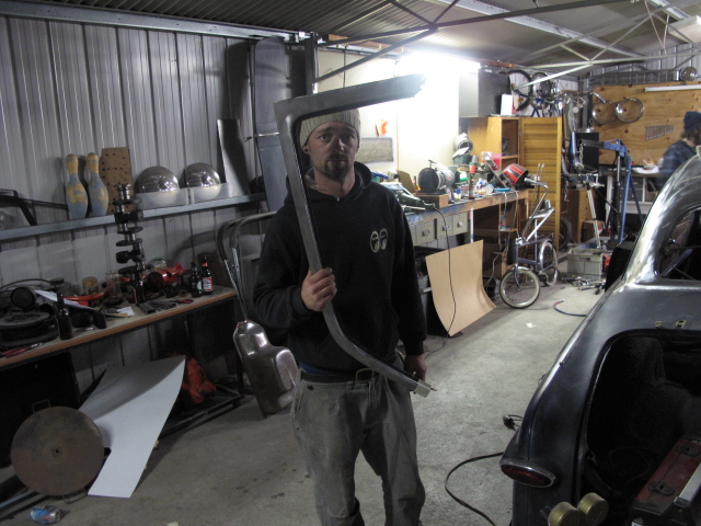

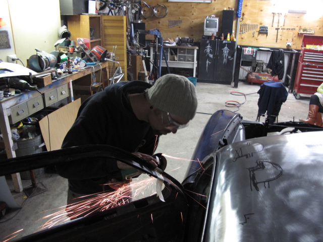

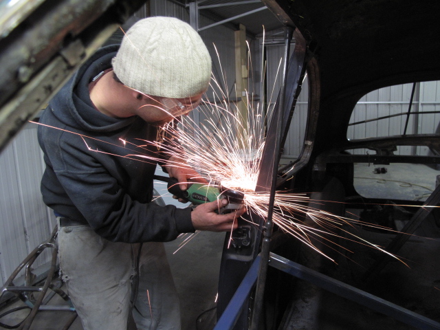

    first me and tex drilled out the spot welds on the inner of the a pillars (were the windscreen sits) and also on the other side near the drip rail and i free'd them up with a hammer and chisel, once we had the outer skin popped, i made two cuts on each one above and one below, on the straight of the a piller well above and below were our actual cut were the pillar will come down, the idea behind this is to take the outer skin of the a pillar off and do our cutting on the inner skin were all the strength is in the window and roof, so as to tack in and fully weld the inside at the end then trim the outer skin up to suit and sit back in and weld that too, giving you a much stronger way of doin it rather than just cutting through the entire pillar, it will be strong neat and we feel is the better way to do it, everyone does **** there way, this is just how were doing it.

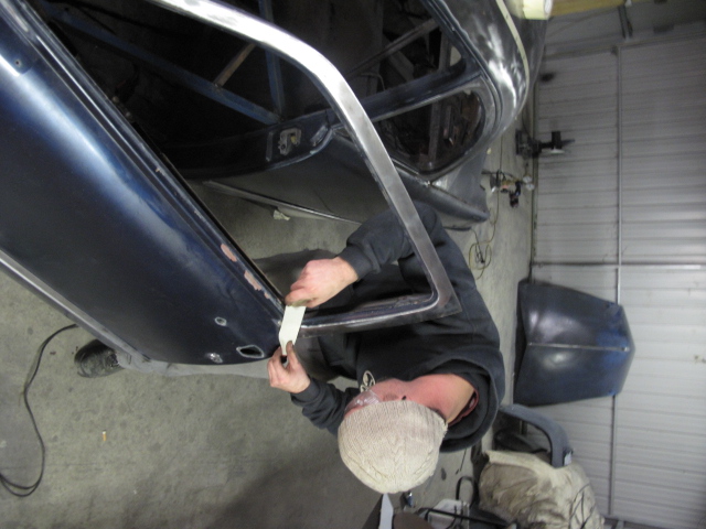

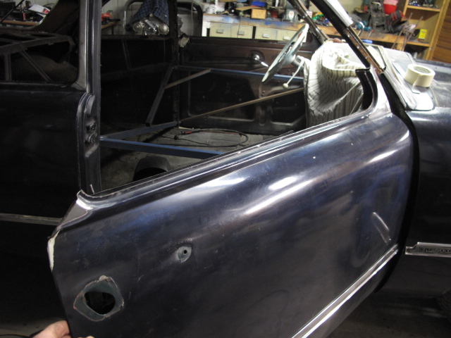

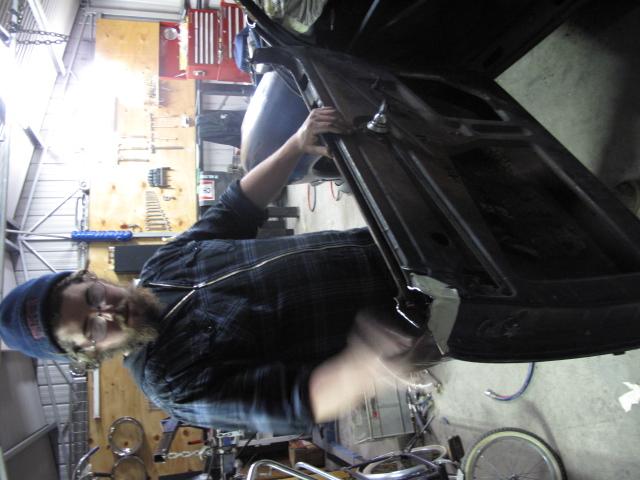

  24. after those two peices were removed and marker left and right, me and tex cut the door frames off once we marked were exactly we wanted to cut, these were cut at the front just after the radius and the bottom of the back end of the door on an angle which was set on one with a set square and then transferred to the other door as to keep it as similar as possible, remebering my car will have slanted b pillars once completed, you simply mark where u want to cut and follow the tape or texter mark all the way around with the grinder, parts like inner skins you cant get to we clean up with an air hacksaw.

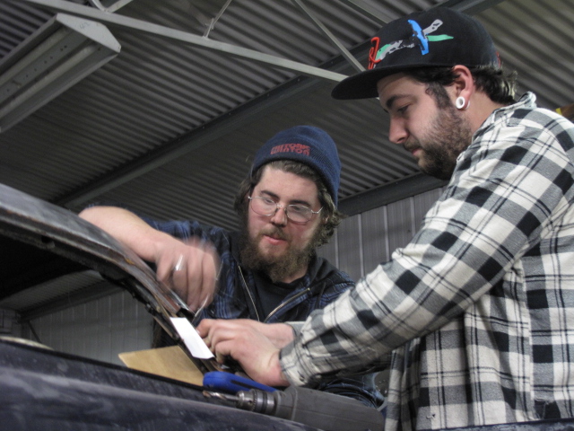

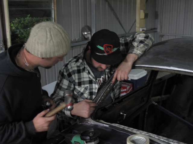

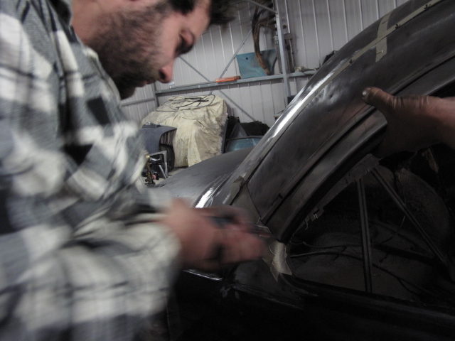

  25. so while i was stuffin around with the door frames and the a pillars, ahron was making cardboard templates of how he wanted the rear qaurter windows to look, him and tex were then applying then to the roof and working out were the rear cuts should be, it was all happeing and moving along quite well with heaps of questions and discussions, which is really good thing, Ahron kept saying "you can do it the easy way which is **** or the hard way with a bit more work that will turn out heaps ****in cooler", tex kept saying "cant wait to just cut this ****er up, and i kept saying "you guys are letting me doo all the cuts huh" which they both kinda smile and said "no ****, if you **** it, its your car" which is totally fair enough, ha ha ha.
    anyway, with the final taped out marks and **** it was gettin close to removing the roof, but first we had to mark out the a pillar inners and get the desired amount out, this is going to be a mild custom chop, so we agredd on 3 inches in the front and four and a qaurter to four and half inches in the rear, which is kinda hard to work out cause as your lay your rear screen you can move it around and prop it up to the desired look, but thats later,
    a pillars, then the b pillars cut on the angle for leaning later on, every cut on the strucural parts on the roof, you should have someone holding it so when it lets go your grinder doesnt grab and do something crazy like lop of a finger, they come in handy.
    heres the pics

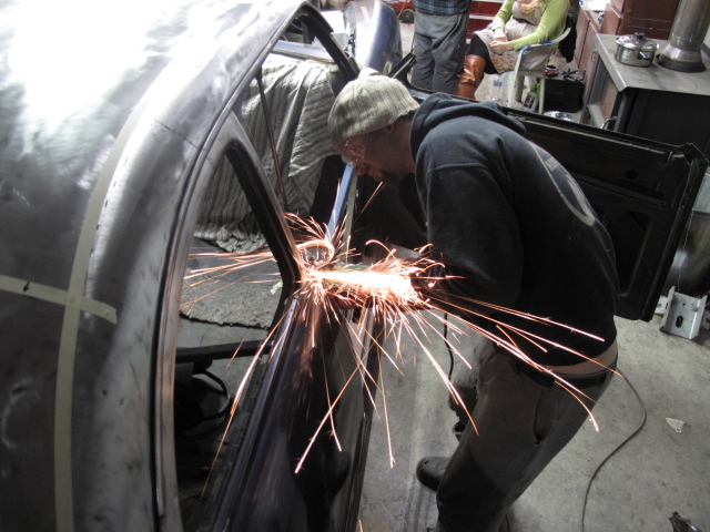

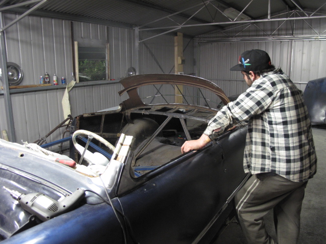

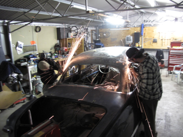

  26. right so then it was onto removed the peice above the qaurter windows and when i say this i mean b***ically because our whole goal aside from lowering the roof obviiously is to keep the qaurters at the same length, to give it more of the tudor look without loosing all the size in the qaurters, this is the hard part but will hopefully pay of in the end, this has been much discussed between the three of us recently as to how to go about this, i will be the first to admit that in this area i relly didnt have much of and idea how to go about this, i knew what i wanted and we all agreed on it but it was up to ahron and tex really to figure this out and fill me in on the plan, what we did was mark out at front of the qaurter window just after the radius and the bottom of it just before the radius, the pics will make more sence, we cut it on the straighter parts so that it can be heated and relief cut later to go back in and give a nice flow, it will require a little peice on each side to be fabricated to fill the gap as the top of the qaurter will end up a little longer, you will see what i mean, ma and ahron cut straight through the window frame and the drip rail and up about 5-6 inches into the roof the along out taped out line on both side so we could remove those peices first, like i said this is alot more work but my buddies have it under conrtol, it will pay off in the end, im in the moon hoodie, ahron has the hat backwards and tex is the bearded menace weilding the five inch with big cut off wheel and no gaurd ha ha

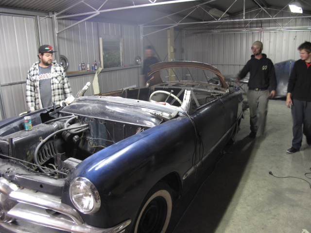

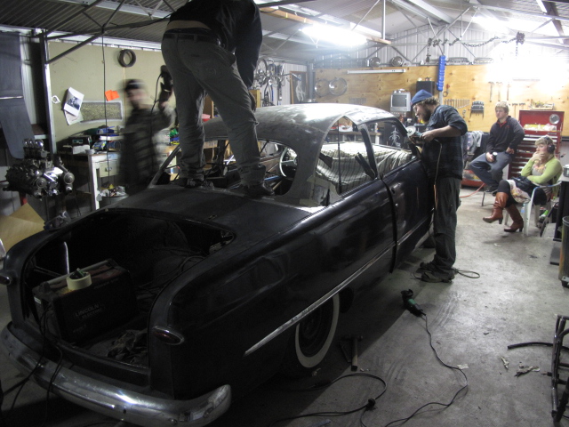

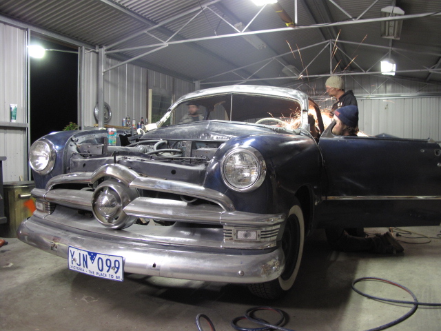

  27. once those two panels were removed and set aside, the texas five inch m***acre came in and cut straight through the a pillars and then we did our cut across the back above the window and down the c pillars as to leave the rear window sitting in stock position, that comes later, then it was roof off and a couple pics and a beer and cigarette break.
    scary **** when your roof lifts off and we just put it on a panel stand and everyones like "**** yeah"
    the guys are like "alright des good hanging out and cutting the **** outta your shoebox, we'll catch ya in a couple weeks or so when were free"
    lucky they were joking.

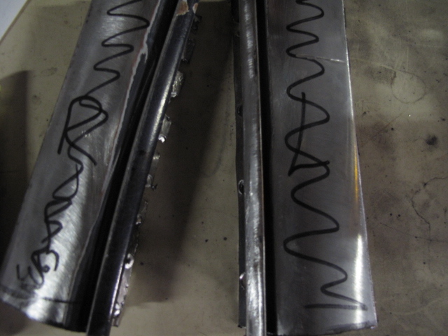

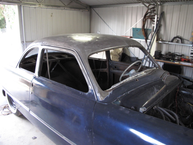

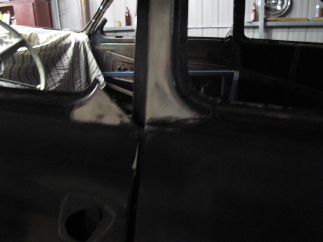

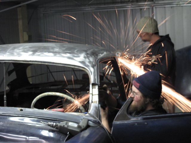

  29. the roof on the panel stand was short lived, tex cut the remaining amount out of the a pillars then we sat it back on, remembering roof chops are measured vertically or at least should be, so 3 inches vertically once leaned over can equite to like 4 and half or something like that that actually gets cut out of your window posts. so once the roof was put back on it was a m***ive shock cause it can look like alot but the more you look at it and the more it takes profile the more you go **** yeah, it isnt over chopped its nice, in our opinion anyway, the thing Ahron said to me and really makes the most sence to me is this, i said "man it looks like alot outta the screen" and hes like "na its how your looking at it you gotta imagine the door frames are back on and the rears finished then you will get a good idea of how its gunna look",
    he then said this, "if your not happy with the amount we can raise it back up" and i said "na **** that it looks good its just a shock" he then replied "i dont think its over chopped i thinks its just right, and ****, dude its a spinner its supposed to look like its gunna eat ya"
    fair enough. and couldnt have said it any better myself.
