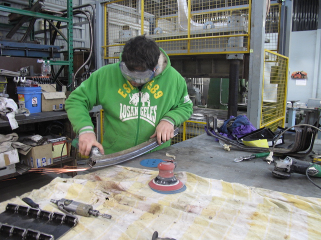

  2. last night went in to Waddingtons street rod restorations were ahron works and we started trying to change the shape of the qaurter window panels, we first used this crazy shrinker stretcher machine, we worked it in one area shrinking it then went to the other side change the teeth in it and stretched it the other way, then we put a bit of heat in the form of the oxy to the underside of it on the inner panels and then moved it abit that way, its deffinatly moving where we want it to go but we only had a quick go and were going to have a look tonight and maybe do it abit more, were just taking some of the curve out of it so we can make the qaurter window flow with the roof and we want to do it with out making to many cuts in it and moving it that way. she'll all work out,

    spent most of the day with the chicken man re-seating the valves, time consuming but soming up neat as and will be great help for the engine. was running well before and there is a few valve seats that had noticable burn marks or pitting, the valves are all good as some have been replaced in the past but there all sealing up nicely, new valve stem seals on the intake ones cant hurt either, then we went into waddingtons were ahron was on a mission to get one of the quarter window peices apart and the new part in, i drilled out all the spot welds and took the panels completely apart and shaped everything to were it needed to be with ahron and got it all nice of our template, then i re-welded all the spot weld wholes back together and got all the clamps off and with a bit of panek beatin from brother jeffree and more shaping it will be right, i bought it home to trial fit it and looks like weve got the right shape, will require more work but nothin is easy about these panels, but i thinkit will pay off soon, Ahron is keen to get a ****load done on the roof sat and a bit monday so looking forward to that, tomorrow night were going to start on the other side qaurter window, stayee tuned for some updates this weekend unless i decide to go on a bender and get drunk al weekend and do nothing which could always happen,...............

    ahron and myself had a bacon and egg breakfast yesterday then tex rocked up and we gpt into it, b***ically we had the panel made up but still needed some tweaking to get right and had to lean the c piller in a bit to get everything to line up and flow, a few whacks, a bit of heat and she was getting somewhere, and a few mearuements of course.
    we got all that tacked in, the c pillar and around the rear window scribed and neatly cut and oxy welded all that together and tex and whron taught me a few great lessons on heating to shrink and stretch steal, and showing me how they heat spots to then beat it and move it to were u want the metal to go, pretty switched on my two mates, still alot of work but the amount of metal they mves and smoother out by heating with the oxy then hitting it with the hammer and dolly to get the right shape was awesome, i also fulley welded up the a piller inners and grinded them smooth and bit and cut out the fuel filler area and made a new panel that we will weld in monday and i can clean all that up.
