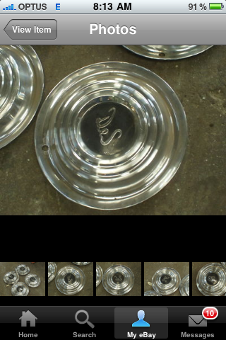

    dont laugh a mate from the cabalerros told me about these caps on ebay, 55 desoto, i think im gunna get em, its either cool or really lame thats they say des but i reckon there a cool hubcap and would be different i think, would like to know what people think, i can always hang em on the shed wall or put a bullet in the center,

  16. D,
    The Desoto caps r definitly a go buddy. I've no doubt u will pick up at least 1 other set whilst in the US & many other cool parts.

  17. yeah, im glad to here someone digs the desoto caps, i reckon there rad and may look good have to wait till i get them, that is if i win them on sat,

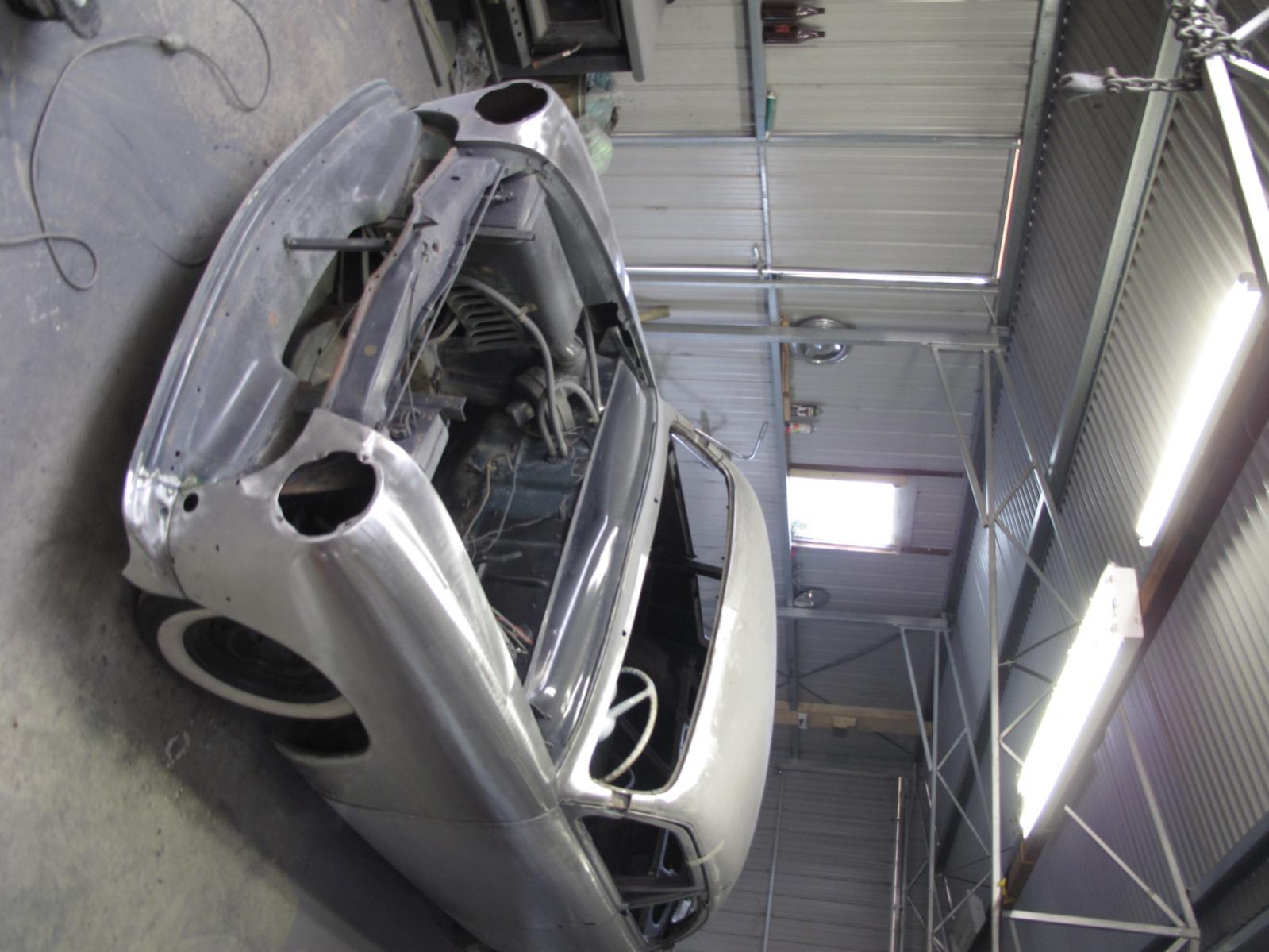

  24. alright update time,
    got a fair bit done, kept weldin the roof up and beatin it as we went,
    got the fuel filler all welded in, i am an amateur oxy welder but Ahrons is awesome at it so he's teaching me as i weld, i can do it alright just got tune up the skills alot more, what better place to learn than on my own custom,
    Ahron is also teachin me to tap up as were doin it which is great,
    anyway, the fuel filler is welded in and got some shape in it, ahron is showing me how to body file it and get it real nice with minimal filler as i want to take it bare metal to chopped, so its gettin there, we also cut and tacked in the caps for the a pillwer and got all the screen sqaured up again, we started doin the drivers door window frame looking at gettin that tacked in soon, sutffed around with the flow on the gutters, its all little **** really but will make for a better car at the end, we still have to work on the other qaurter window this week, its a huge job but everytime is coming more together, tex knocked out a few dents and tapped up as i was weldin, me and ahron welded from the c pillar up to the roof.
    i pretty much got nearly whole car in bare metal with only a little patch required at each fender, the cars is so damn good body wise its gunna look great. anyway check out the pics im stuffed.............

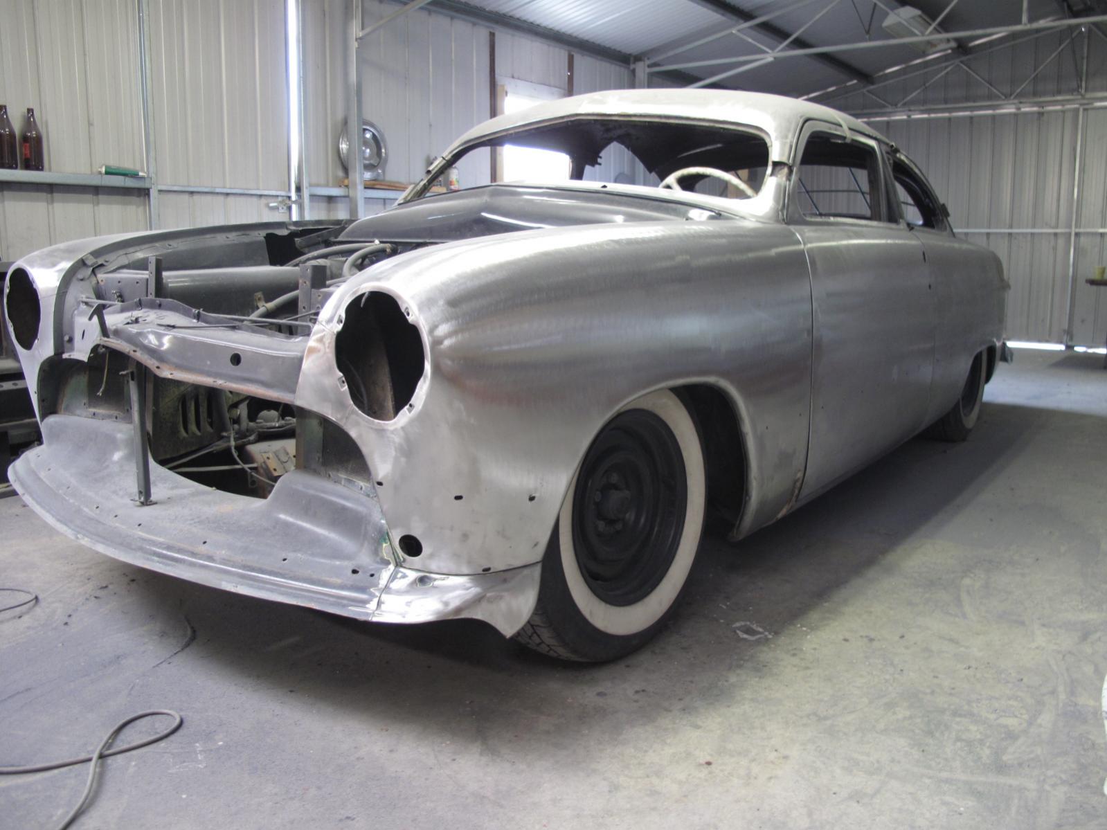

  25. some more, fuel filler still needs some work but it came up really good, would be perfect with a skin of filler but we wanna metal finish it as good as possible so that it looks killer

  27. Damn it looks so cool in bare metal.
    You boys are doing a nice job and you really hit the jackpot with such a great body.
  28. thats a damn nice shoebox, she looks sweet
  29. Looks great in bare metal with solid black wheels & whitewalls D.
