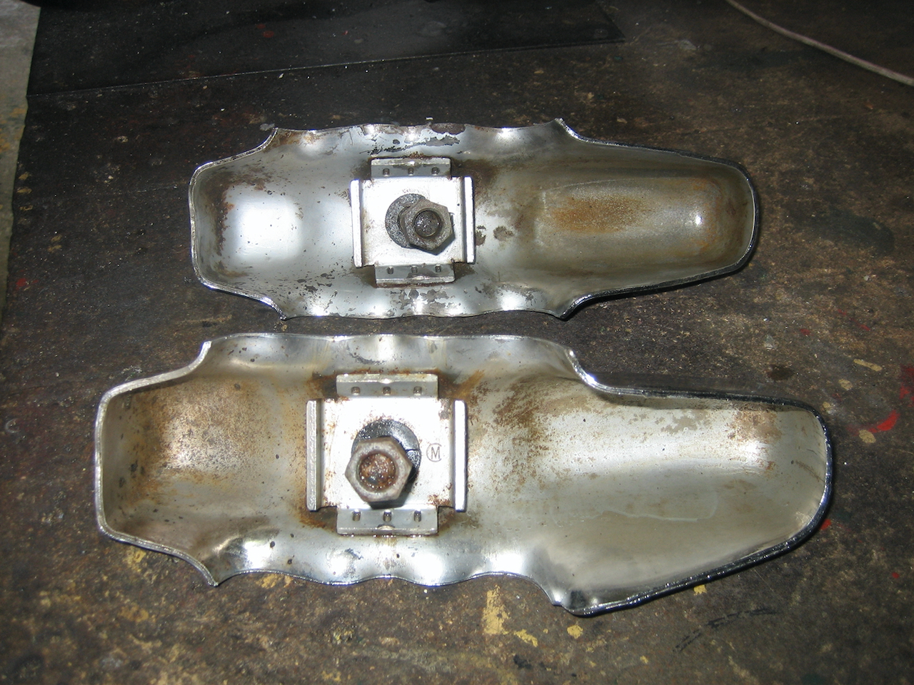

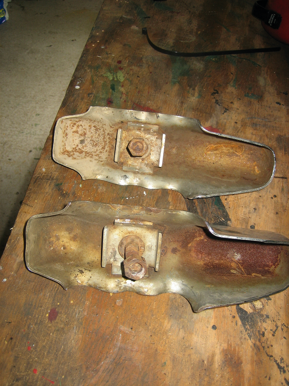

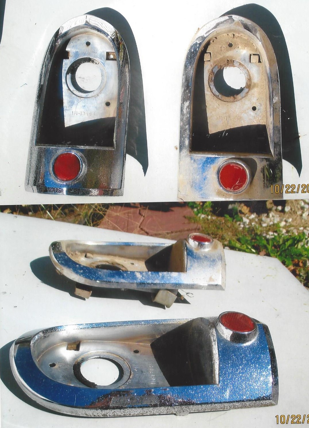

    I use the citric acid,,,,,this is from 24 hours soaking,if you want a better result, leave it in for longer time.

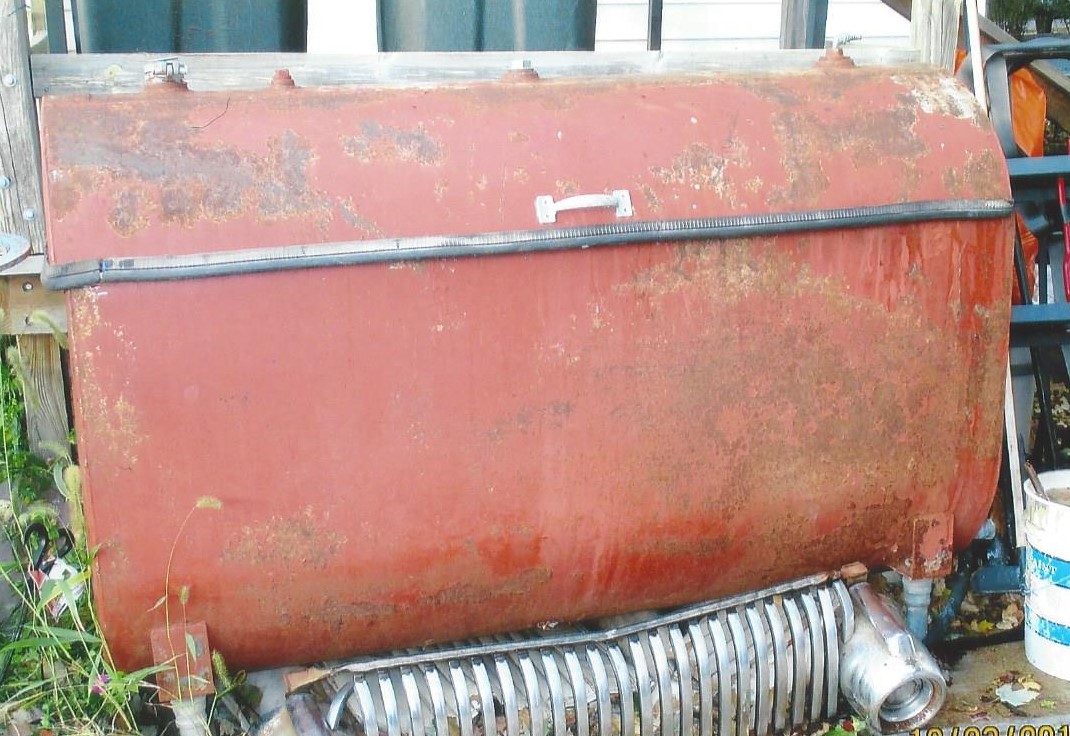

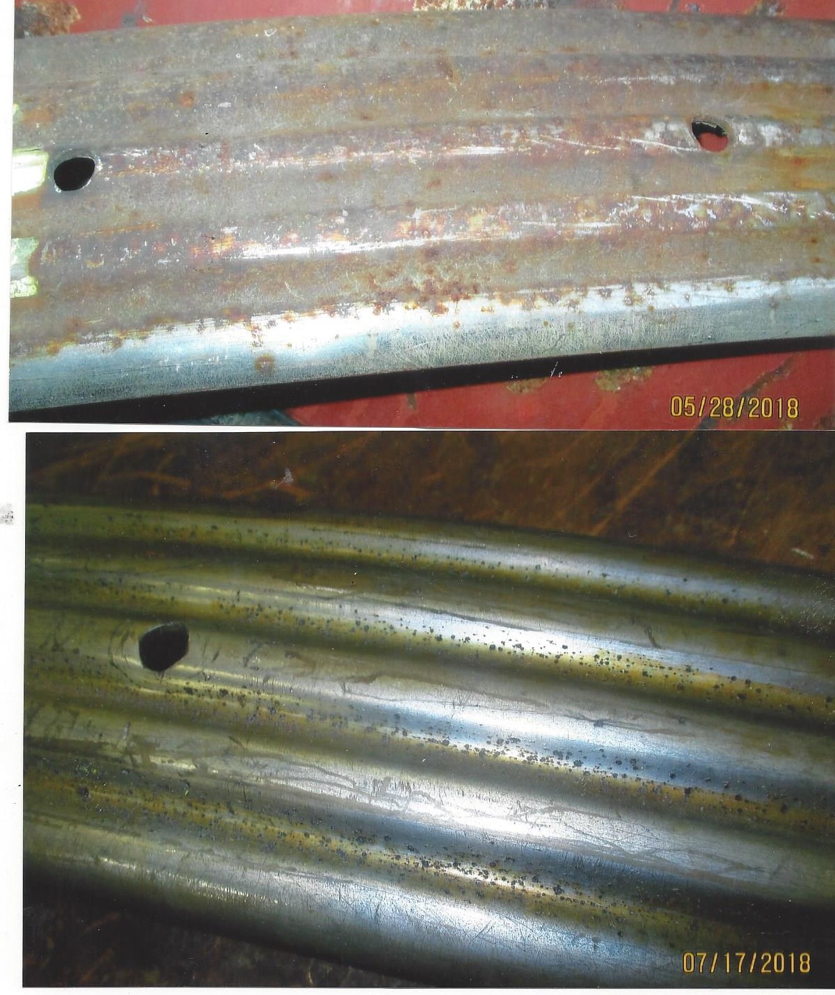

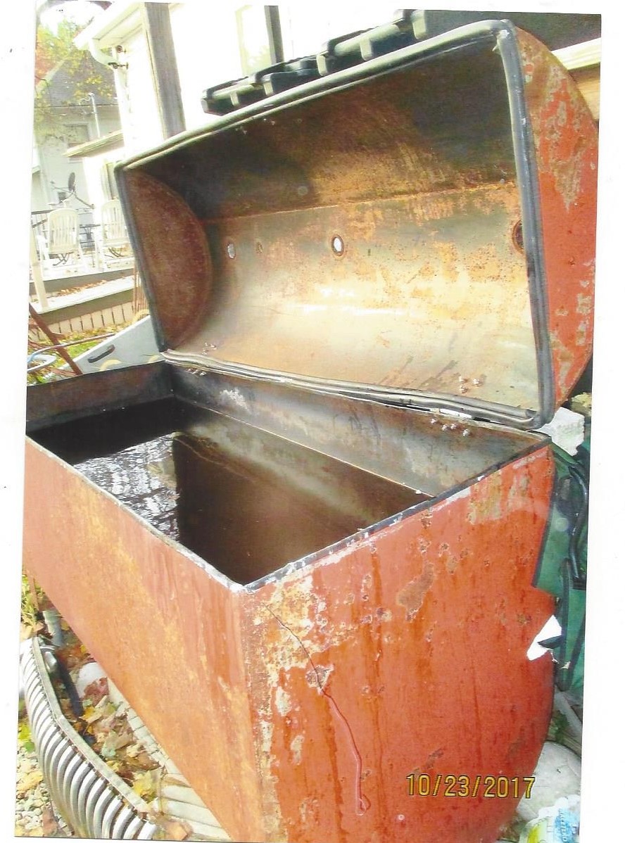

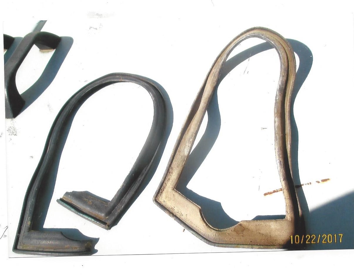

    Scan0490.jpg I use 25 pounds in this tank. Then a couple years later, I add the other 25 pounds. I clean it out every 4 years or so. I have left parts in for as long as 10 minutes (cleans up dirty chrome) to 4 months. It freezes in the winter, so I wait for it to thaw. Some on the end of the cycle it takes a bit longer. IMG_20200712_0005.jpg Scan0489.jpg IMG_20200712_0004.jpg
