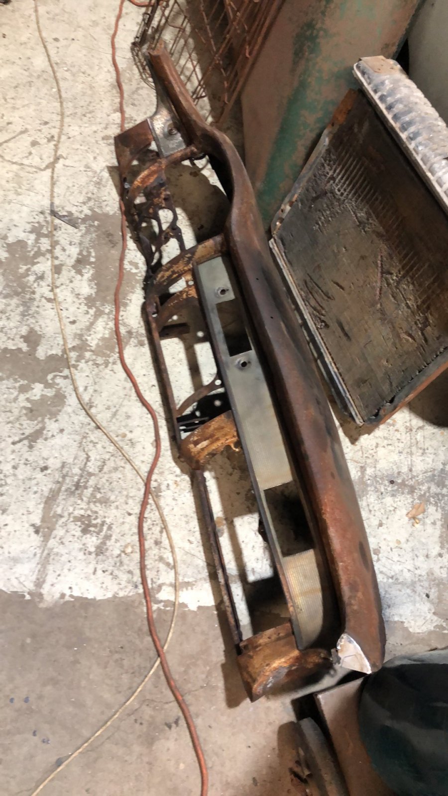

    44697572-205F-47D4-A56D-5BA4BF8525B1.jpeg Well I got a 25 kg bag of citric for $187 delivered. I wanted to do a test run so found a sturdy plastic tub. 5 cups of citric acid powder. And probably 5 gallons of water and chucked 50 odd salvaged bits that were heavily rusted 53 Eldo, in a car fire 40 years ago. The results in 24 hours are remarkable.
    I pulled them out for a quick look. The majority of heavy scale just wiped off. The remaining rust can soak for another day.

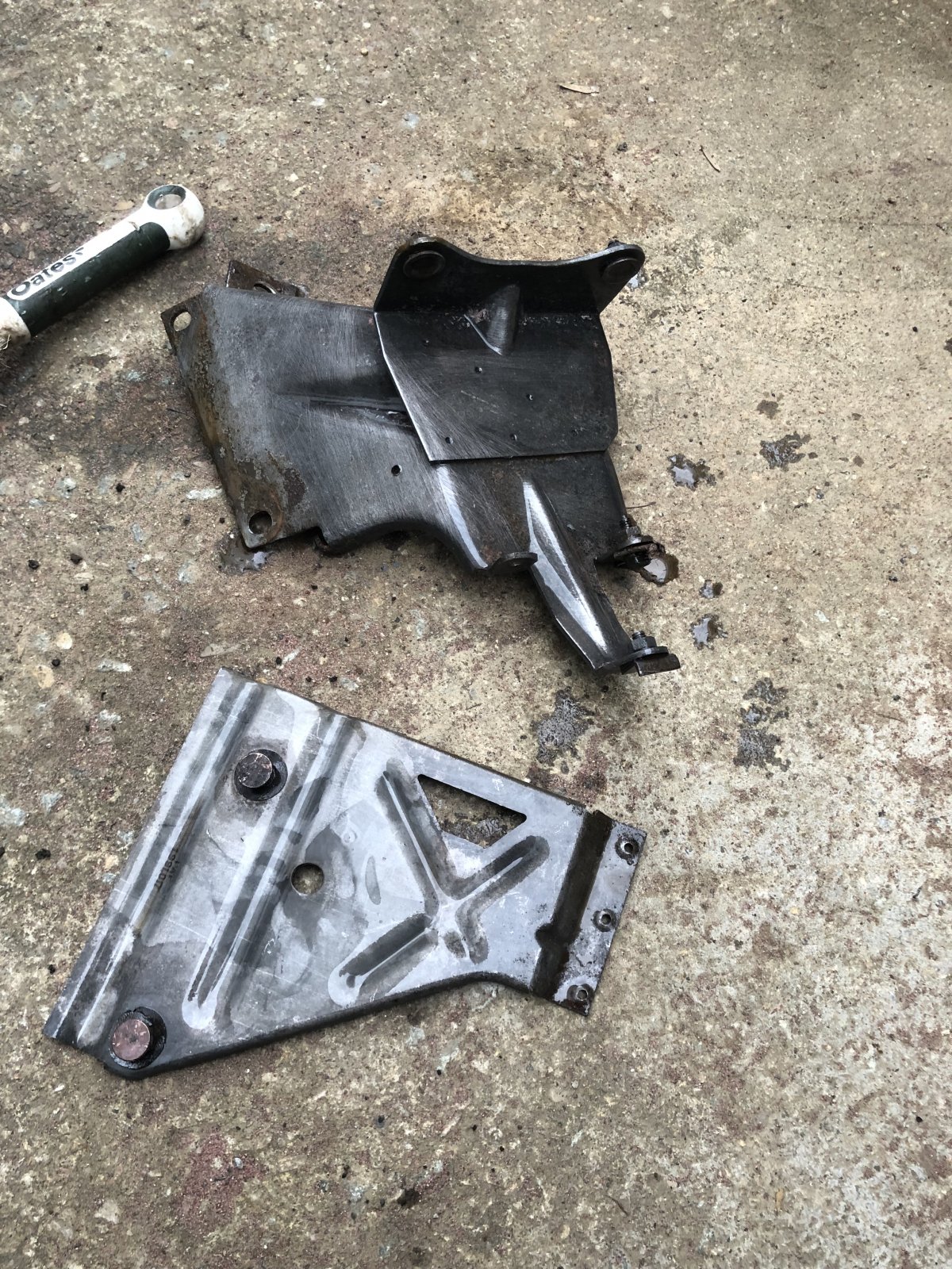

    20220704_084832.jpg 20220704_084848.jpg Soaked a few days and rinsed with hose and soft brush.

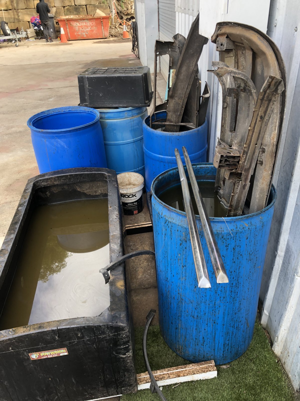

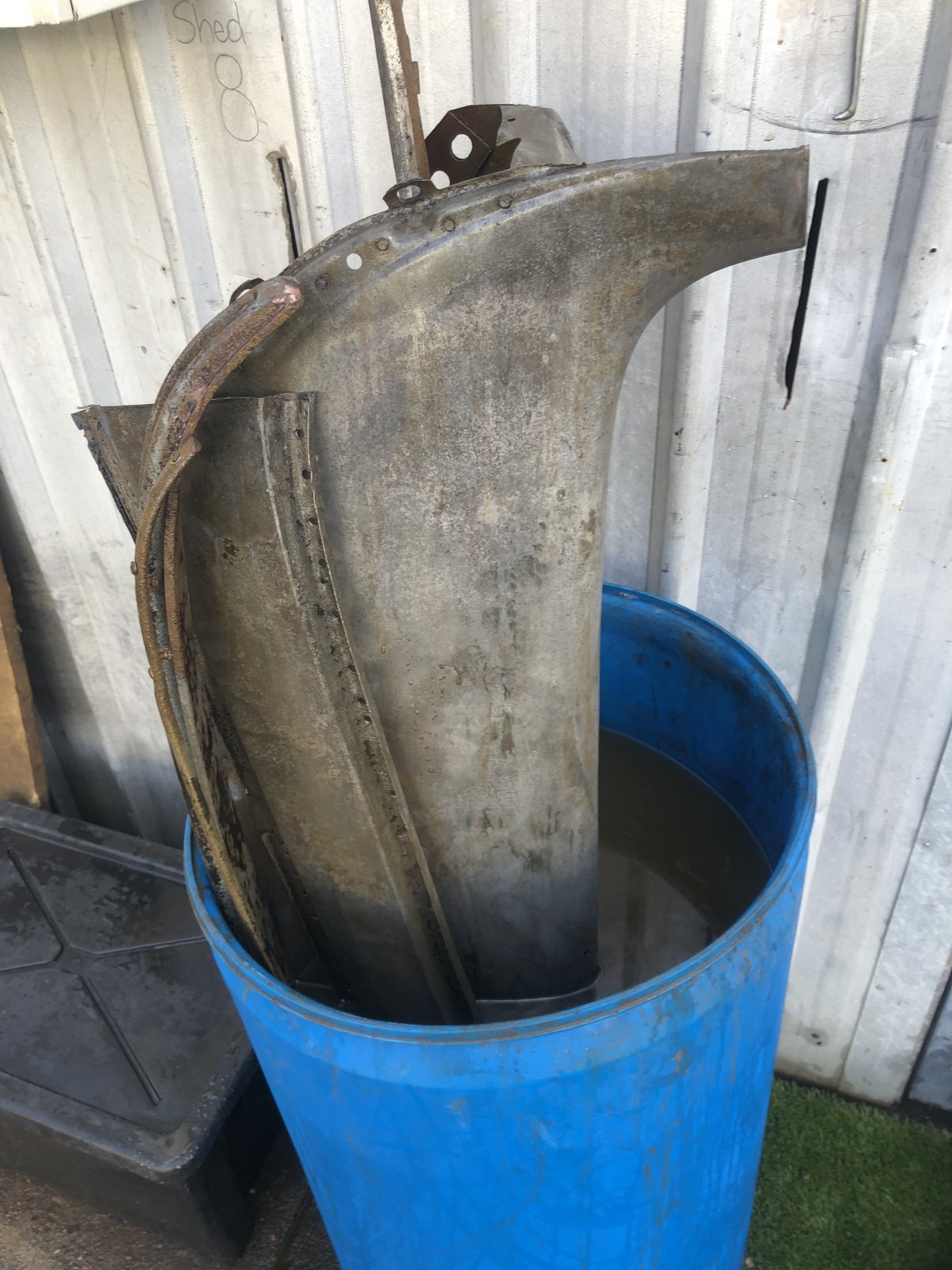

    I just thought I’d keep you abreast of progress. Got dash and conv bows and battery tray and anything that is rusty that will fit in a plastic drum. 7 cups in a 3/4 full drum. Less potent solution but it’s done a great job in two days. I just turned everything over in the barrel and only a wipe with a rag so far. 02CA2673-D297-42B2-8217-82F21EBECB9D.jpeg 5635D505-4459-4422-92C5-268377A79088.jpeg

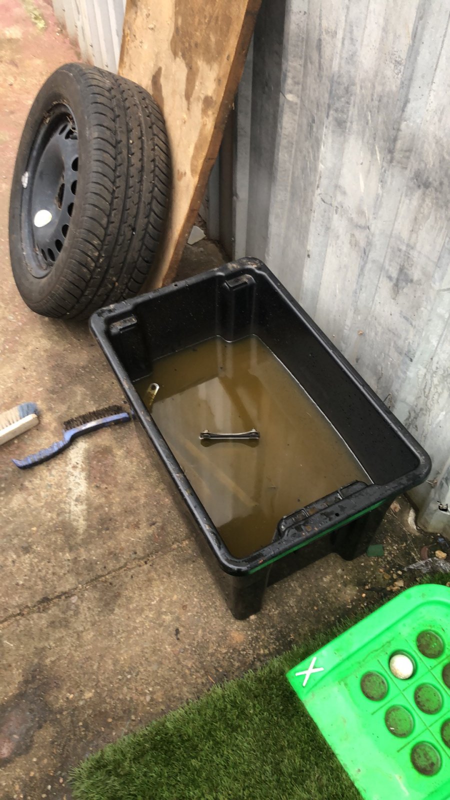

    In the fairly mild solution I have going presently (7 cups to close to 200 litres of water) and with twice daily rotation I haven’t found an issue. I guess if you left it for a considerable period there is a chance. I’ve got a third tank going now. Seat frames are immersed and soon I’ll be getting next doors high pressure washer to blast any residual off. 8FA61983-4635-4461-9A9B-98CD71862463.jpeg
