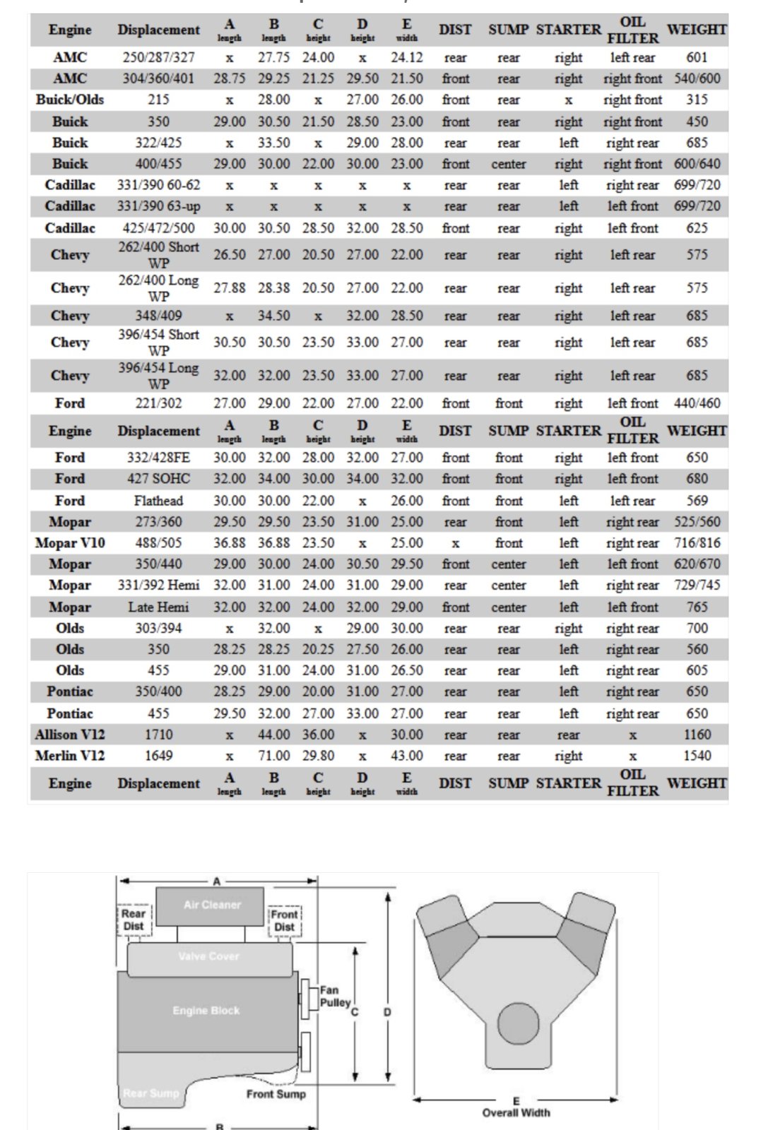

    I really like that the chart posted by @nochop includes the numbers for an Allison. You know; just in case.

    Agreed! I need to stick this on the wall of the shop for bench racing purposes if nothing else. @nochop any comments as to the accuracy of the dimensions on this do***ent?

    For those of us who don't happen to have a 291 DeSoto laying around for reference, maybe you could add your dimensions to the chart? Who knows, there might be one lurking around the corner. ;) BTW, that's a pretty handy chart, @nochop. Thanks.

    Yep I screenshot the chart and will be blowing it up so I can have it in the garage,
    Thanks @nochop!!!!!

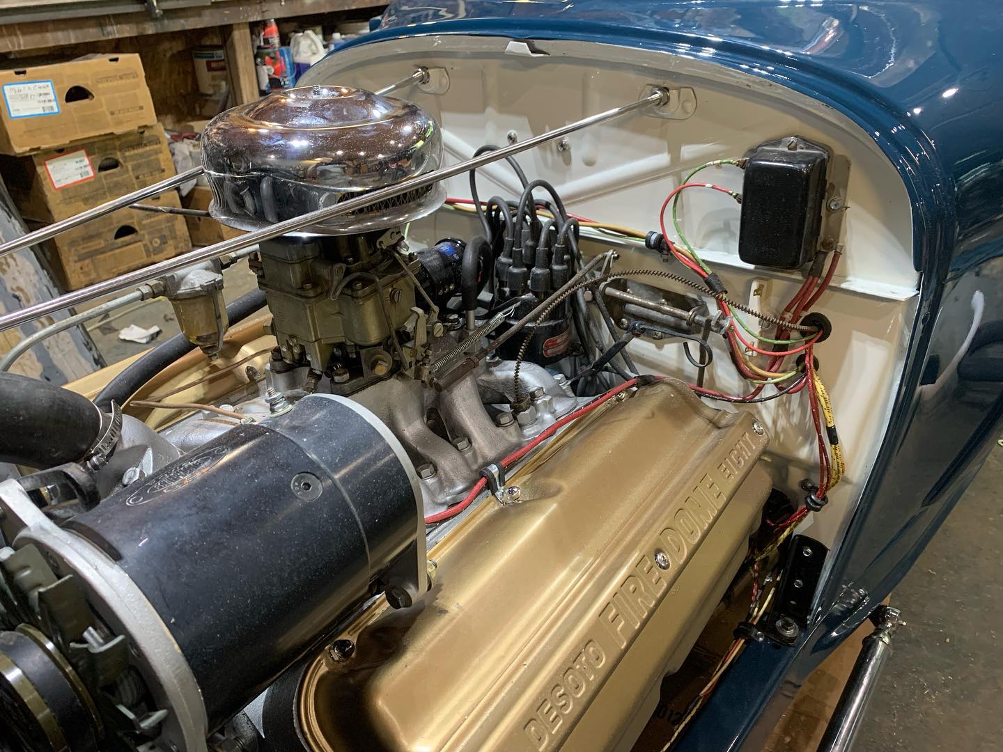

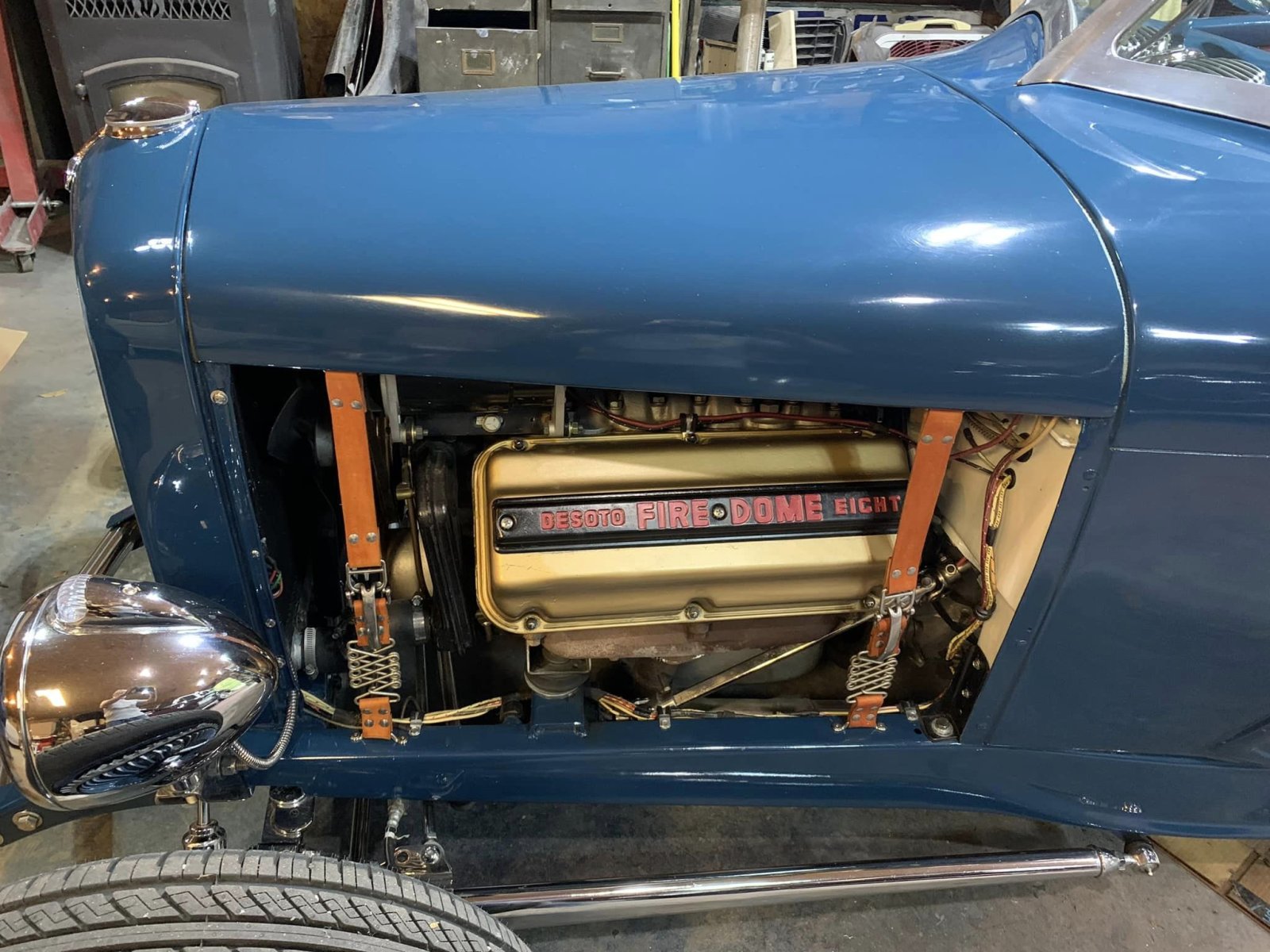

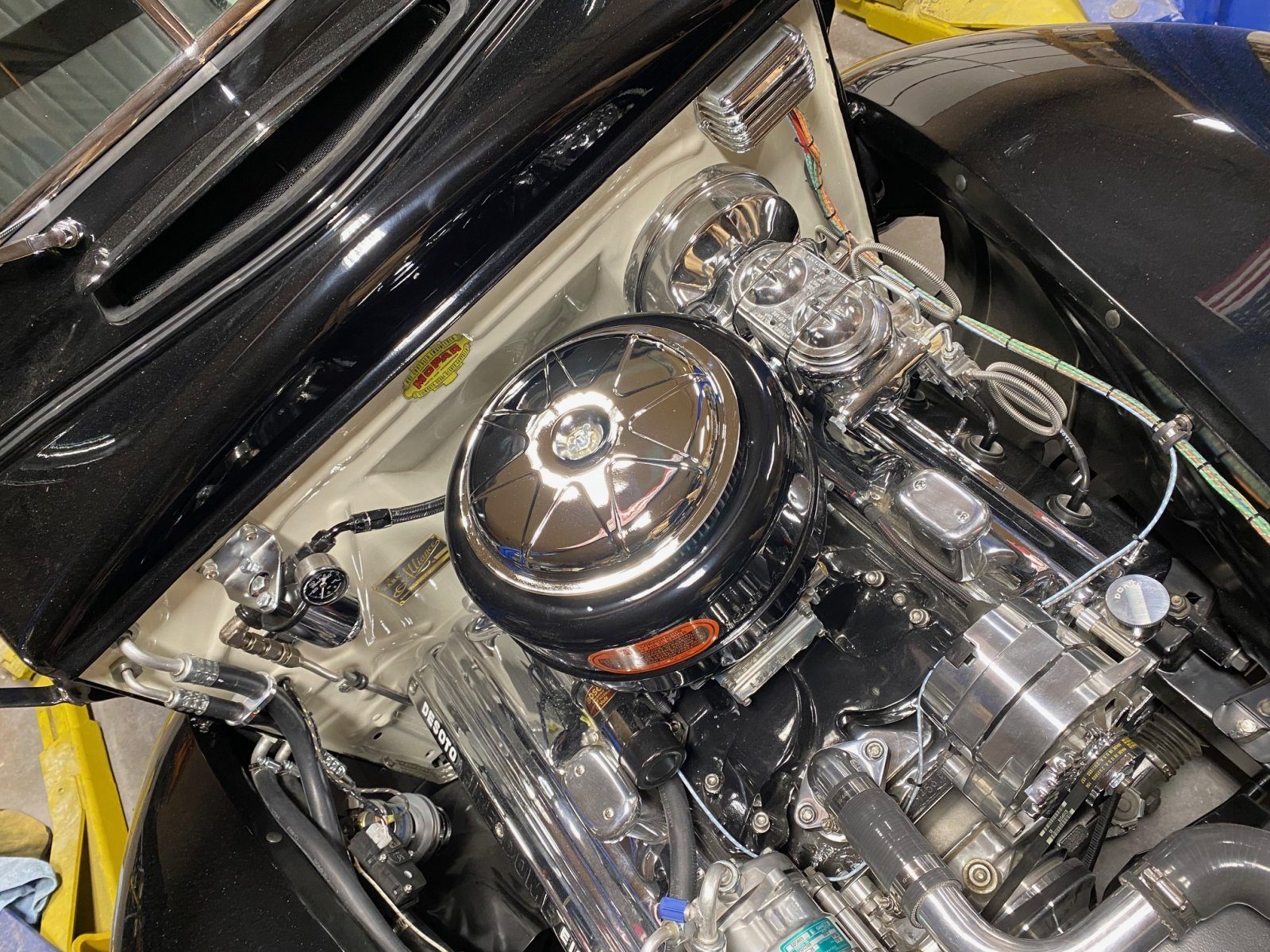

    A 276 fit like a glove in my '29, BUT... It's on a '32 frame, so there's a bit more room between the (stock steel) firewall and radiator. The notch in the firewall looks like it was made to snuggle around the distributor. 8DAC7638-6B79-4C13-9765-EA46BD83E044.jpeg 1C9862D9-081B-4982-895C-67FB99EE8213.jpeg CCB1C63A-4C02-4144-A2A8-412597C6994B.jpeg

    Your welcome. Pm me and I can mail the file

    from norcal
    No, I don’t even remember where it came from

    Pm me and I’ll send out the file for the low low price of…..free

    That chart is in carnut.com
    Most of the baby hemis are roughly sbc length wise. If I get a minute today I’ll google around and find you a confirmed length
