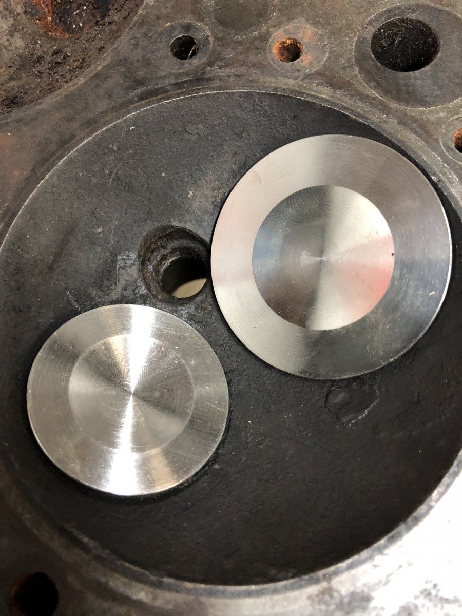

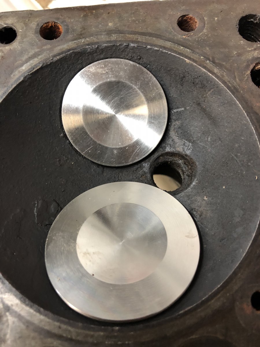

  1. Hey guys, give me your learned opinion,
    Will these be too big for my heads,,,durability wise?
    They are 2.02-1.60,,,the intake valve is awfully close to the spark plug hole.
    Any thoughts?
    I am thinking about cutting them down to 1.94?
    Tommy

    I would say 2.02 is cutting it a little too close. My 341 has 1.94 intake valves in it from the factory and that seems a little close.
    Weren't Desoto heads prone to cracking from the valve seat to the plug hole?
  3. I am guessing you are right.
    My feelings are that they are too close,,,,probably go with 1.94 size.
    I was worried about cracking as well.
    Tommy
