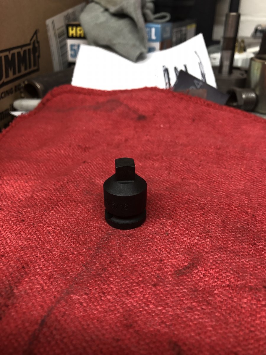

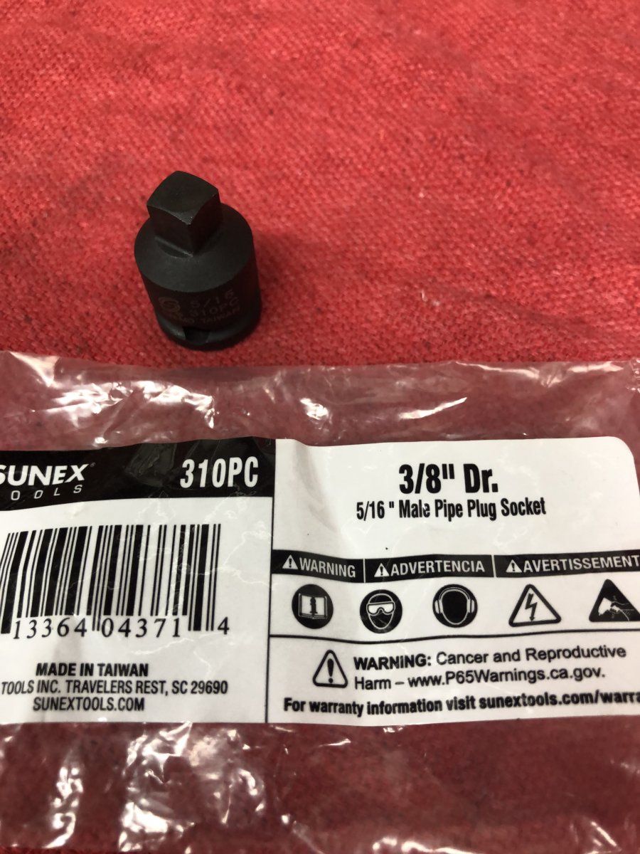

  13. The correct tool/socket arrived today.
    It looked like good quality but I was still nervous.
    It worked like a charm,,,it was almost effortless.
    I put it in the plug,,,,used an extension to give more room at the rear,,,applied some pressure.
    I was using a 3/8 drive breaker bar,,,,I didn’t want to risk my good ratchet,,,and it worked great. It might have took 30 ft pds to break it loose,,,,or very close.
    I am glad I removed the plug,,,,there is probably an inch and a half of crud in there.
    I stuck a screwdriver in the galley,,,,and it felt like it buried up in mud,,,literally.
    There is no way to get all that **** out with hot tanking alone,,,,maybe most of it,,,but not all of it,,,,unless the plug is removed.
    I ordered the socket this past weekend,,,,Saturday,,,from Amazon,,,it cost a little over 16 bucks with shipping ,,and arrived today.
    Awesome quality too.
    Here are some pics.
    town sedan likes this.

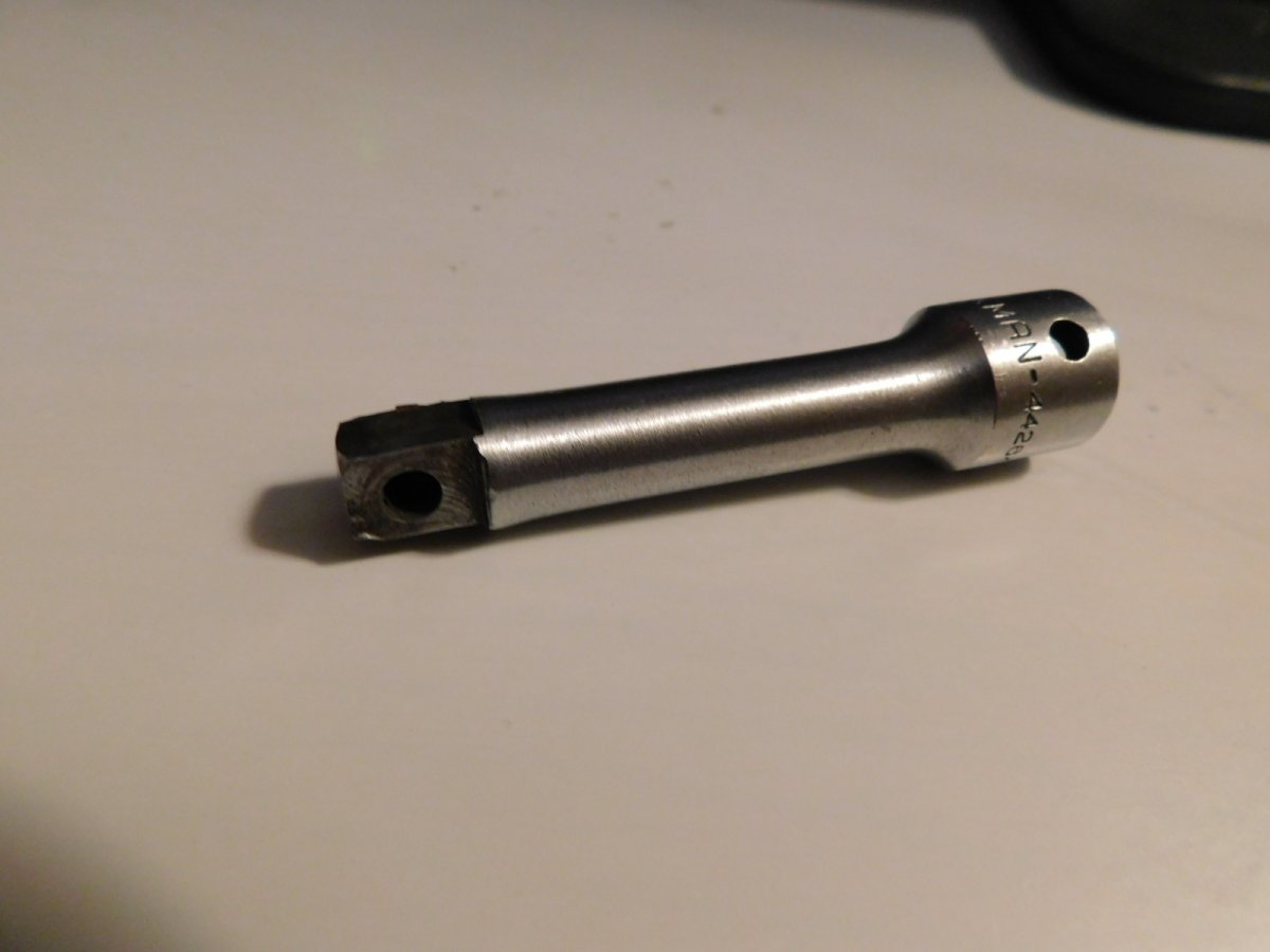

    DSCN0002.JPG 5/16 oil galley plug remover. A 3/8 extension- milled to 5/16.
  24. George
    Joined: Jan 1, 2005
    Posts: 7,997
    George
    Did the same thing!
