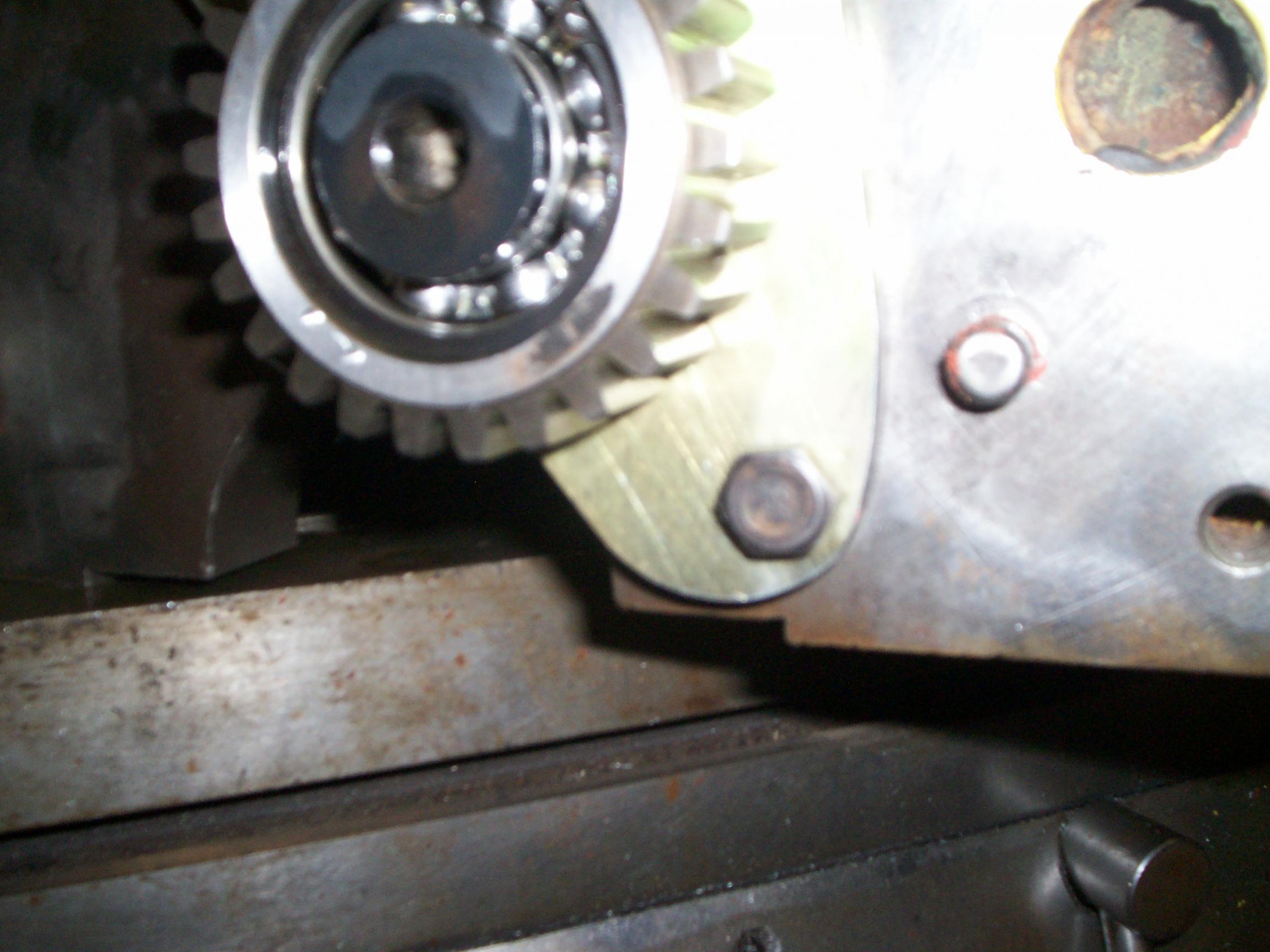

    I just got done modifying a 318 camshaft gear drive for my 341 Desoto. Wasn't too hard. The cam is a roller from Contrerras. Unfortunately the roller lifters were too short and I ended up grinding a bit of material from the lifter crossbar and milling some of the lifter gallery top until the crossbars had about 1/16" clearance from the top of the gallery. The front of the cam jounal acts as the thrust bearing against the 4-bolt plate on the front of the block. S far-so good. Unfortunately the hole in the plate is only 1-5/8" in diameter and was too small for the snout on the back of the cam gear. I ended up boring the plate to 1.800" to clear the snout. This leaves only .100" all around the edge of the plate to act as a thrust bearing, but with good oiling it should be enough. The gear went on OK, but sat in too far and the gear locked up against the bolts holding on the plate. I made a 1/8" shim to sit behind the snout which not only kept the gear off the bolts, but also put the gear dead center on the idler gear. Next I had to drill and tap a 5-15' X 18 hole near the bottom of the block to attach the lower end of the idler gear plate. Before drilling, place a piece of newspaper in between the gear teeth which will give the proper clearance between gears. The idler gear bearing is recessed about 3/8" inside the gear and looks to me like it would run dry without some direct oiling. I added an oiler to the front of the timing cover. The oil will exit out a .038" nozzle and squirts directly on the bearing. I think it will work out well.
