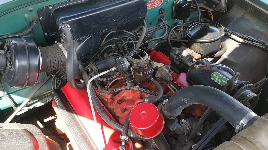

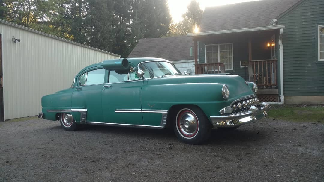

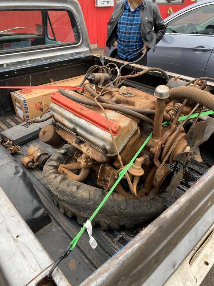

    Hi everyone! Decided I’m going to start a build and I’m going to need some help. A year ago my wife and I found out we were going to be adding a little to our group. So I sold the two seaters and picked up a 1953 Desoto fire dome. I’m personally not a Chrysler guy but something about the car got me and we dig it! Learning a lot of new tricks and how the fluid drive works lol. Anyways... when I got it the previous owner had put 5w20 in the 276 fire dome :( so that’s the first thing I did was change out to some proper oil but the damage was already done! It ate the cam and sprung the crank. Now being that I love old stuff all my friends tried to get me to put an ls in it. No good for me lol. So I was able to find a 330 tall deck fire dome. Currently in the presses of rebuilding it. I’m planning on still using the fluid drive three speed as I have the paperwork of it being rebuilt up at Portland transmission. I’m looking to see what other DeSoto owners are out here that could lend some knowledge:) I’ve been working on classics 1920’s - 1970’s for about 15 years now. But never a baby Hemi. Here’s some pics and I’m looking forward to sharing our journey with you all. IMG_1499.JPG IMG_1497.JPG IMG_1499.JPG IMG_1500.JPG IMG_1501.JPG IMG_1502.JPG

    I can't see the backside of the replacement engine, but I'm pretty sure it has to have the large casting off the back to accommodate the the fluid coupling. I ran into that trying to put a 54 Chrysler engine in a 53 Chrysler.

    according to me tap it should work. its a early 330 but we will see. otherwise ill have to put an auto behind it.

    Don't think DeSoto or Dodge engines ever came with the extended bellhousing cast on. I put an iron Torque-Flite on a 53 Dodge. Straight bolt on.

    Why does it have a Mercury grill in it?

    I think that’s the first time I ever saw a DeSoto grille in an actual DeSoto. Cool! It will make great memories for your kids.
