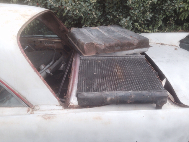

    I went to look at this desoto but the owner does not know the type and year, so i took some pictures with my phone and hope to find out more info abouth the car this way.
    I'm still not sure if it will be a parts car ore a project car.
    the problem: broken windshield, no front bumper and as you can see dis***embled.
    i think it is a 58 firesflite, but it would then have to be a 361 no?
    [​IMG][/IMG] [​IMG]

    The car itself is a 1959 Desoto.
    The body style is a two door Sportsman, which is Desoto-ese for "hardtop."
    It has the tall back window, which indicates it is either a Fireflite, which used that gl*** as standard equipment; or it could be a Firedome, which could have that gl*** added optionally.
    For '57 and '58, Fireflites were 4-barrel engines. Seeing that 2bbl intake makes me think this car is a Firedome. Look at the body tag. It will either be on the radiator core support near the p***enger headlight, or it will be on the p***enger side cowl. Take a picture or jot down the numbers and we can decipher the body code.

    Unless it is really cheap I would walk away. Most of the hard to find parts are already gone.

    Actually, all of the very best Desotos are in Europe. The Scandinavians just love them. The body looks rust free. If I were you, I would buy the car if it's a good price. I can put you in contact with a couple of people that will buy everything you're willing to sell.

  19. The windshield can be had easily, all 57-59 Mopar convertible and hardtop have the same opening, although there's a couple of different windshields. The rear window is the one that will be a ***** to find. It might literally be easier to find a convertible donor and change it over than to find that gl***. I found one some 10 years ago and a guy drove from Michigan to NY to get it for his Chrysler 300. His? Broke somehow while out for the car to be painted. Probably had a chip in it.

    I just called the owner for more info! He has the back window but no exterior chroom at all! So it is a donor car i told him! He say he drove the car last year home when he bought it! I say with no bumpers and chroom and a broken front windshield? Yes he say!

    If you could buy it reasonable it might be possible to make a car out of it but not to restore it to original. A lot of custom cars start out the same way. They need too much work and it is not practical to get the original parts.
    Here is a similar car that got the full custom treatment. Note that almost all the chrome trim has been removed, and the grille replaced with one made of chrome tubes. See how nice it looks? You don't have to chop the top.

    I went to pick up the car this week.
    he had the rest of the parts at a different place so I have to go back again for the rest of the parts.
    rear window in good condition.
