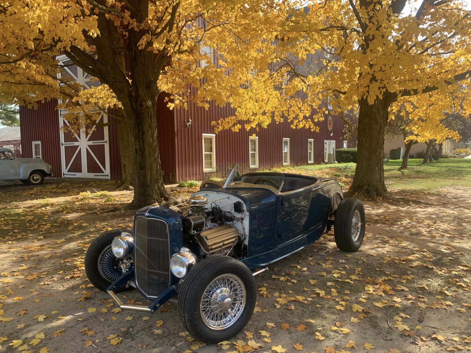

    Cold, rainy fall day question: I just p***ed on an Edmunds 2x2 BBL intake for my little DeSoto Hemi. Carbs, probably need rebuilt from setting, progressive linkage but complete. I offered the guy $500, he came back with $900, which is probably on the money, but I'm reluctant to spend that much for eye candy, and the thing runs SO good now with the original single 2BBL that I kinda don't want to rock the boat by adding another carb.
    Anyway, this whole escapade and near purchase did make me think about the brand new, still in the box E 1405 carb I bought several years ago for my Chris Craft 283 and never used. Hot Heads Racing (I've bought lots of stuff from them already for this engine) has new casting high rise, dual plane intakes for $650. I'm planning on a hood top, measuring the current stock set up with the E carb and adding the 1.5" they say this manifold is taller by, I'd still gain 1/2" to clear a hood. Right now the carb stud hits the hood top I made.
    I guess my question really is, on this bone stock engine, would the E-carb and intake make enough difference in performance to be noticeable? It's got a really TALL rear gear, 2.85's, and 30" rear tires, so it's no dragster, although it doesn't hold up traffic. The E carb doesn't have the "antiques" look I want, but I've been really happy with the others I've run, including 2 of them on and old Off 360 manifold on the 283 in the '34 roadster. I could still use the Stellings air cleaner on it, and under a hood top it'd be hidden anyway.
    So, spend $700 for the manifold and trinkets to make it work, or be happy with what I've got and get my wife something pretty with the money instead? 4BDAE6DB-B7F8-4735-A7CE-7B90DD15FA3F.jpeg

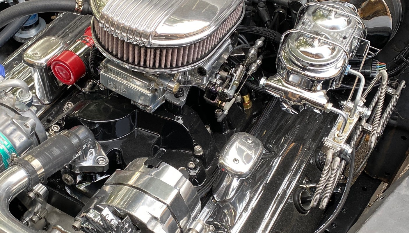

    Hey Brian, It is hard to make out in this pic but I bought the Hot Heads single 4 bbl manifold for my truck's DeSoto 330. Nice looking piece out of the box but I removed all of the casting marks, logos, smoothed it down and covered it in black ceramic paint. I have only done the 20 minute cam burn and another 20 minutes of drive time before tearing the truck apart for paint so I don't have a performance report for you...yet :cool:

    I'd forgotten you used one of them on your DeSoto. Yeah, let me know how it performs. My engine is completely stock, and like I said, it runs so nice now I'm hesitant to "improve" it much. ;)

    If it ain't broke . . .
  6. flynbrian48
    Joined: Mar 10, 2008
    Posts: 8,757
    flynbrian48
    The more I think about it, that sounds better and better. I'm glad I didn't hit the "Buy" ****on on the intake...;)

    Don't do it. The Hot Heads intake is very helpful to a built motor, but not on a bone stock engine. Furthermore, the 1405 carb you have is 600CFM, when the cam in that engine is designed for 370cfm, so you're over carbureting.
    Install the hood top and enjoy as is.
    If you wind up using the Edmunds dual carb intake down the road, that's a much more period correct setup for your car, though I'd probably still recommend installing a better camshaft to take advantage of the added carburetion.
