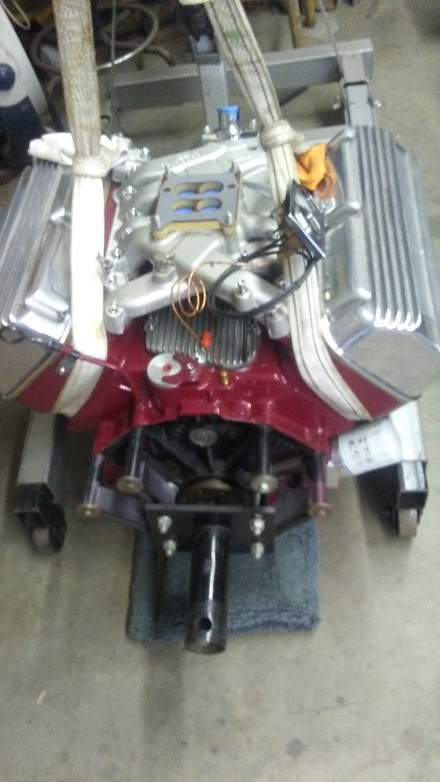

    Yeah, but finding a 4-bbl oem is not an easy task nor a cheap one. The usual problem then is using too large of 4bbl. Ya gotta remember that 276 inches, 7.5:1 c/r and crazy mild cam spec really prefer a small 2-bbl.

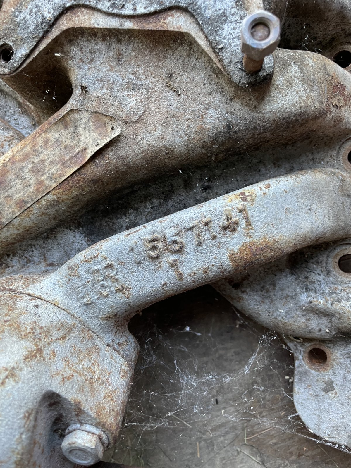

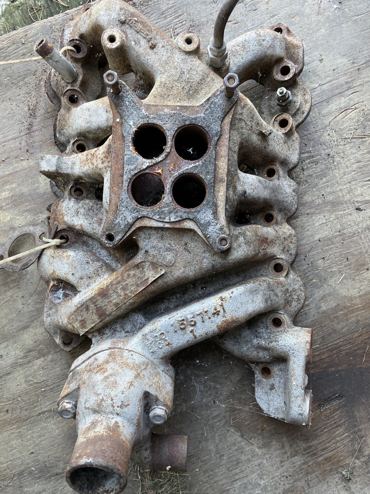

    My friend has this manifold from a DeSoto, I’m sure he would sell it fairly if you’re interested. 298D4DBC-85E2-4511-879E-2767C12B9400.jpeg 1D5EF68C-4ACF-48F7-8B76-043B7C1DD836.jpeg

    George
    That would work. Also, millions of 2 bl engines from the Big 3 have had 4 bl swapped on w/o ant other changes (cam, C/R, ect.)

  13. ^^^^^^
    That manifold has the exact same casting # as my avatar,,,,it’s genuine .
    1955 291 .

    Get the intake, the HH squeeze plate, probably a phenolic spacer, longer carb mounting studs & a 500 Edelbrock....

    If the engine is truly a 276, consider:
    DeSoto used no 4-barrel on the 276 (at least, I have no record of one).
    DeSoto used a four-barrel of approximately 375 CFM on their 291.
    DeSoto used a four-barrel of approximately 475 CFM on their 330.
    Plymouth did use a four-barrel of approximately 375 CFM on the 276.
    The Plymouth 4-barrel would be an excellent choice unless you plan to spend weekends at the drag-strip. (Then it would still be an excellent choice).
    Jon

  22. Jon ,
    You are right,,,,,276 was 2 barrel only .
    The 291 was in 1955 and it came with a 2 barrel,,or 4 barrel depending on the setup .
    If I remember correctly the 4 barrel application was only approximately 10 % of the total production in 1955,,,,,so those intakes are sort of scarce .
    But,,,I’m sure it would work alright on a 276 ,,,with the correct carb size .
    Tommy

    Using the 291 four barrel intake on the 271 should work fine, with a small carb.
    I installed a Ford 289-4V intake on a 260 with great success. After a couple trials, I found that a Holley 370cfm (sic) carb gave much better low to mid range power than a bigger carb. I couldn't notice a difference at high rpm.
