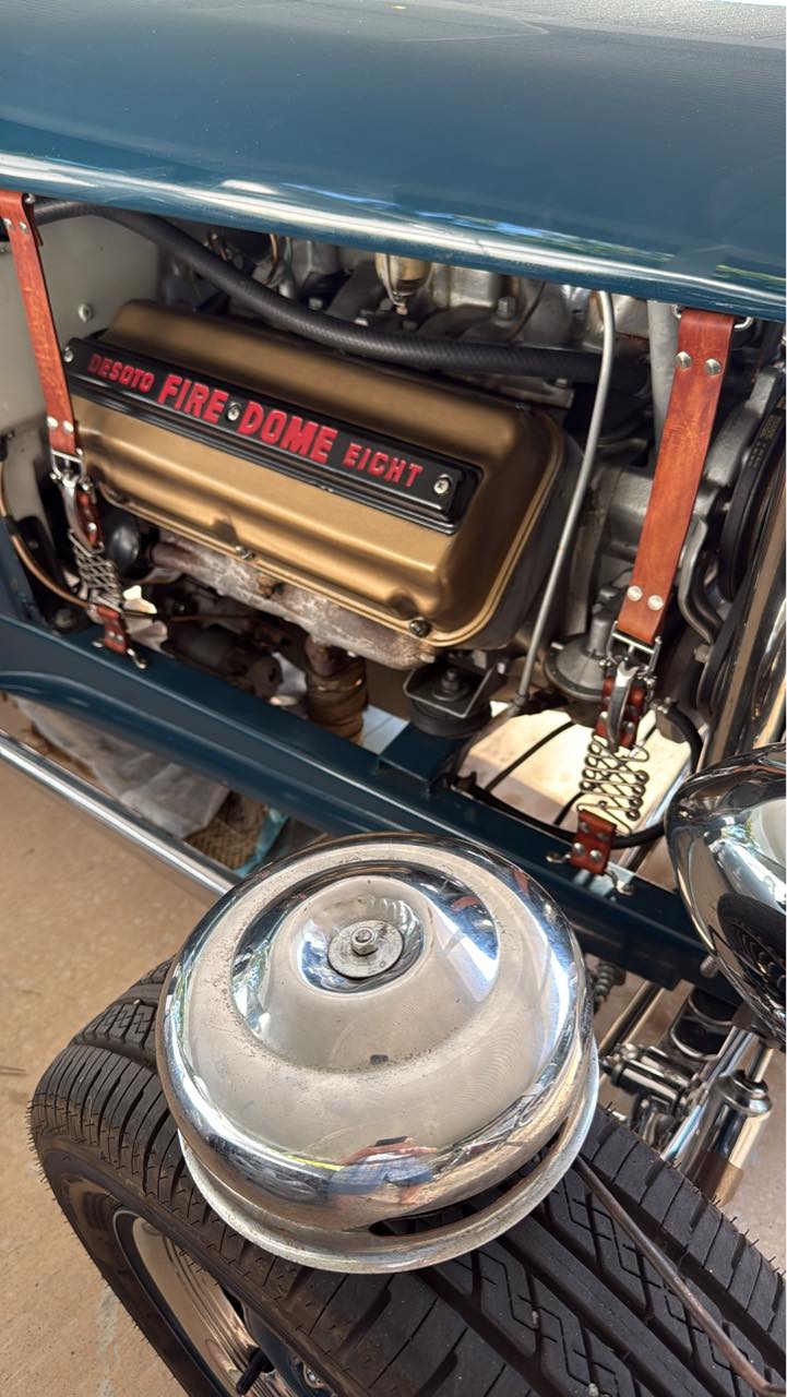

    This is my happy face after getting the little DeSoto running properly in the Model A (picture 2 83FBAB61-08AE-468B-9CCF-568DBE570BF6.jpeg 72715B71-B8EB-44D0-9F0A-8771346664C6.jpeg )! I'd bought a rebuild kit for the carb thinking that the accelerator pump wasn't working right in the original 2 bbl carb, and had time yesterday to get after it. Before I pulled carb, I pulled the air cleaner off and cracked the throttle, gas squirted in both throats, so I held back and gave it some thought.
    Someone had suggested that the cause of it stumbling off idle might be the advance in the ignition, so before I tore into the carb, I checked that. I don't have a timing light here, so I loosened up the distributor hold down and gave it a little, then quite a bit more advance. The idle speed went up, the engine smoothed out, and I gave each idle jet a quarter turn. It still didn't kick back against the starter when warmed up, so I bumped it ahead until it did and back it off until it didn't.
    Taking it for a little test and tune around the neighborhood, it now runs markedly better, throttle response is much quicker and best of all, no stumble. I think I hadn't snugged the hold down clamp enough and it'd moved after 3 seasons of use. I'll just keep the carb kit until I really need to do that, but for now it's a real treat again to drive.

    Yep. The poor running happened gradually, culminating last summer when the distributor cap got wet and the contacts corroded. It ran terrible, I replaced the cap and wires, which made it at least fire on all 8 cylinders, so comparatively, it ran good. Once we got down here, the stumble got progressively worse and tried to compensate by richening the choke. That lead to more problems, but I stepped back from it, and with some help from here, looked at it with a fresh perspective. All better now.

    My wife followed me home from Venice today, and said the car was smoking black smoke at whenever I accelerated from a light. I couldn't see it of course, so I dialed the choke settings WAY back. It seems to be running a bit better since, and I can't SEE any black smoke, so we will see. Still starts easily warm or cold, and no stumbling, so I think I'm headed in the right direction.
    She also said the brake lights worked only about 75% of the time, so I fixed that too. There wasn't enough free travel in the pedal, and the mechanical switch was adjusted too tight, so that when I simply slowed, no brake lights. They came on with a firmer stop, so I gave the pedal a little more free travel and backed the switch off so it closes as soon as the pedal is moved. In the congested traffic and brain dead, inattentive drivers here in Sarasota, having brake lights that work intermittently is not good.

    Update: After a week of running great, it started the same flat spot off idle when moving, stumbling, popping and generally running poorly. To compensate until I could rebuild the carb I bumped the choke adjustment back until it was about 1/3 closed which helped, but obviously made it run way rich. I had gotten a carb rebuild kit that, after it seemed to be cured by advancing the timing alone I hadn't used, so I pulled the original carb and went through it. The carb to intake gasket was VERY brittle, had a visible break in it, and all the other gaskets in the carb were brittle as well. I bought a can of carb cleaner, took it all apart, replaced the needle and seat, all the gaskets and put it back together. I think it must've had an internal vacuum leak in addition to the base gasket, because it runs good now. No black smoke, choke open, nice crisp throttle response and it's not embarr***ing to cruise around in. ;)

    The never ending story continues: The car ran fine for a couple days after rebuilding the carb, then again started running awful again. Figuring the carb again was the culprit, I ordered an Autolite 2 bbl (a knockoff but I figured I'd take flyer on one as it was inexpensive) and an adaptor from Hot Heads to bolt it up. The carb came today but still don't have the adaptor, so to entertain myself on a sunny spring day, I decided I'd install the choke cable I'd bought a while ago and get rid of the automatic choke, since one of the problems I found was it doesn't work properly.
    Did that, jumped in and took it around the block, sans air cleaner. Ran absolutely perfectly. Came home, popped the air cleaner back on, around the block again and it ran as poorly as it did before, smoking, popping and stumbling.
    Finally, a light bulb came on. I stopped in a parking lot and popped air cleaner back off. Ran like ****d ape again. No black smoke, no stumble, no popping, just great.
    So, by process of elimination, after all this eff-ing around, it's the stupid air cleaner.
    Now, do I just leave well enough alone, keep the new carb and adaptor (when it finally shows up) on the shelf for posterity and focus on getting a better air cleaner for it? It's an old Stelling and Helling top on (part of) the original oil bath base that clamps on the carb throat, with a small paper filter under the chrome lid, or swap cars and put a proper air cleaner on it? I'm gonna just run it around town for a bit without one, just to ensure that it KEEPS running right... 2612E3E7-AB0D-433B-A561-966E92BADA8B.jpeg

    Can we see the inside of the air cleaner?
    What's causing the lack of air flow through the air cleaner?

    That's kinda my thought too. We don't have dust and dirt roads, although it's pollen season, and it gets actually driven so seldom it may not be worth worrying about.

    So, no photos of bottom and inside of air cleaner? We might all learn something.

    No, but I did put the base and the top cover on without the old element. It runs like a watch. So the element is definitely the culprit here. Sometimes the obvious answer is overlooked until new more money than needed is spent. ;)
