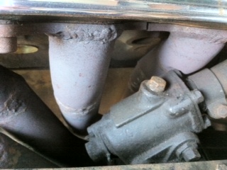

    What I have is a 276 that was built by my Dad for drag racing in the late 50's. The coupe sat for 45 years but is now back on the road. I'm not surprised that after a 120 mile rod-run last weekend that now I have a blown head gasket. Problem is that you can see from the pic's that the home made headers are a "little" tight. I'm guessing the motor needs to come out, if that's the case then I want to make this old motor run on pump gas. So my question to you guys is what in you opinion needs to be addressed.

    i dont see why you would have to remove the motor to change the head gasket, yes the headers are snug but the heads will be pulling away from them as you lift them up.
  9. 73RR
    Joined: Jan 29, 2007
    Posts: 7,344
    73RR
    This, in theory, works but only if the header is attached with bolts. If studs are used then the header will have to move to clear the stud.

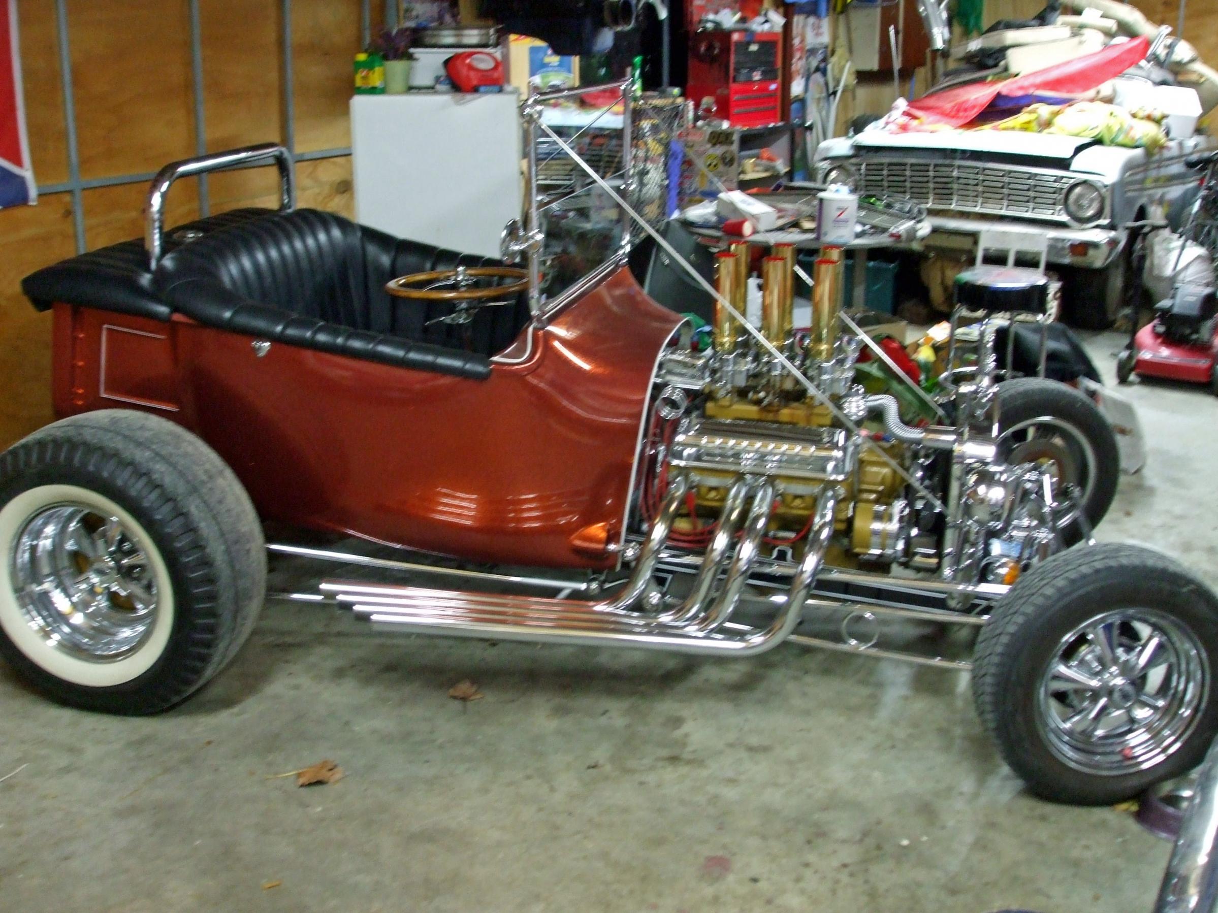

  16. Just shot down to the garage and snapped a couple of shots of it sitting a****st the mess. Check my profile page in a few days an I'll upload some good ones. Shortened 1919 dodge cowl with a shortened 'T' bed and owner built rest, 312 Y Block, glide trans and a '57 chev rear end. It was originaly running an open drive banjo rear end with a transverse 'A spring and '39 juice brakes all round. Im working on putting it back to that way now.

    2 very very cool old rods.
    I'm jealous of course.

    Nailhead, very cool T!!
    looks bad-*** but I could see why you'd want it back the way your dad had it. thanks for puttin up the pic's
