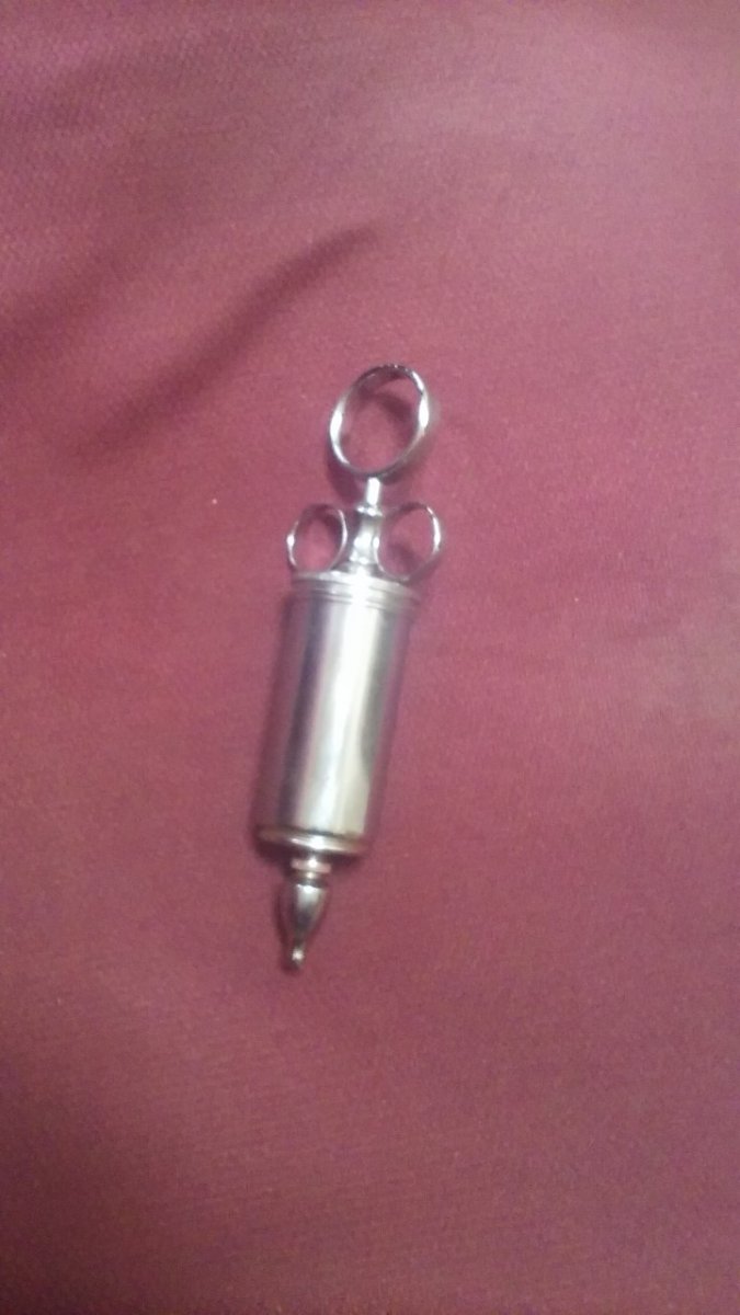

    I fill a large metal syringe with paint and flow it into the recess and then carefully manipulate the piece and let gravity due the work. Have done dozens of parts this way and never had a problem running over the recess. Just have to be careful. Bought syringe on Ebay for 5 or $10 syringe.jpg syringe.jpg syringe.jpg

    PS sometimes you have to help it flow a bit with a tooth pick or brush
