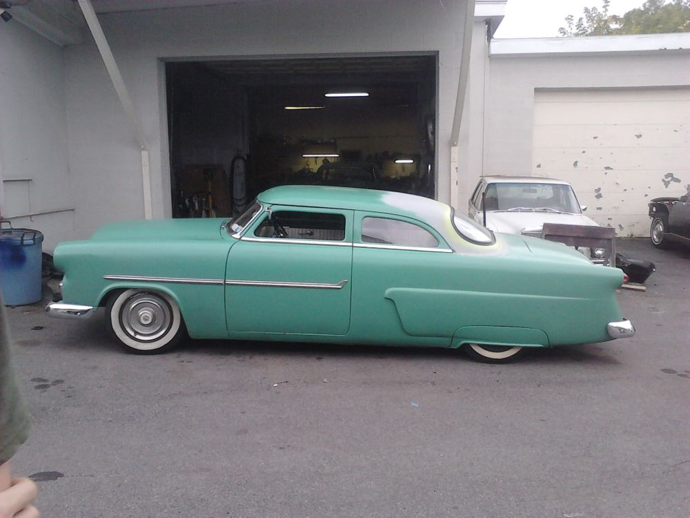

    after realizing that the back window made the roof have sort of a flat spot i decided to sut out the back window and put a 50 merc rear window to give the roof a better flow
  4. bottledViolence
    Joined: Feb 19, 2009
    Posts: 172
    bottledViolence
    the window JUST fit in the roof and really changed the whole look of the car with only a few small filler peices

    next i had planned to drive the car to the cleavland rumblers show and 2 days before the show i decided to pull the motor/trans out of the car and chane the th350 to a 7004r so i could go over 60 on the highway and i had everything back together at 9:30pm and hit the road

    these are really hard cars to chop, but youve done a great job at it. i had a 54 myself. *****in cars

    i drove about 3 1/2 hours down to PA. to meet up with some friends and then we all drove about another 6 or so hours to cleavland and at the show i won a clubs choice award from the lead kings. all together put about 1600 miles on the car on the trip with no problems. over the winter im gonna block out the body,respray it and do a c notch/dearch the rear springs ands drop the front another inch or 2

    I actually forgot its a four door sedan while looking at the pictures.

    I have to admit I wasn't a fan of the first back window but I respected using what you had at your disposal. Awesome car.

    Wow man, nice work all the way around. I had a 52 that I wanted to chop BAD. Never saw one that really looked anything but "different" so I never went for it..... That Merc rear window looks perfect!! The fact that it started life as a 4-door made the dimensions look better once chopped I think as well. Great job!

    customs just aint my thing but i gotta hand it to you you have just about changed my mind. i love that car! when you turned her into a 2 dr and used to 4dr doors i thought heres a screw up, sorry i was dead wrong ive never seen one that worked but it sure works onthat one.with a shorter door it seems to give the rear a long sweeping look to it and i like it alot! wanna come a destroy a car for me? i got plenty you can destroy.just take your pick! lol.and that cant be your first chop.from the looks of that car you must have done a few before! all i can say is wow...

    So glad you changed that back window. I really hated the first one. Since you need to repaint it, I think it's screaming out for 2 tone. Maybe a cream roof, or maybe dark green.
