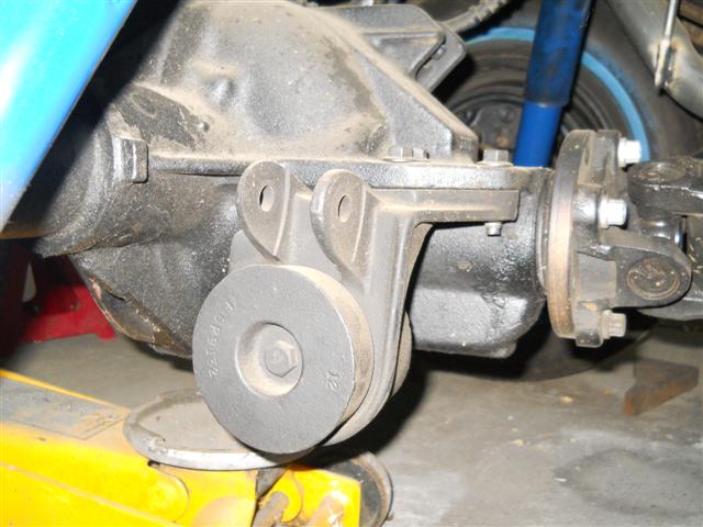

    since you will have the rearend out (Springs & Shackles On My 54 Ford - another thread on this car) you will be able to take better photos and look for any numbers to help identify. pics of (8.8 Ford-year/model?) rearend in my '54 Ford sedan. just found this to help id rearends:

    With that type of yoke its definately not a 70s granada rearend and it looks to be a 8.8,it could be a explorer rearend.

    Nope. Housing is wrong. The part of the center-section, where the axle tubes are received, is way too short. Not a Ranger or an Explorer 8.8. Look at JalopyJoker's first picture. That is what a Ranger or Explorer 8.8 looks like.

    Me bad as I thought the latest pictures were of the rear end in question.

    Given the size, shape, and stamping profile of the cover, I am guessing something in the 8 range, rather than 7, as the cover is a dead-ringer for the steel cover I just put on a Ranger 8.8, for my Falcon (to replace the plastic one), but the center section casting is different.

    Hate to say it, but might be best to just pull the cover and get the part number off the ring gear.

    the 8.8 in my '54 has these numbers on center section facing drive shaft: FOTW-4025-AA (F maybe a 6?) and nearby on housing : 13W. any ideas how to figure out what these codes mean? there is no tag on the inspection cover. if I had that I could possibly use info at: www.therangerstation.com/tech_library/axles.html

  27. After seeing the from of the axle it appears to be a spicer rear axle,it very well my be the original. HRP
