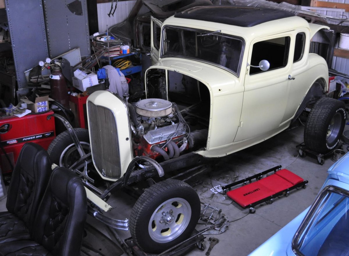

    Give them an update on what's happening. Show some pics of the parts pile.

    I don’t want to scare them!!! But you asked...

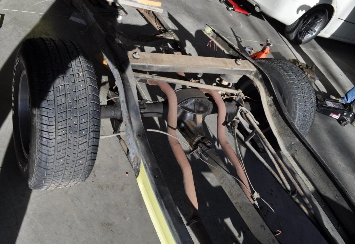

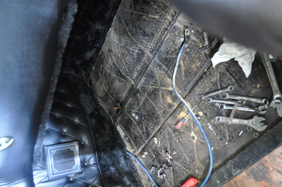

    Some of the fabrication methods from 45 years ago aren’t quite up to today’s standards. So I’m going to make it a little, make that a lot, safer and user friendly. So some things have to go.

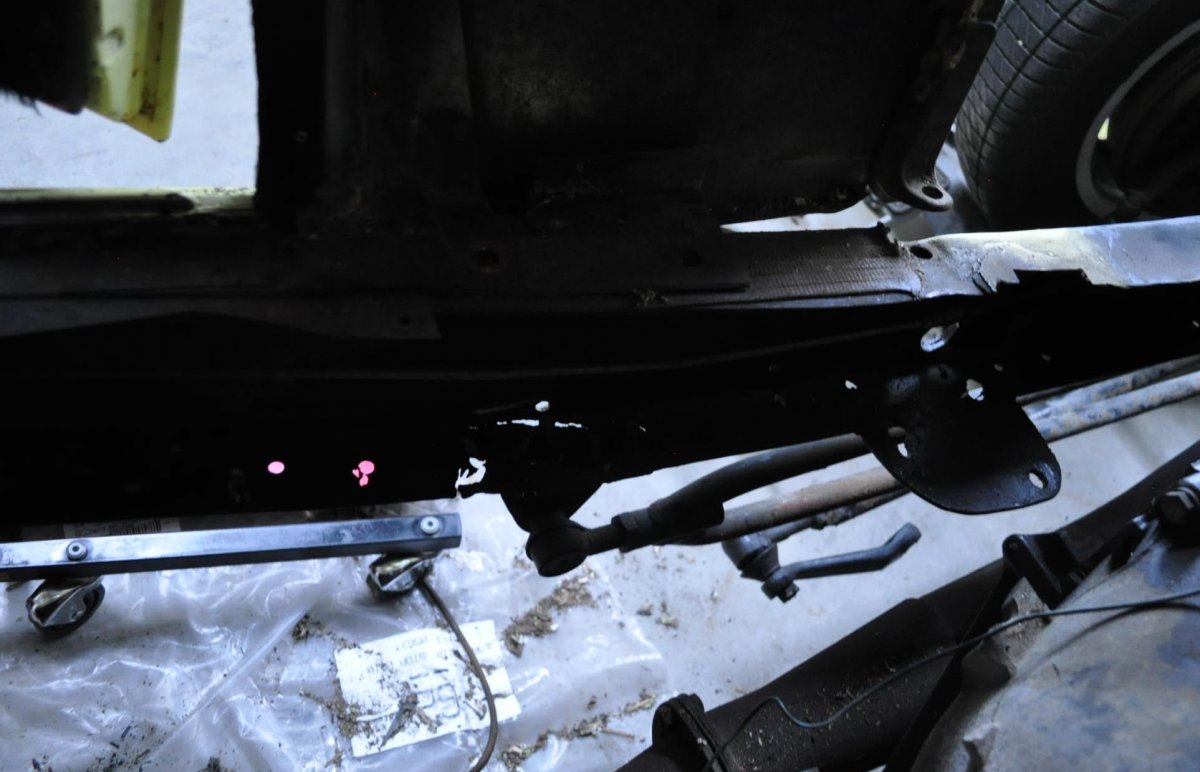

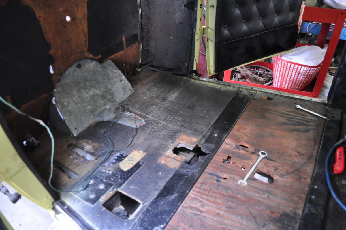

    Here are some pics from a few weeks ago. Notice the 4 bolts in the square pattern on the wooden front drivers floorboard? That’s the master cylinder mount. The brake pedal was in the slot just in front of it and it too was mounted to the plywood floor.
    At least the rear floor is nice and solid.
    Maybe tonight I’ll take some pics of its current state.

  4. Shows ya,
    not always the "good old daze"
    Denns1989 and kidcampbell71 like this.
  5. Runnin shine
    Joined: Apr 12, 2013
    Posts: 3,383
    Runnin shine
    Wow! Shows what a well padded interior can hide. I especially like the rustic firewall and galvanized trans bulster. I still can't wait to see it brought "back" to as "then".

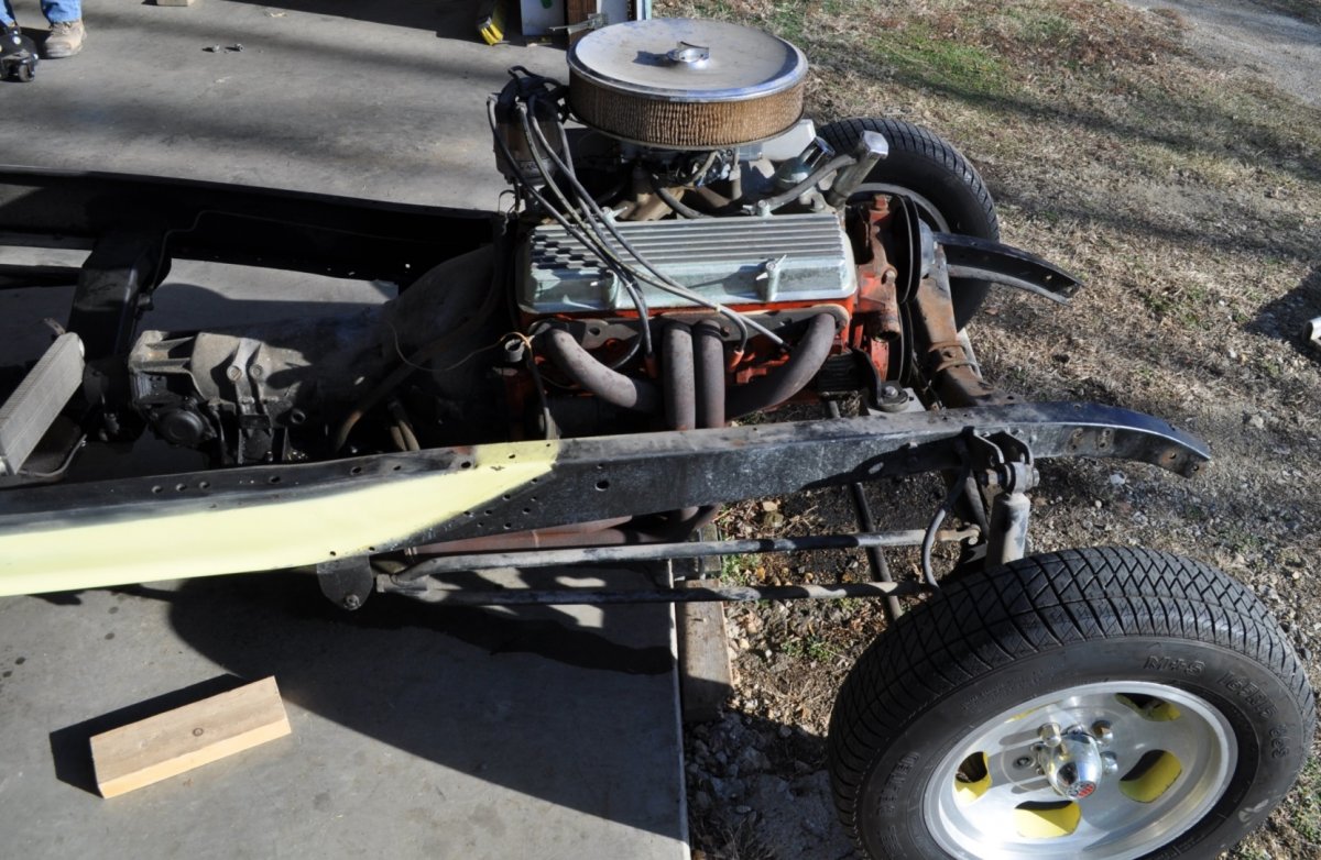

    There is evidence in the plywood floorboards as well as leftover motor mount scars on the front frame that the car had some other engine in it besides the original 4 Cyl and current 327. I’m thinking it might have been a flathead. Now if it was a hot rod at that time or simply an upgrade over the 4 banger it’s impossible to tell.

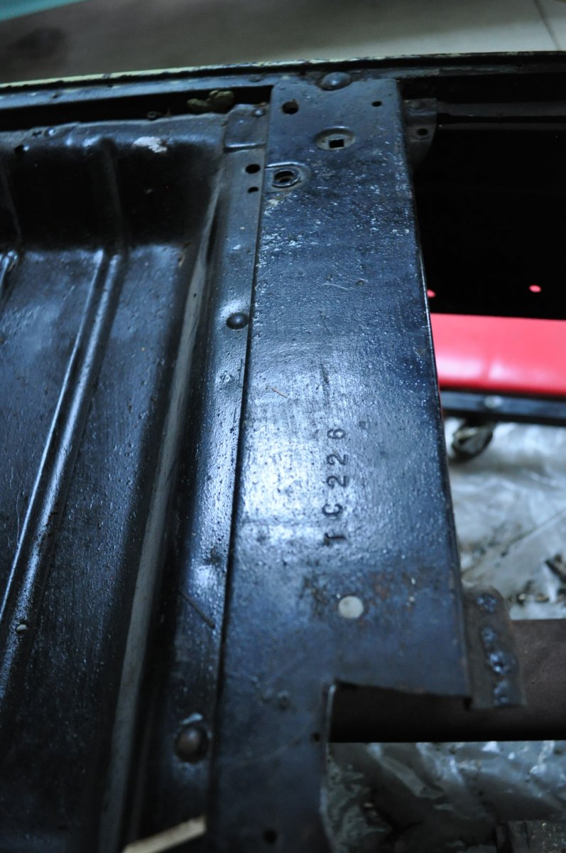

    This has turned out to have an excellent body on it. I can’t find a lick of rust or damage anywhere. The subfloor and frame don’t have any pits whatsoever, so it’s been very well taken care of. Stamped on the front subfloor cross brace is the code TC226, which means it was the 226th Coupe body to be manufactured at the Twin Cities (St Paul Minnesota) factory. Which is really cool because that is the same factory my ‘32 Truck came from. Both the Coupe and its brother are early production models probably made within a month of each other. I wonder if any of the same factory workers had a hand in building both?
    This Coupe needs some ch***is work that trying to do upside down underneath would just be insane. So I’m pulling the body off to allow access to do it right. That will make it so much easier and I won’t have to worry about damaging the body paint or interior. Right now all the fenders and boards are off and all but 4 body bolts have been removed. It won’t take much more before the body can come off. I have also removed the plywood firewall which will be replaced with a steel one so I can hang a pair of Ansen swing pedals. In one of the pics attached you can see how the hairpin mount has cracked the bottom frame-rail. The frame also has cracks along the top near where the steering box was. Both reasons to pull the body & fix it right.

    Look at the cracks all the way around that hairpin mount! I think you still have time to order up a new frame with Heidts independent all around. ;)

    one of my 32 five windows is a TC coupe, ill find the number off it.

  14. Wow, that is a lot of daylight around that hairpin mount! Great score, I am digging your path! I won't comments on the idgits that took the bait ;)

    Got home a few hours ago looking like I had rolled in coal dust. Spent the afternoon wire brushing gunk off the frame of this coupe so we can make some well-needed repairs. There were a few cracks, some poorly designed brackets, and a transmission mount to replace (4-speed going in to replace the automatic). Big things to come this summer!
    Gotta add though that this is the cleanest (other than paint and grease) old frame I've ever seen. There were about three square inches with a few rust pits, on the bottoms of the side rails where the runningboards trapped a little moisture. Totally unlike any other midwest cars found these days. Hard to believe this car was built in the Twin Cities and lived in eastern Iowa or western Illinois it's whole life.

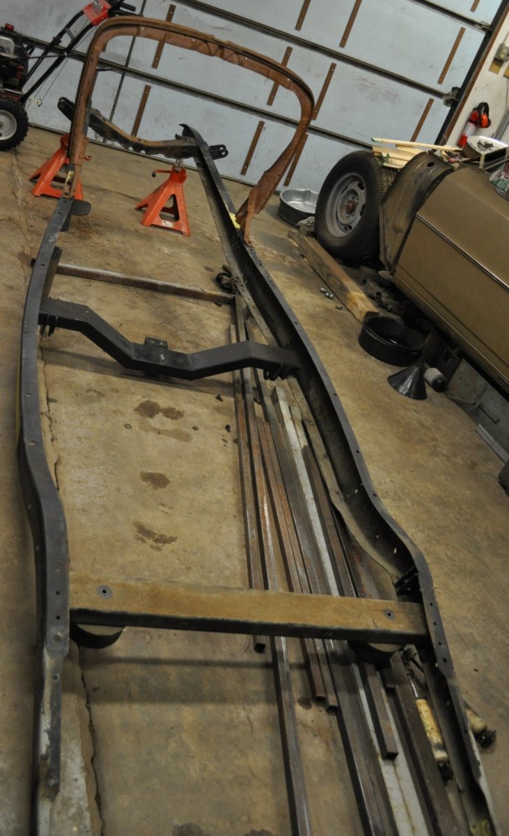

    As Alchemy said, we have slowly been working on the Coupe. Here’s the latest. The body has been removed from the frame and the frame has been stripped bare.
    After some measuring, it was determined that the rails were twisted such that the bottom was too narrow and the top too far apart. The only way to remedy this was to cut the heavy center cross-member out and twist the rails back to shape. When the cross-member was cut out, the frame kind of remembered where it was supposed to be, but needed some extra persuading. We bolted in a stock center cross-member and made cross bars to bolt in across the upper body bolt holes as well as the lower running board holes. These will be left in place until the front and rear boxing plates and a new center cross-member can be installed. We have straightened out all the edges of the rails, made a patch for one of the cracked out areas, and begun welding in nuts that will be hidden by the boxing plates.
    Since I am replacing the TH400 with a Muncie 4spd, the tail mounting would have needed to be changed anyway due to differences in length, so making a new cross-member is really no big deal. Plus it will give me the chance to add some K or X legs to beef it up as well as correct some alignment issues with the front ladder-bar mounts. The fabrication of this is probably what we will be doing next weekend.
    Here’s some pics of the body off the frame and frame stripped bare. (No fab shots yet).
