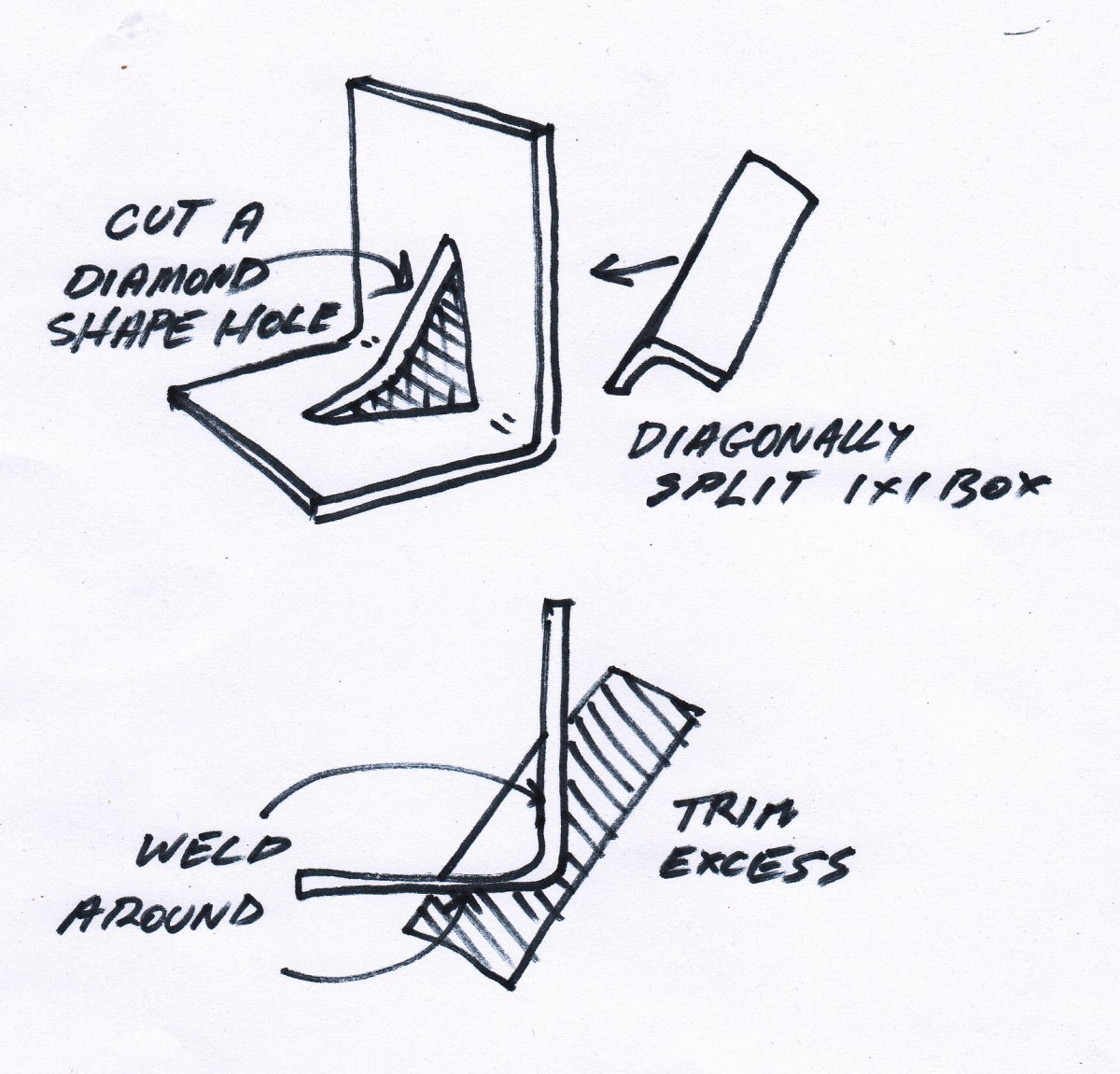

    Ah, I didn't expect it to be two pieces which is why I was interested in the process.
    Thanks for the photo, and good job making it look like one piece.

    Ha ha...you didn't think I had some giant press or anything did you? :eek:
    I am basic. :)
