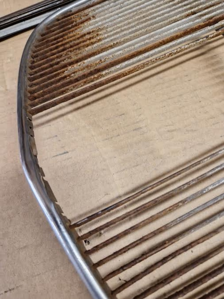

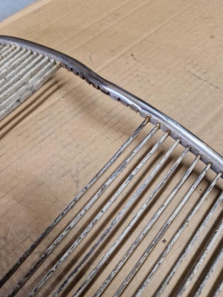

    Anyone have tips or advice on how to best straighten stock steel 32 grille bars? My insert needs some help and I could not find any threads on this topic.
