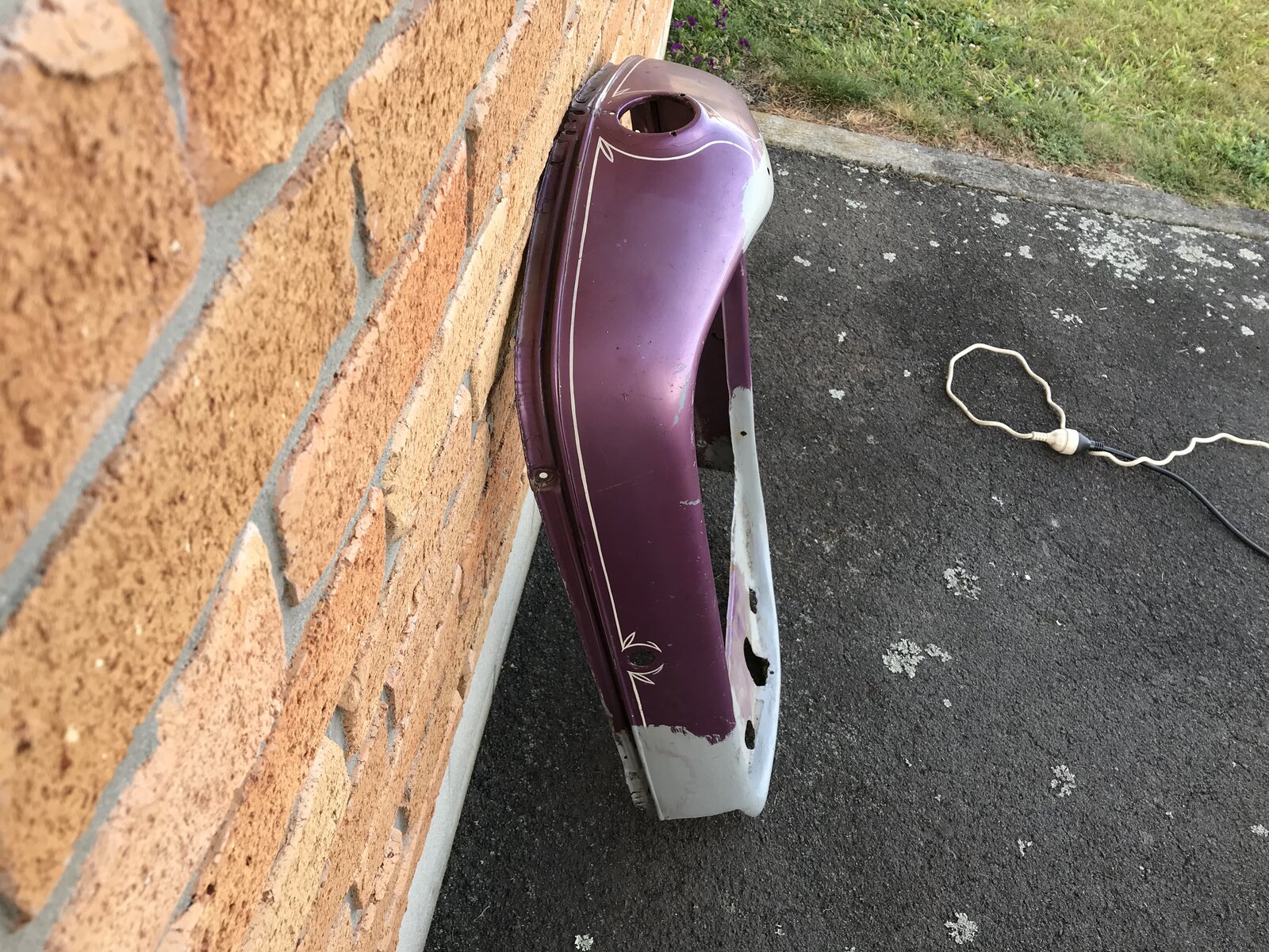

    Probably a little late to reply, - I missed it first time around....
    The ‘32 was built in 30 different factories, different countries - no computers, just drawings for tooling/stamping etc. - there was bound to be discrepancies.
    I have a few uncut grilles and some are a different shape and one is even 3/4” longer/taller.
    We cut two up, to make one good one, painted it without realising that the shape was different, and now can’t make either insert fit, so it will have to be a custom made insert.

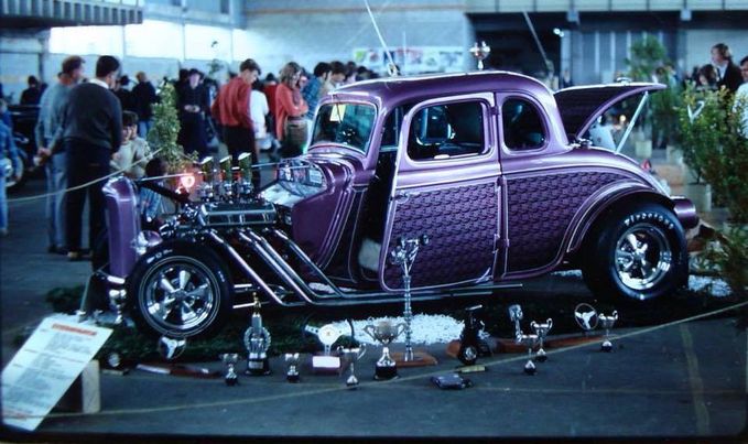

    the grille below was on a well known NZ hot rod back in the ‘70s, and last year I put it back on a ‘32.
    I had intended to take the better one off my fordor, but it hit the headlight bar. When I made the headlight bar, I set it up without the insert in, and when the insert was fitted, it was too close. The purple grille has had the bars bent from hitting something, and fitted perfectly.........they won’t be straightened anytime soon !
