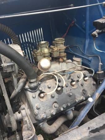

    Got a call from Vern Tardel a couple days ago that he needed a few parts to finish putting my engine together. What started out as a stuck valve has morphed into a complete rebuild! He said while it was apart he "might as well put bearings and rings in it.... The balanced is real good in this one..... That's a Merc crank... want me to bead blast the manifold? Do you have carbs? Drop those off and I'll go through them...... I think we'll be ready to start it Monday"!!!!! It's also got a new Melling oil pump and a milder cam. No identifier but he said it had a hell of a lift.
    I have been sooooooooo fortunate having Vern taking an interest in my engine and making sure that my truck will be a great runner for many years. DSC01473a.jpg DSC01474a.jpg DSC01475a.jpg
    cactus1, kidcampbell71, brEad and 4 others like this.
  21. Woodster
    Joined: Nov 14, 2012
    Posts: 179
    Woodster
    from NorCal
    It's alive!!!! Engine was fired up yesterday and ran a couple hours so he called me this morning to come listen to it. It's music to my ears and I can't wait to get it into the truck
