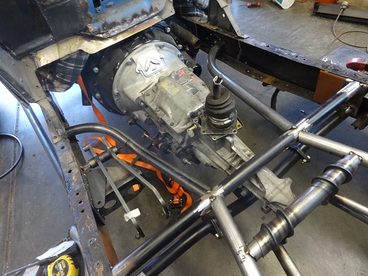

    Fun fabricating day..... happy to get to where I could start making stuff. Made the first pieces for the crossmember and the removable trans mount. I bought a Speedway tubing bender ten years ago for some project but never used it and once I 'clearanced' it a bit it worked perfectly. I'm going to box the portion of the frame ahead of the running board mounts. I just have to make the trans mount plate and this piece of it is done.

    While designing my trans crossmember I wanted to use the same sort of design as the original, fastened in several places, spreading the load and stresses around the frame. I bought a press brake (coolest tool I've bought in a long time) to make the mounts that slide inside the frame rails which will be bolted in before the tubular cross pieces are welded to them. I'm going to run tubes forward to plates that will bolt to the same locations as the stock Ford legs and two more going back from which the front mounts for the ladder bars will be attached. On a roll!!!!! DSC01669a.jpg DSC01670a.jpg DSC01672a.jpg DSC01673a.jpg DSC01674a.jpg

    I'm using 1 1/2", 1/8" wall tubing. It's the same size as the Pete & Jakes rear bar mounts....

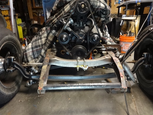

    Put the front end back on the ground so I could see the ride height. A wee bit higher than I wanted but there are still parts to go on that will bring it down a bit. I put in a dropped crossmember and a reversed eye spring do drop it along with the existing dropped axle and it's a couple inches lower than it was.. I want to drive this a lot so it can't be toooooooo low.
    With regard to the radius rod tie rod tabs on the frame..... are they just welded to the frame? Seems there's a lot of force on them.

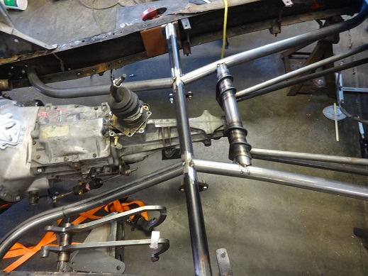

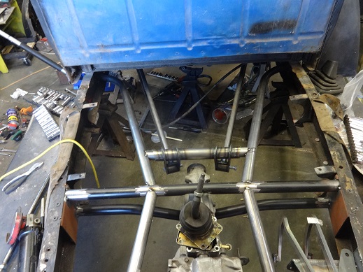

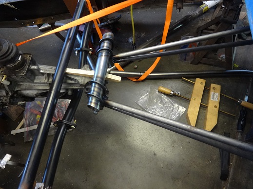

    Big couple of days on the truck.... got the rear end in and located, ladder bar mounts tacked on and then the front mount. I have been thinking about this X-member for a while and once I got going it was pretty easy. Everything is tacked in place, now I have a boat load of welding to do. Gonna do the exhaust too while the cab is off.
    Pretty happy with the results. Amazing what you can do with a tubing bender and fishmouth cutter.

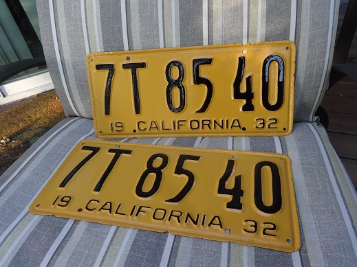

    I picked up a cheap set of plates on eBay and checked DMV, hoping they were clear. They were and the kind clerk let me put car plates on a truck. I painted them and gave them to a friend who's an amateur pin striper and offered to letter them. Very happy with the results for an investment of about $60. Just need to find the right license frame to cover up eighty five years of abuse on the edges
    . DSC01764a.jpg DSC01765a.jpg DSC01766a.jpg DSC01767a.jpg DSC01768a.jpg DSC01763a.jpg

    Beauty! My first running hot rod was a '34 Ford Pick up in 1971 but it had a '33 cab, no extra bump across the back. My front end is nothing special..... SoCal dropped crossmember, Posies reverse eye spring and the dropped axle that was on the truck which I think is dropped about three inches.
