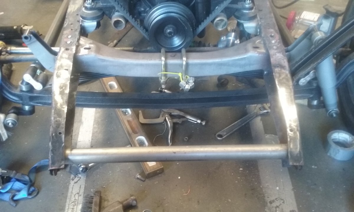

    Once I had torn the truck down I noticed the front frame horns weren't square or level, probably ***ociated with the previously repaired bent front axle. The frame horns were bent about an inch to the p***enger side and the driver side was 3/4 of an inch down, evidence of a left front impact.
    I spent about an hour and a half with tie down straps and a lot of heat to get the rails straight and even more heat and a floor jack to get the left rail bent back up where it belongs. Everything is now within 1/8 inch of where it belongs.

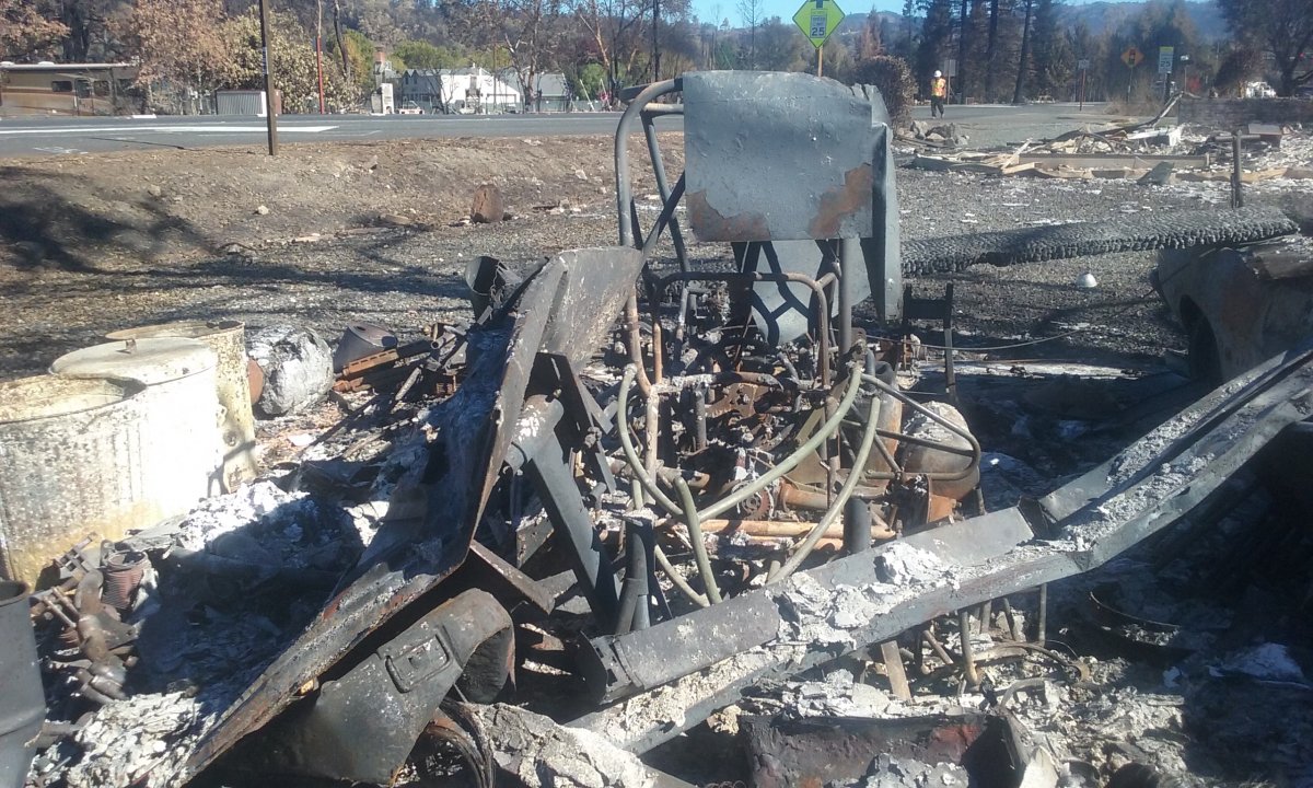

    There were hundreds of rods and cl***ics lost. This was a sprint car in my cousin's neighbor's garage. 20171024_112542.jpg A change in the wind also saved my neighborhood. Glad you were safe.

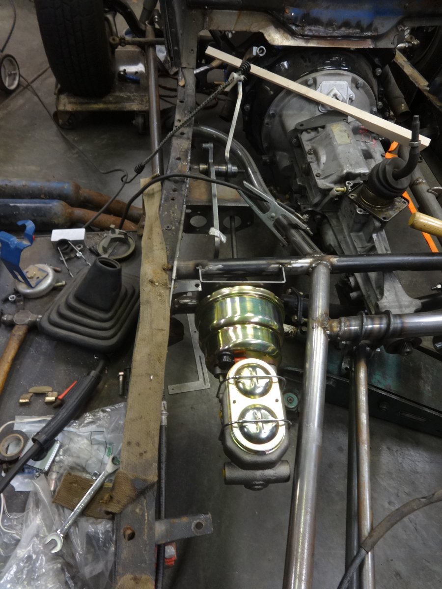

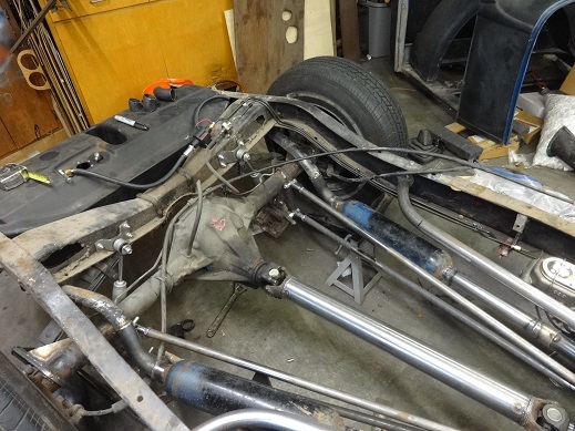

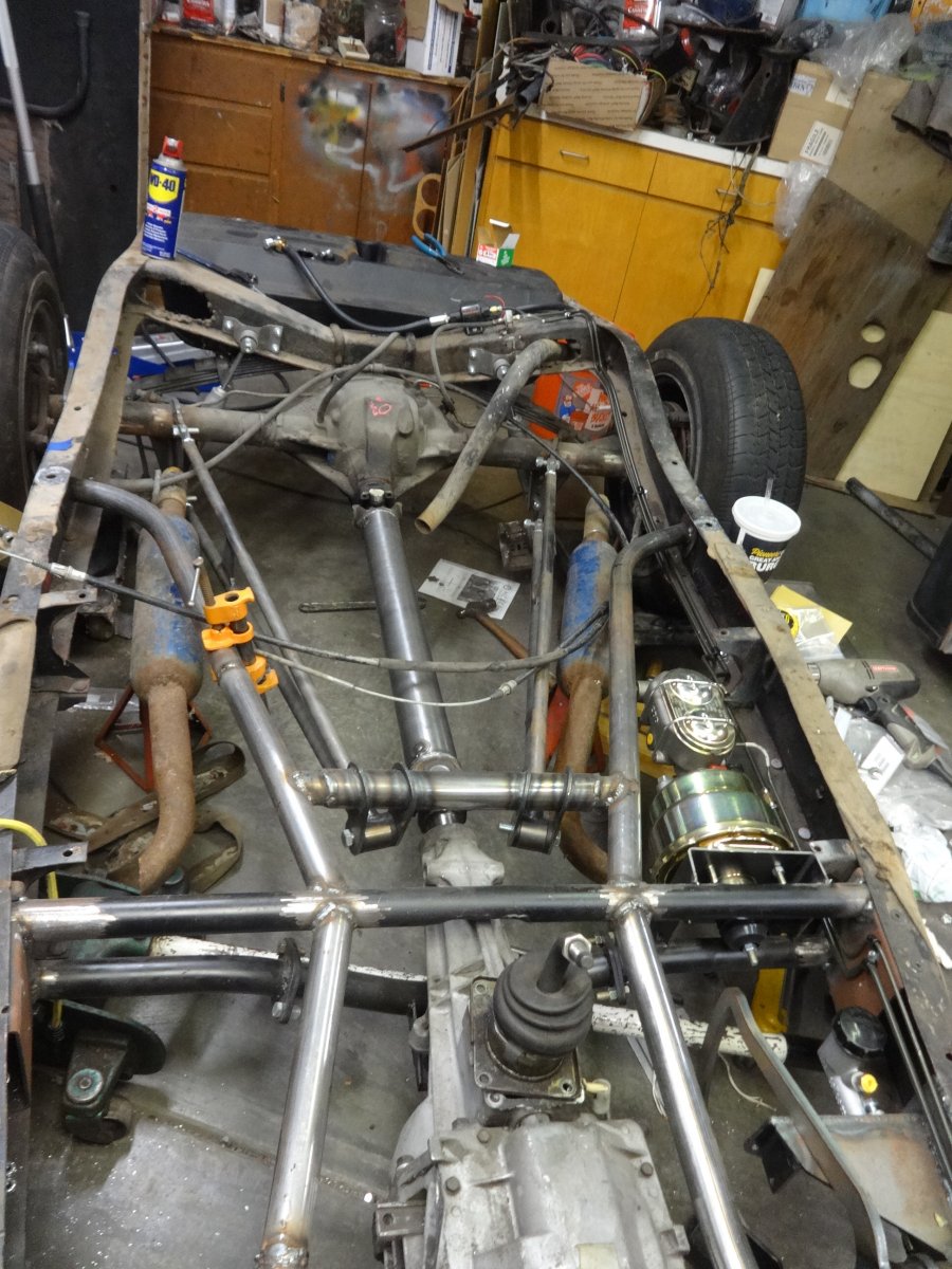

    Finally got to get back to work on my truck.... mounted the clutch and brake master cylinders and booster. Press brake is the best tool I've purchased in a long time. I've only made eight bends with it and it's paid for itself already.
    Getting close to having the ch***is work done and once the exhaust and brake lines are done I'm going to blow it apart and get the frame blasted and powder coated.

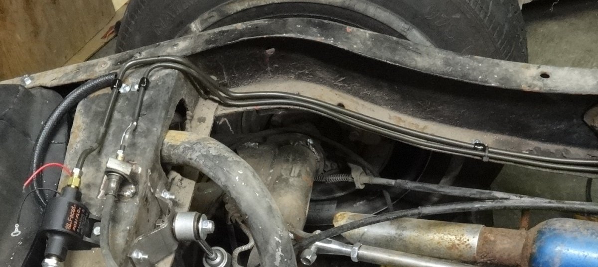

    Had a few productive evenings. I spun the brake block around on the diff to eliminate interference, ran brake lines, fuel line, fuel pump, fuel tank and drive shaft. I'd like to get the ch***is and exhaust done before taking it to get the front end aligned. Once that's done I'm going to blow it apart to powder coat the frame, axle and radius rods, front and rear before final ***embly.
    The wiring harness is next.....

  12. JimmyD3234
    Joined: Dec 3, 2015
    Posts: 632
    JimmyD3234
    from PA
    COOL always like them trucks had them N sold them so it was time to get one more pickup up one from the hamb 3weeks ago looking for some parts before I start its 34 p/up good LUCK with it :cool: :cool:
    Woodster likes this.
  13. redo32
    Joined: Jul 16, 2008
    Posts: 2,319
    redo32
    My experience with those fuel pumps, I would put it where it's easier to access.
    FlatJan and Woodster like this.
  14. Woodster
    Joined: Nov 14, 2012
    Posts: 179
    Woodster
    from NorCal
    HAHAHAHAHAHAAAAA!!!!! Good to know, thanks. It's one I carried as an emergency replacement in my roadster. Under the pick up that's pretty easy to get to but if I have a problem I won't put another in.

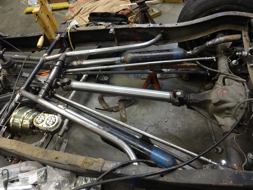

    Exhaust is run..... a boxfull of U bends wasn't quite enough so I used a couple of the pieces of the original exhaust (didn't look like it was run at all) and a couple NOS shorty mufflers off my old Jag (again, hardly run at all). Gotta make a couple hangers and it's done except for the tail pipes. I'll do those when the bed is back on.
    I'll drop the body back on and do the steering and begin running the wiring harness. DSC01938a.jpg DSC01939a.jpg

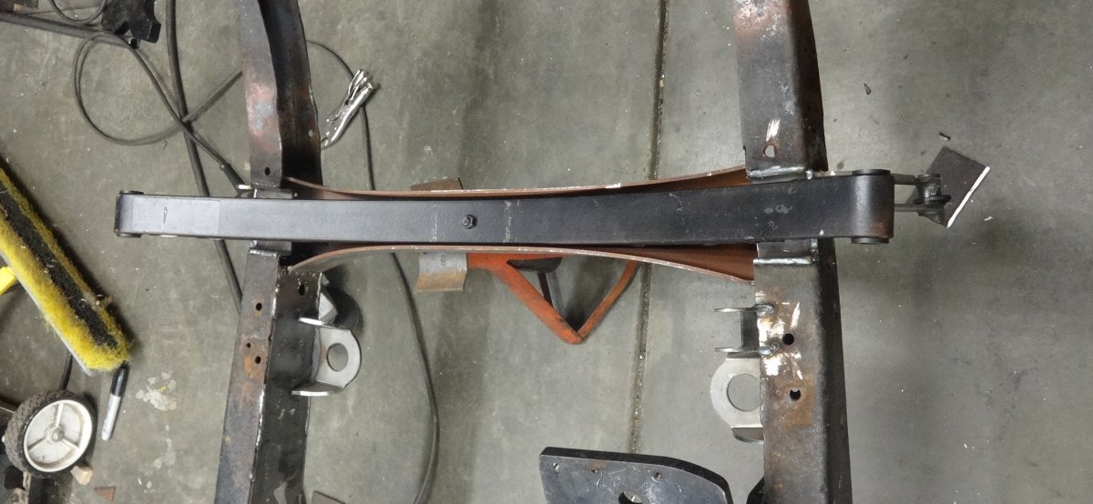

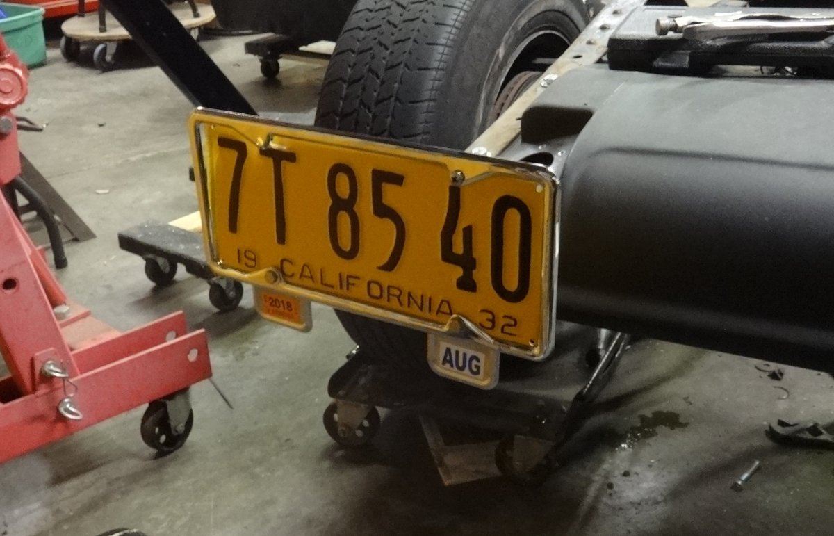

    Going to get the front aligned next Friday so I have to get the ch***is work done. Finished the brake lines, plumbed the clutch, installed a panhard rod and gusseted the steering mount. I've had a Hurst T-handle for 25 years waiting to put the right car under it and I modified the T-5 shifter handle to accept the handle. I'll have to cut and weld the post out of the trans to make it more vertical once seating position is finalized.
    Taking the ch***is to the alignment shop on a car dolly so I put the license plate on it..... first time on the road legally since 1970-ish

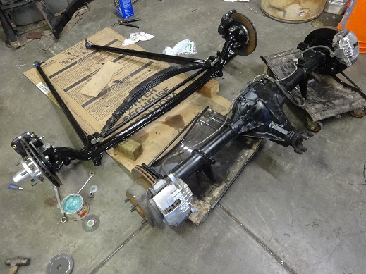

    from NorCal
    It took me a year to put it together but only three hours to strip it down. A little welding and it'll be off to the powder coater. Lots of pieces to paint in the meantime, looking forward to getting it back and putting it together for the last time!

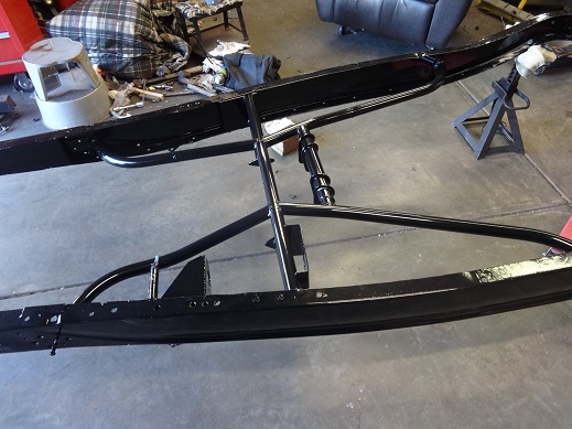

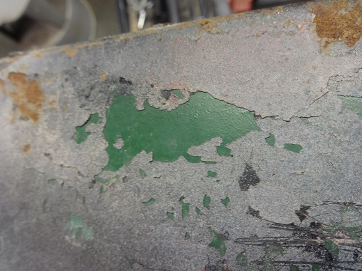

    Finishing up the frame for powder coating by notching the frame for the front spring (lowered crossmember), the steering mount and a few other places more easily done with the frame on it's side. I also repaired a couple exhaust holes which had been torched out in the rear crossmember. A little more work straightening some bent metal and it'll be ready.
    Also found a seventh color, metallic green!
    DSC01980a.jpg DSC01981a.jpg DSC01983.JPG DSC01984a.jpg DSC01985a.jpg DSC01982a.jpg

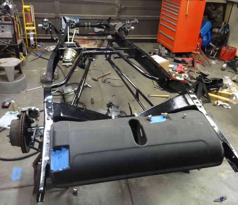

    Woodster
    from NorCal
    Back from powder coating a week and a half early!! Anxious to start putting parts back on. Pushing for road worthy by June.....

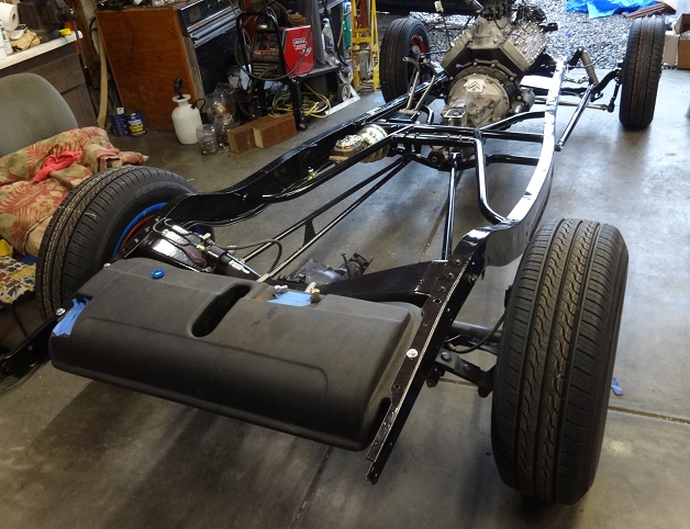

    Woodster
    from NorCal
    Got back into my shop and spent a few hours putting my truck back together. The brakes should be in and bled this week. Once I lined up the rear with the frame I cross measured the axles and have only 1/8 inch difference so I'm happy that I've got a nice square foundation.

    from NorCal
    Brakes are bled and working, steering rack is mounted...... engine is next. Won't be long before I have a running ch***is.

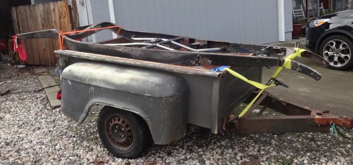

    Woodster, I want your trailer to fix up and tow behind my avatar ‘55! I don’t need one, I just think it would be cool. Did you make that or find it already made somewhere.
  27. Woodster
    Posts: 179
    Woodster
    from NorCal
    Indeed, it would be cool! I was at a friend's house about 30 years ago and it was sitting in his field full of garbage. When I mentioned I could use a trailer he said I could have it but I had to take the garbage too!

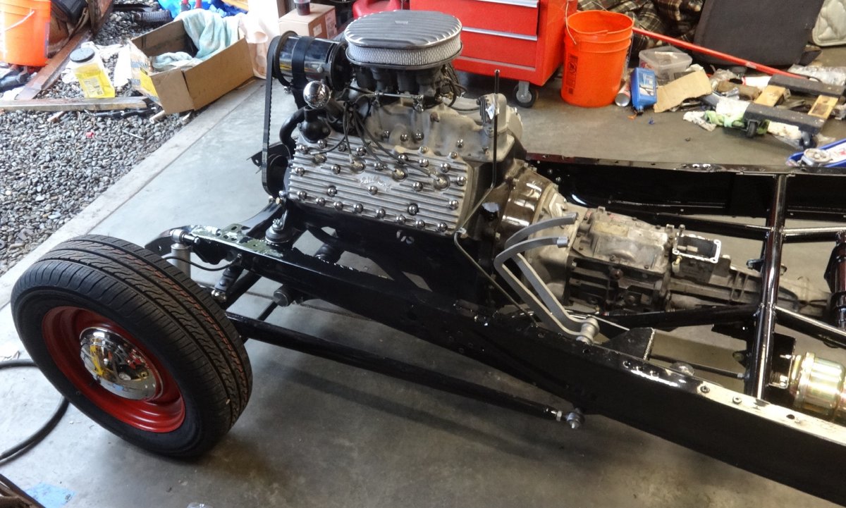

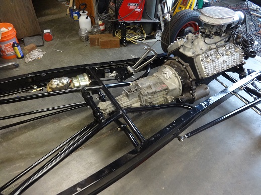

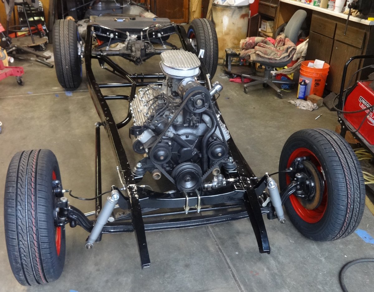

    Recuperation from eye surgery has been slow and new meds are ****ing the energy from me but I've been working a little bit at a time. The ch***is is almost done, just need to clean and paint the exhaust and snug up a few fasteners before starting the wiring.
    I was driving myself crazy trying to select wheels but just decided to run steel wheels until something popped out at me.
