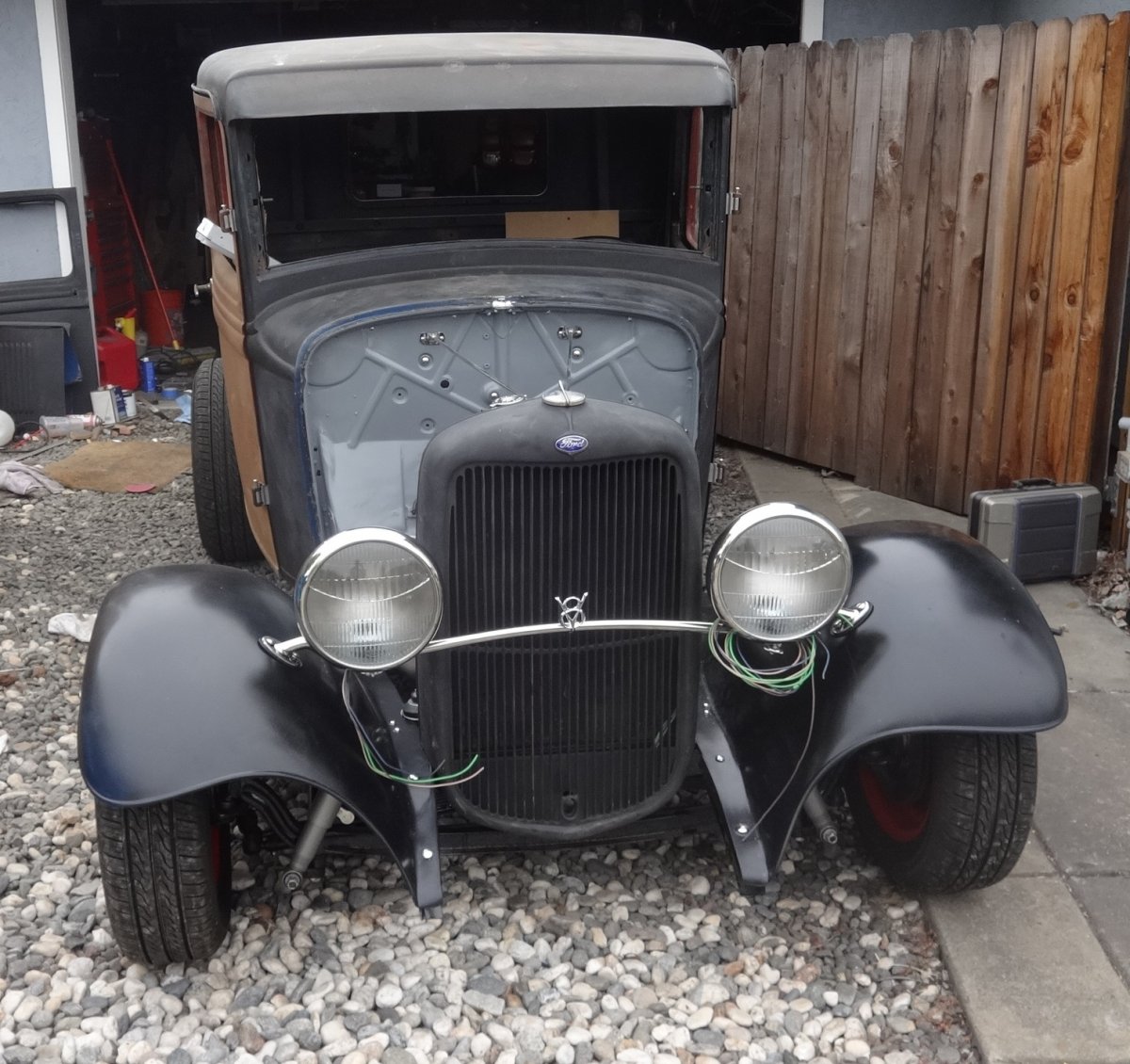

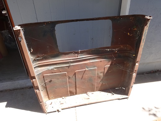

    I hate body work cuz I'm so ****py at it. I always sand it too much and you can tell right where my work is. After many hours over a few days of stripping and patching and 'putting it on and sanding it off' I have it good enough for me..... until I paint it and can see my work. Once all the bondo and paint was stripped there was more rust on the firewall than on the rest of the truck! I welded several patches in to repair the rust and some 'modifications' around the steering column.

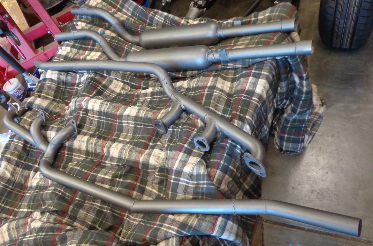

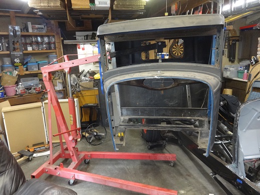

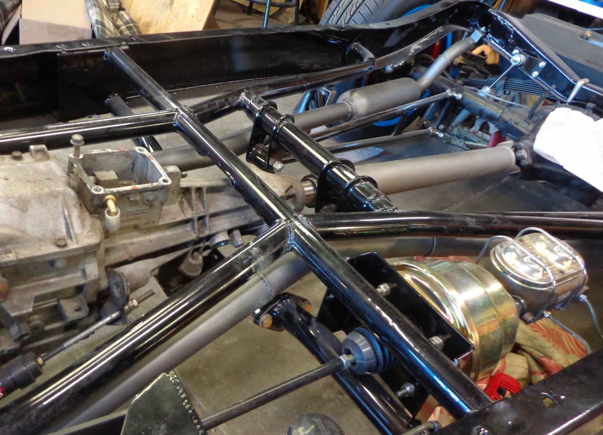

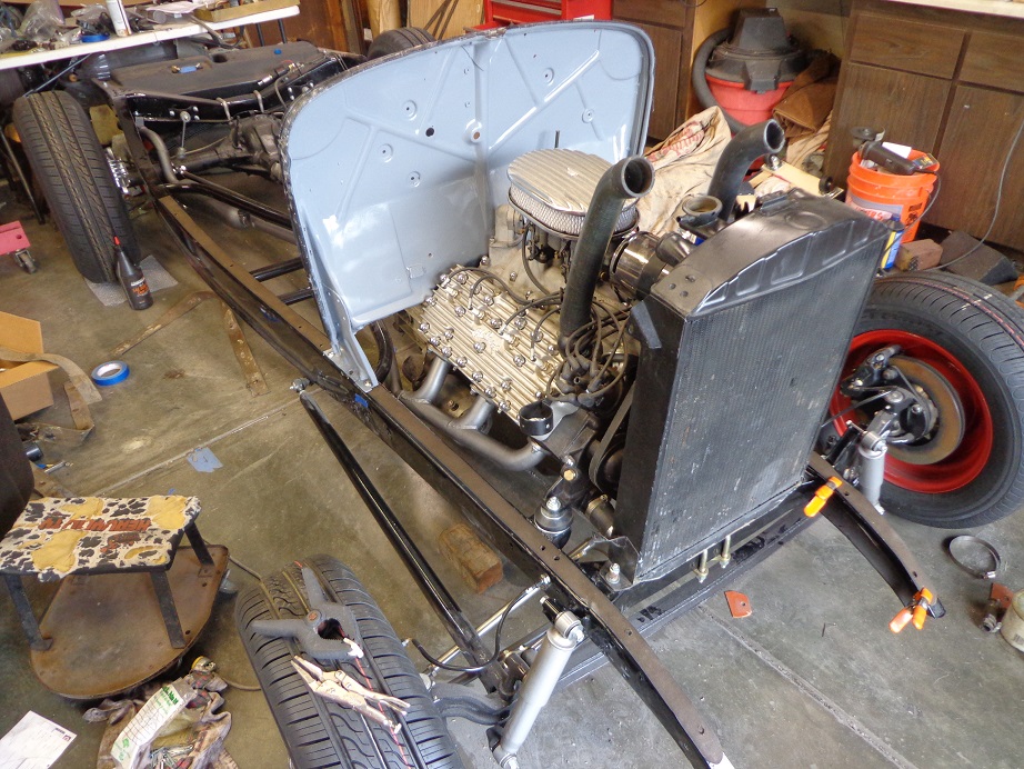

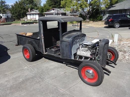

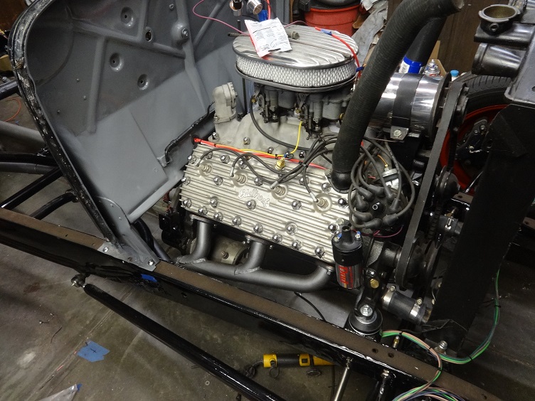

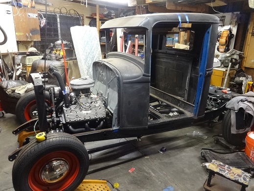

    My truck is coming along..... like a big model kit with much of the fab work done. Exhaust took hours to refit (all I did was take it off and paint it!) mostly because I had to lift the front of the engine and helicoil all four of the front bolt holes for the headers. My first time I did that.... pretty easy and they turned out perfectly. The front bolts have to be a little shorter and I suppose someone in the past just cranked them in.
    The firewall looks blue but it's a medium grey for a little contrast. It looks better in the pic than it is but it's good enough for me. A few sticker will disguise it.
    I laid down the webbing so the body can go back on and begin wiring. I just might make that Father's Day car show

    You do know the front four bolts in the flathead exhaust are a bigger diameter than the others, right?
  5. Woodster
    Joined: Nov 14, 2012
    Posts: 179
    Woodster
    from NorCal
    In the words of Inspector Cleudeau, 'Not any more'.
    At the bottom of the bore they were 3/8-16, the tops were a mess.
    Jet96, Tim_with_a_T and loudbang like this.

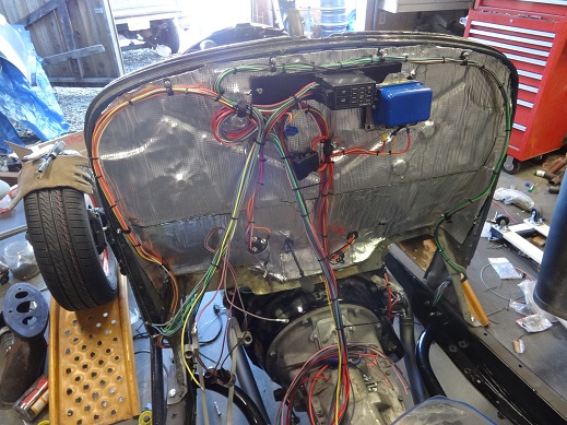

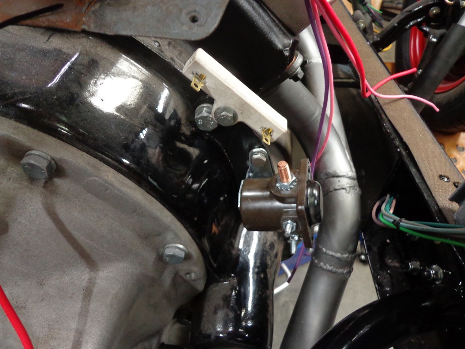

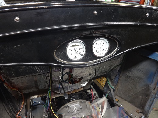

    Got most of the wiring done and it doesn't go fast when you try to do it right. I wanted to keep the firewall clean so I mounted the starter solenoid and ignition resistor on a little plate on the back of the engine and the voltage regulator is mounted on the inner firewall. The fuse box had cool little mounting tabs which will allow the box to be removed from its mount and drop down to inspect the fuses without folding myself in half. I covered the interior of the wall with BQuiet (like Dynamat) to try and keep the cab quiet and cool
    The body is back on and will get bolted down tomorrow so I can wire the instruments and hang the doors and maybe start the engine again next week. Can't wait to hear it through the exhaust.

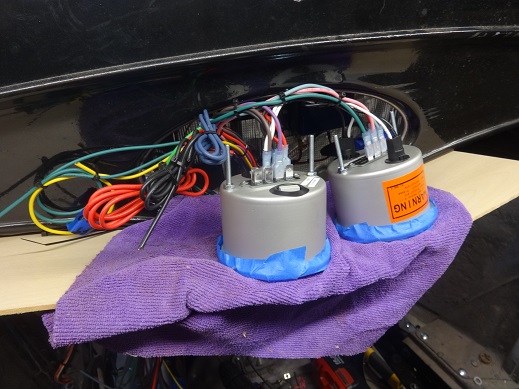

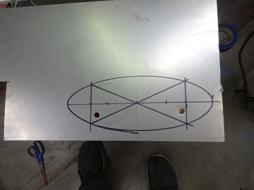

    Got the gauges wired (except for the speedo) and made a steel panel for the dash. I don't know what I want to do with it yet so this will suffice until I figure it out.
    Just a few more connections to be made before firing the engine.... maybe next week.

    a
    a little geometry goes a long way

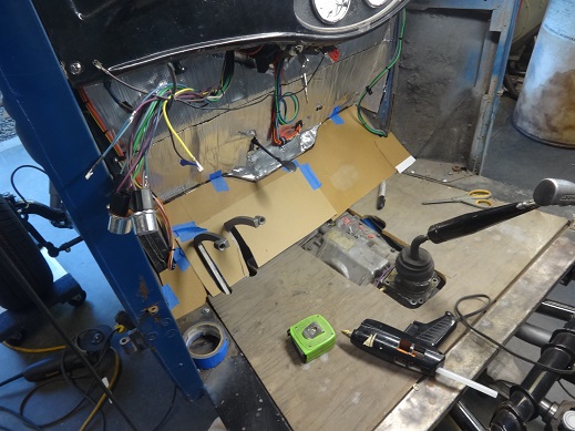

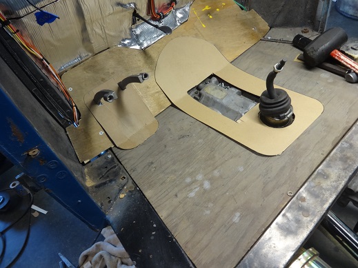

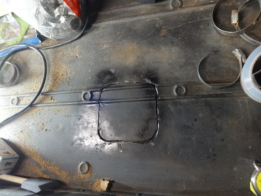

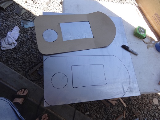

    Got most of the truck wired, gauges in and started on the floor. Reused the bottom piece but had to re-cut the toe board. I first made a card stock/hot glue template, then refined it with a fiberboard template and finally the 3/4" plywood toe board. A few more card stock templates for the sheet metal covers got most of it finished up. Just a little bit of welding and a cover for the clutch master cylinder will get it done.

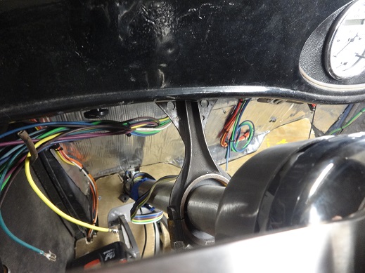

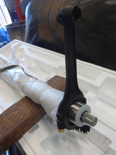

    I picked up an old flathead con rod from Vern and made a couple plastic spacers to mount the column. It's coming together.......
    brEad, loudbang and Cliff Ramsdell like this.

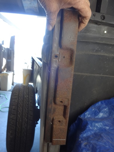

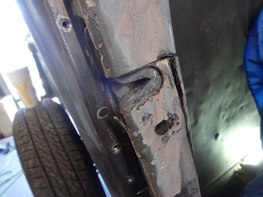

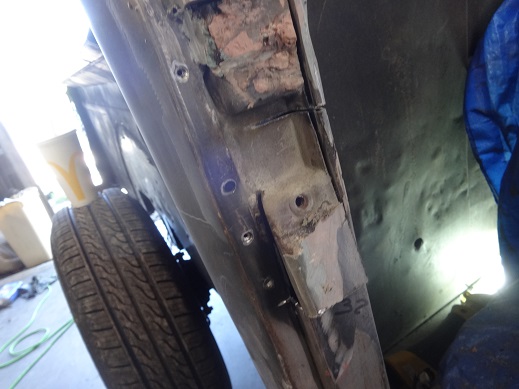

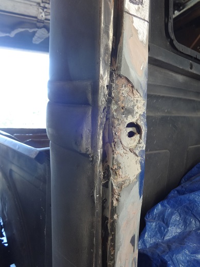

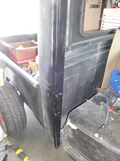

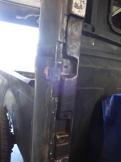

    This weeks work was mounting doors. I bought a set of United Pacific hinges but it ends up that it takes more work than I'm willing to do to remove the door side hinges. They don't wear anyway... I had to drill out the screws but it was a successful R&R.
    Someone in the past mounted bear claw latches and COULD NOT have done a worse job. I had replacement doors and rear jambs from the back of another cab. The jambs in my truck were 'smooth' but when I started removing the sheet metal I discovered that the dove tail pockets were full of semi cured bondo and the actual dove tail receivers!!!!! Why remove them when you can just mud them over?
    I pulled the latches and window regulators.... they were completely crusty and stuck. An hour of Marvel Mystery Oil freed everybody up and they're ready to go back in.
    Now I just need to do the other side and check for the dove tail pockets first!

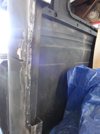

    Welded up, a little grinding and it's good as new. Just waiting on the latch striker, dove tail and window gl*** to call this door done!
