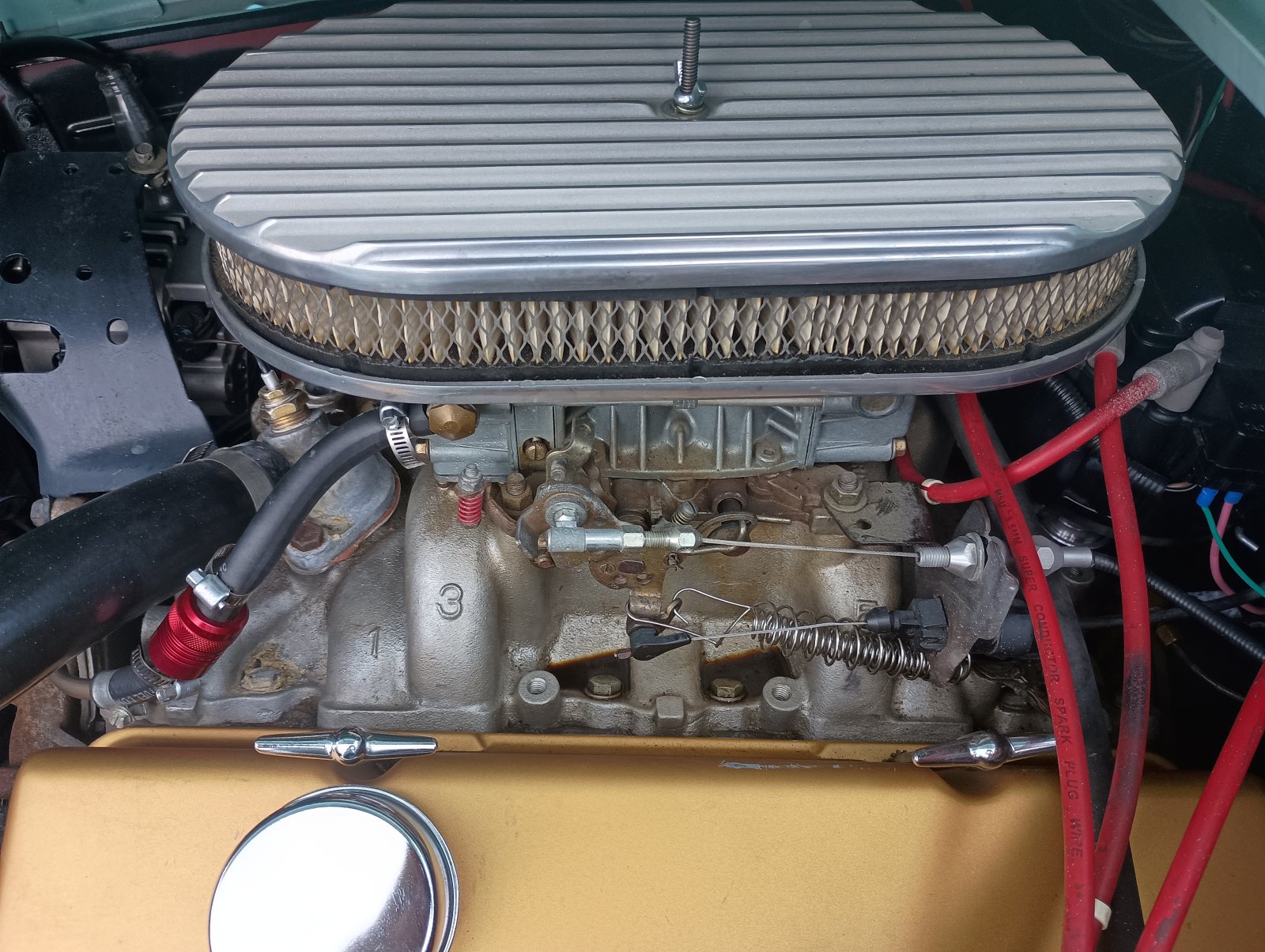

  1. I believe this may be leaking through the intake bolts as I see no other way. But I am not a mechanic. The other side is dry. Thanks for the help. Joe IMG_20240817_183053439.jpg

    I believe that just might be fuel.

    Yep! If not a combination of the two.

    Clean it up really good then keep a close eye on it after a little running or driving. It does look like it might be both oil and fuel but both are easy fixes.

    If you do get it cleaned up real good, spray some dye check developer over the area, this will reveal the source of the leak

    Or just pull the bolts out, clean it real good with brake clean and put some Teflon paste on the threads to seal them up.

    It sure looks like oil. But the surrounding gaskets are fine and the only way it could get there, possibly, was to have the valve covers resting up there while adjusting things below. Therefore, allowing the oil drips from inside of the covers to fill up the pockets of the manifold.

  9. It is definitely oil and not coming from the valve covers. So I will try removing the bolts and adding tape?

    Teflon paste....is a thread sealer that is brushed on from a can or squeezes on from a tube....not tape
    a generous application and wipe the access....

    Okay, I still believe it is fuel. The reasons are that the two bolts in question do not go into any oil p***age in the head. In fact they are each side of the exhaust crossover. You can also see fuel stains on the intake near the rear throttle plates. Gasoline and oil are both petroleum products. Gas comes from the light end of the petroleum and oil from the heavy end. If you have a small gas leak, over time you get a varnish like substance as it evaporates. What you have is a very small leak that keeps depositing small amounts of gasoline in this area which is heated by the exhaust crossover. If you notice, it has the same general color as the fuel stain coming down from the carburetor.
    The last reason is that I have seen this before especially on FE engines. My suggestion is to clean it up and clean the outside of the carburetor with spray carb cleaner. Then just monitor it to see how fast it comes back. I'll bet it takes a long time.

  13. Okay so I cleaned it all up and it probably is old fuel but has no smell. Going to take a long ride and check back in. Thanks

    Do you have a PCV system? Also use a flat washer against the intake manifold.

    It's likely fuel and dirt.

    I’ve never seen intake bolts leak that much.

    Are your valve covers on correctly? There is a top and bottom to them . The top has cut outs for the intake runners , allowing the valve cover to seat .

    While I agree that it's mostly fuel, those 2 bolts, on each side, are notorious for weeping oil up the threads, because they are open at the bottom and are tapped directly into the lifter valley. Remove the bolts, clean with brake or carb cleaner, and re-install with some pipe dope on the bolts. Then re-seal the bottom of the carb. That should fix it. If it still leaks after that, it's time to re-bush the throttle shafts. Or... just wipe up the mess as needed.

    ^^^100% Correct. I was thinking worn throttle shafts too. Very common. OP, it's not wise to use thread tape on anything oil related. The tape products can shred and the pieces can end up in places that can cause big problems. Use a semi liquid/paste product like Permatex High Temp. thread sealant or equivalent.

    Those center bolts absolutely will weep oil if not sealed. only the 4 corner bolts on an sbc don't go into the lifter valley. Every small block I build gets sealer on the intake bolts.

    I have had that happen on my Olds. Remove the bolts one at a time, coat the threads with RTV Silicone or similar, reinstall and torque. The oil is wicking up the threads and filling the pockets on your intake. Not a biggy. When I install a manifold I squirt out some black RTV, roll the bolt threads in it and screw them in. There may be something better than permatex but I know it works.

    The very best thread sealer “ I “ always go to is blue lock***e . Clean the holes and bolt threads with spray cleaner , allow to dry . Apply the lock***e reinstall . Done

    Permatex #2…

    Permatex "The Right Stuff" is my fav.

    I have a 50-70 year old can of McKay "automotive anti-seize thread sealer" Ive always used. Has the brush attached to the lid. Its a metal can
    .... I dont like silicone **** for bolt threads, pain in the *** to clean that sheet out/off when removed.

  30. I pulled the bolts and wrapped them with high temperature thread sealant. Put on some miles and it appears that did the trick. Thank for all the experienced help. Joe
