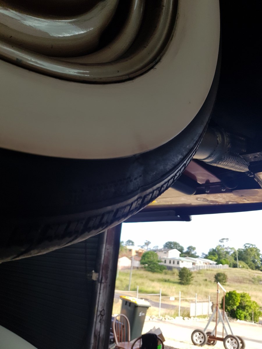

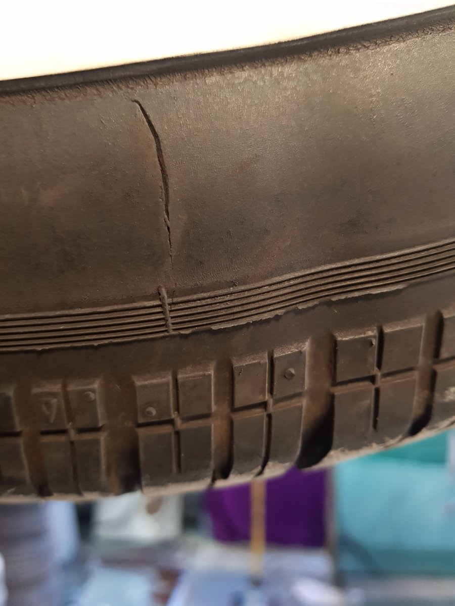

    Before I took the Hudson to USA last year I ordered 4 new tires for peace of mind(or so I thought).
    They were purchased through the Australian Dealer for DB and I received photos from him showing the tires all wrapped and with all tech data on them. I even contacted DB directly and was assured they were a popular tire. Well we had a vibration issue and today it went to the wheel alignment/suspension guru and he couldn't believe the state of these tires after only 7000 miles.
    Three of them have bulges and one has a horizontal split on the sidewall. I have really had bad luck with tires on this car and now I am concerned about what to do next. I think I will replace them but with what? I think Venezia are Chinese tires and DB just grind the sidewall and apply the whitewall.
    The suspension guy is concerned especially with that one with the split that it will just explode. It has gone on the back for the time being. Hate to have a blowout on the front at 110 km/hr.
    I will be following up with DB. These are 205/15/70 .

    I am not questioning your ability, but this statement suggests, (to me) possibly, that there may be issues with the car set up, suspension, wheel alignment etc.
    With all the international shipping, has something moved or been bent, straps over tightened, in transit ?
    Personally, I stay away from Chinese tyres, but that’s just me.

    First two pics look normal to me. See it all the time on the tires. Third pic is different. How many plys are the sidewalls?

    What size are the tires? What is the load rating on them? What does your car weigh? If you are running a 205- 15 tire on a car as heavy as I think your Hudson is you may be overloading them. I do not know if they make an XL (extra load) in that size. I think they make them in 215 and up. The crack on the side may have been caused by hitting a pot hole or a curb.

    That cracked tire needs to come off!!!
    Sidewall Indentations / Undulations
    [​IMG][​IMG]
    Fig. A: Vertical indentation on sidewall from rim to tread.
    A common byproduct of radial tire construction, sidewall indentations/undulations are more noticeable in tires with taller sidewalls or operate at higher inflation pressures. Fortunately sidewall indentations are a cosmetic condition that does not affect the performance of the tires.
    Tire casings are reinforced by multiple fabric cords encased side-by-side in a thin sheet of rubber. Radial ply tires feature one or more layers of cord (depending on the tire's required strength) that run parallel to each other from bead to bead (with each individual cord running up the sidewall, across the tread and down the other sidewall). Because of their "straight across" radial orientation, the overlaps where the sidewall cords are lap-spliced may cause indentations.
    When the tire is being cured, it is pressed against its metal mold. However when the tire is mounted on a wheel and inflated to operating air pressures, it is free to expand. These overlapping splices may create slight indentations since the stretching capacity of the lap-splices is slightly less than the rest of the body ply. In reality, the splices are the most reinforced area of the tire's sidewall.
    Since radial tires feature steel cord reinforcing belts under their treads to keep them flat, indentations only appears on the sidewalls.

  7. What EGADS said above about the sidewall indentions is spot on.
    In the industry it's called "body ply overlap".
    The one with the crack needs to be removed from service!
    Looks like a sidewall separation between the body plies and the body covering.

    Checked the load rating per tire and it is 1620lbs so 3240lbs for front and same for rear. The total weight for the Hudson originally is 3715 kerb weight total. With this car we have put a full chassis under it but that just replaces the original sub frame and lots of built in structure at the rear. With a lighter engine in it even at the maximum weight would maybe 4000 - 4250 lbs well below the load rating front and rear. Diamond Back recommend that you run 40psi in these tires(see their website).
    Will definitely replace maybe 2 tires and put them on the front and 2 of the best of the 4
    on the back.
    PS They are 215/70/15 not 205/70/15

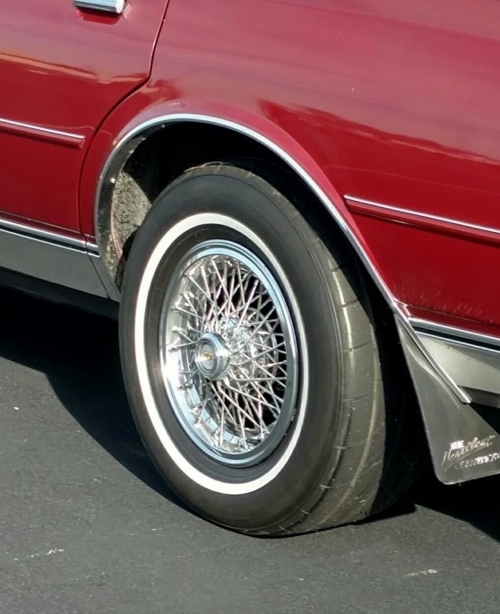

    Firstinsteele, Diamondback can put a " pretty whitewall " on almost any tire you want, I had them put a whitewall on my nitto 555r drag radials for my 4400# drag week car that runs low 12's and they have held up great.[​IMG]As far as new in front or rear , would you rather you had a worn tire blowout on the rear that could take out a 1/4 panel and possibly roll the car, or on the front where you still have a chance for some control. If you have ever had a rear blowout, you'd believe it.(scary either way )
