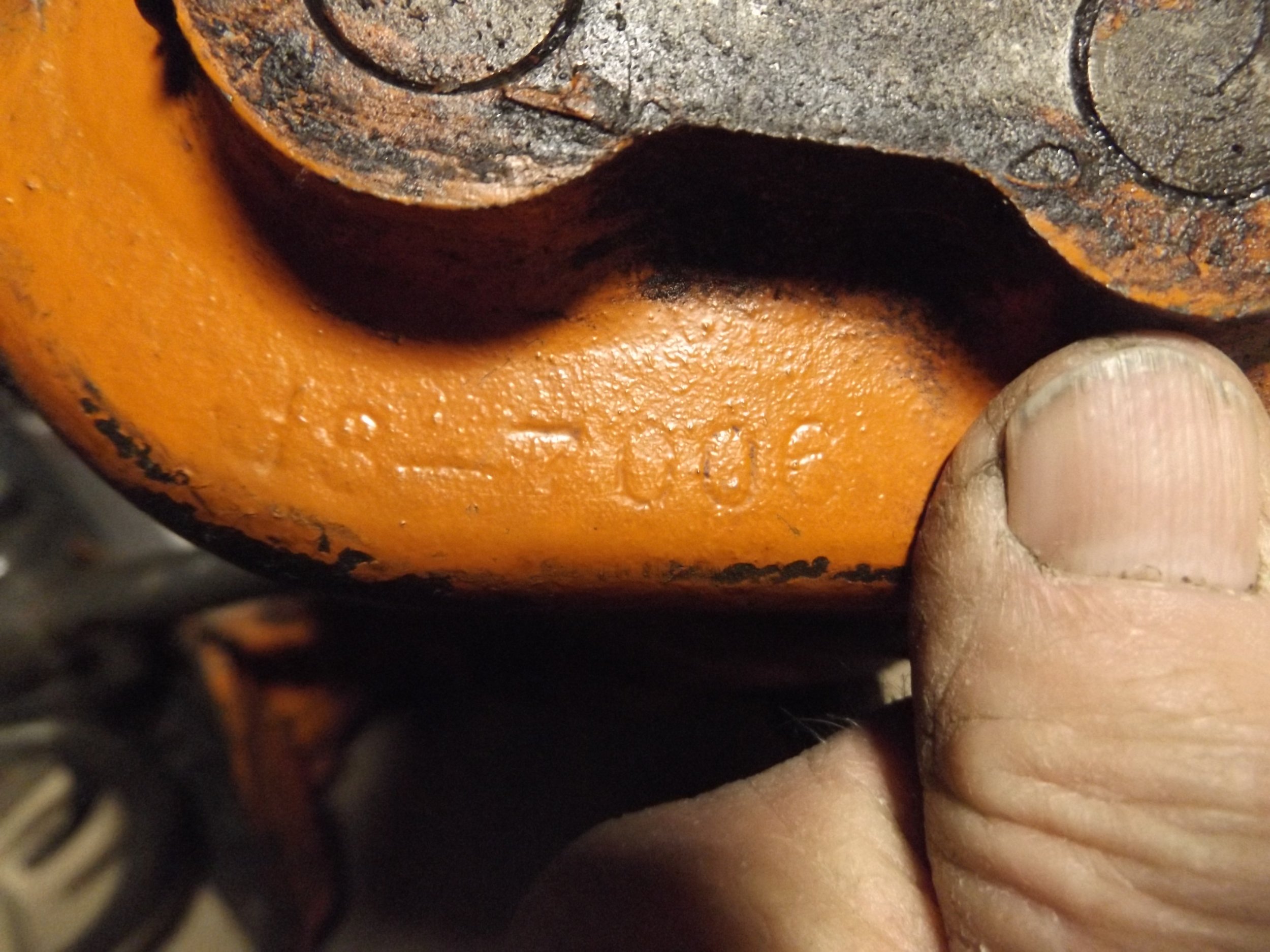

  3. California uses the number stamped into the frame, do you have that? The 18-7006 is just the part number of the casting.

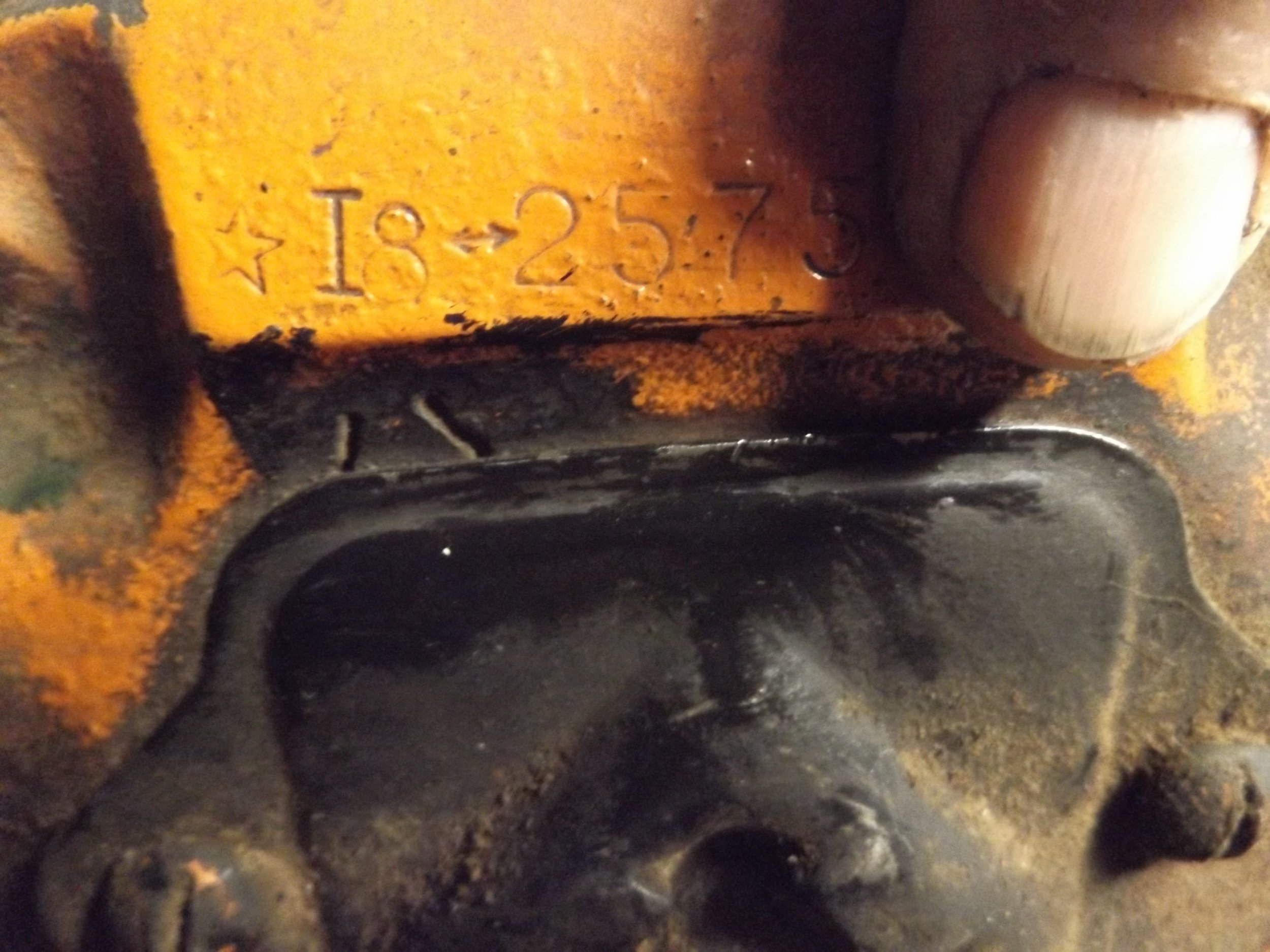

    He has the serial number in the middle pic.

    Serial numbers on engine/trans is useless. CA wants to see the VIN stamped on the frame and if you don't have any paperwork, even that is marginally useful and you'll likely be sent to the CHP for a VIN ***ignment.

    On the B the serial number moved from the engine to the top of the flywheel housing. These were not a "VIN". They are the serial number Henry ***igned to the engine/trans ***embly for accounting. States used the numbers to issue registration do***ents. Many states only issued registrations and not ownership ***les in the early days.
    https://www.fordgarage.com/pages/ABenginenumbers.htm#C6
    CA wants to see a complete car before they will consider issuing a ***le. I've always found it odd they want the frame number when that is hidden by the body. Someday I'll lift the body on my car to check if it matches the engine. It has an ***igned VIN which makes engine swaps a no brainer.

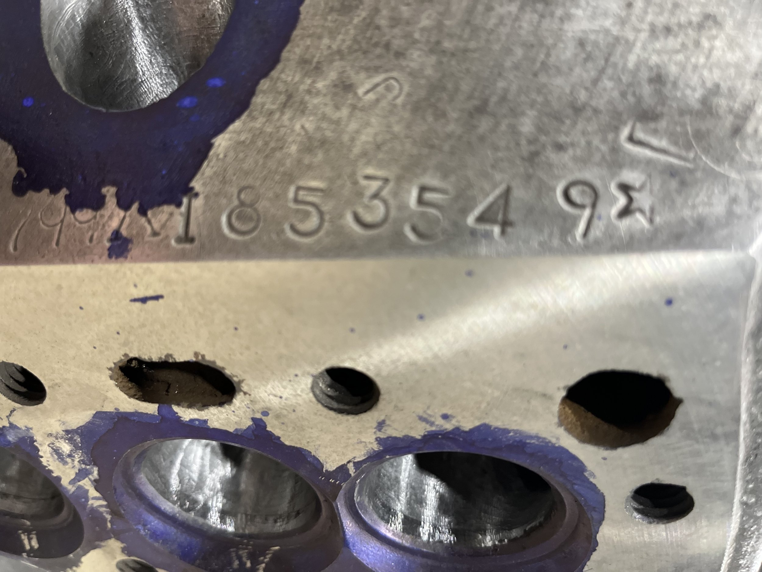

    Joined: May 17, 2003
    Posts: 8,363
    19Fordy
    Looks like an "I". Would never p*** as a "1".
  29. Deutscher
    Joined: Nov 12, 2024
    Posts: 223
    Deutscher
    from Germany
    Aber es ist eine Eins, bei meinem 31 4 Banger ist sie auch als Motornummer eingestanzt.
    Ford hat die Zahlen 1-6-9 ab Februar 1931 geändert, so steht es auf Fordgarage.com.
    Grüße Harald
