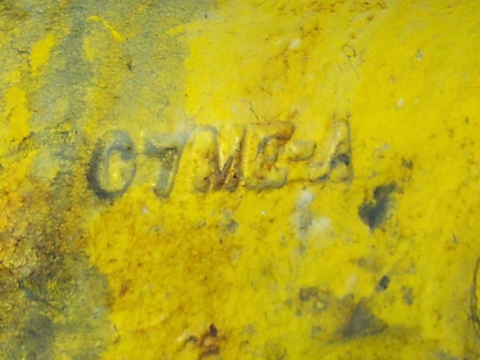

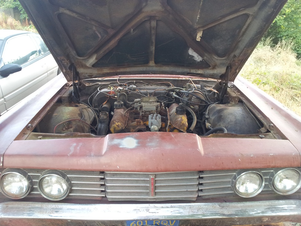

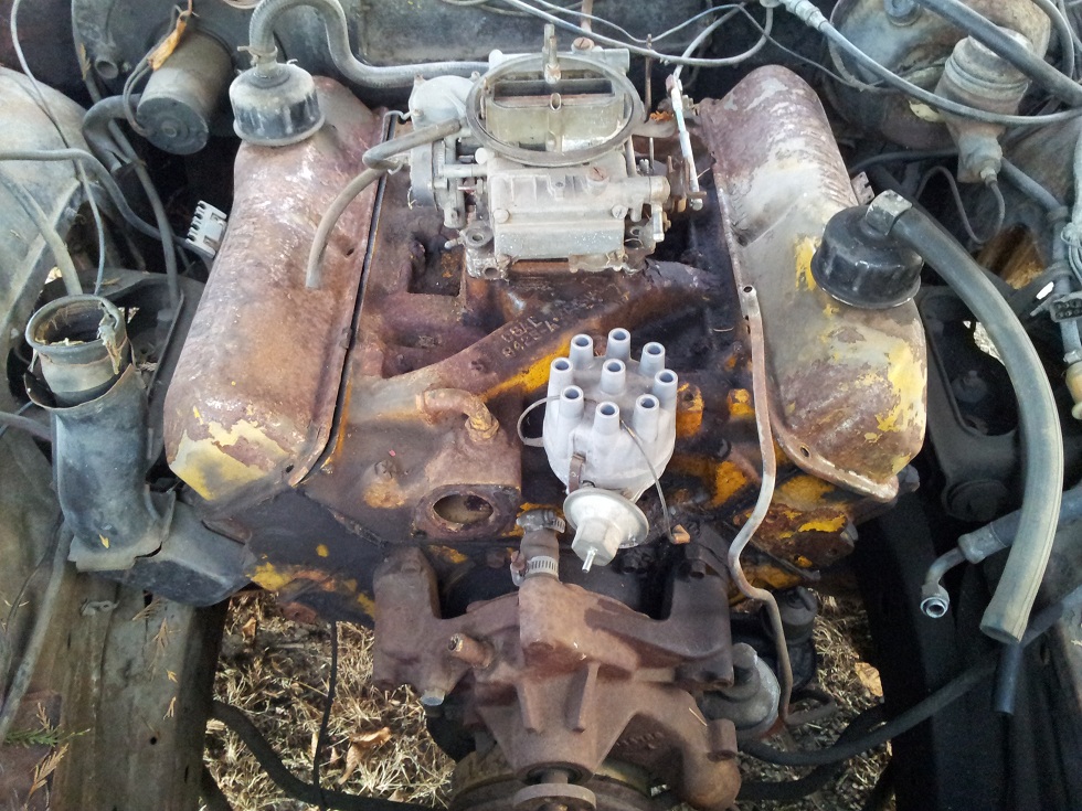

    I worked at a shop for two years as trade work. As my end of the stick began to shorten I bought the shops '65 Marauder and quit. I assumed it had a 390 under the hood. At first glance the motor looked like it had been used as an anchor for the last 40 years so I planned on dropping a Y block in there. Long story short I got it home and pulled the valve covers and saw something that caught my eye, clean, fresh metal. So I started pulling numbers and became even more intrigued. Heads and intake are '68, block is '67. If anyone has any info on this motor I'd like to hear it, I'm not too keen on FEs. I would have checked stroke but I haven't gotten it to rotate so I'll measure that once I tear into it.

    C7ME-A could be a 67-70 428 CJ, or a 330 from a medium duty truck, needs more investigation bore would tell, or crank casting number if pan is off

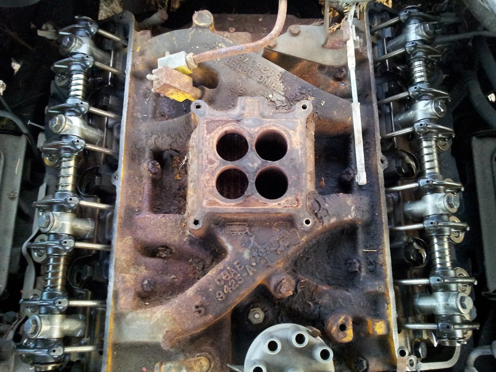

    First a 390, 427 and the 406 (earlier than your block) have a 3.78" stroke. and the 428 and Merc 410 have a 3.98" stroke. So yours seems to be a 390.
    Your intake is a 1968 casting 390 GT type (S on the runner) which is nothing special.

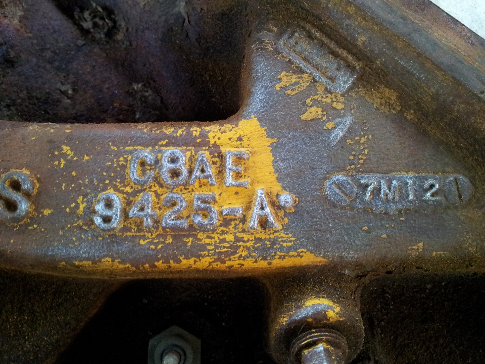

    Almost all of the different FE's in some version had a hydraulic cam. Yours has the non-adjustable rockers so it's most likely hyd. Check for a casting code between the two center exhaust bosses near the plug to get an idea what heads you have

    Thank you very much. Like I said I have limited knowledge on FE motors. I've only rebuilt 3 or 4 of them. I won't complain about a 390. The heads are C8AE-H. I only considered a Y block initially for price and availability (I had one available for $200 running). I'm looking forward to hearing this 390 fire up. Can't beat a complete '65 for $500.

  30. MeanGene427
    Joined: Dec 15, 2010
    Posts: 2,307
    MeanGene427
    from Napa
