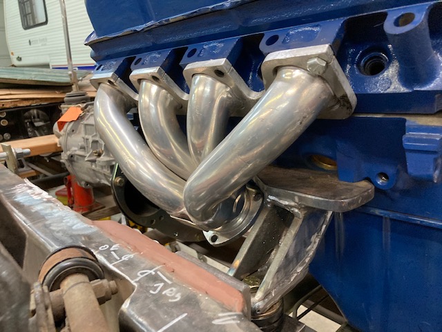

    I build all my chassis from scratch, this one is a swept design on the front portion for my Coupe.

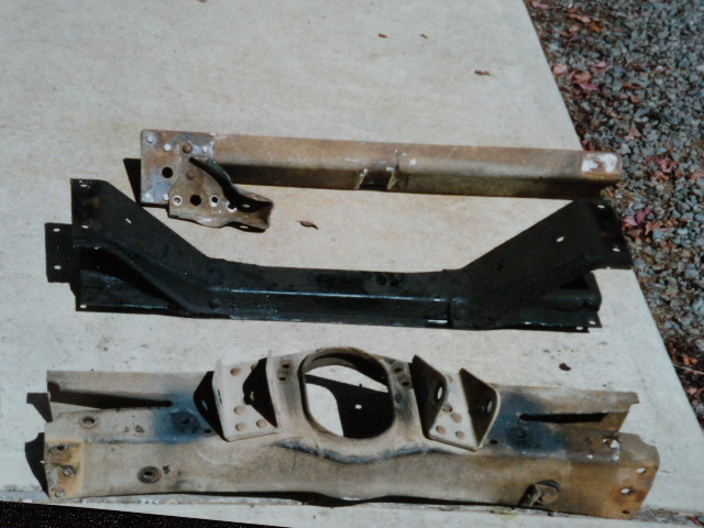

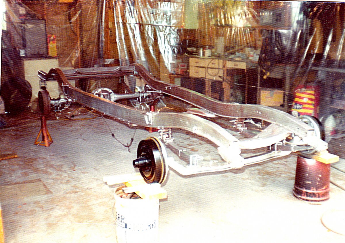

    Original frame for the 38 and a 58 Hawk Frame for the 53, so for the most part "original". IMG_1770.JPG

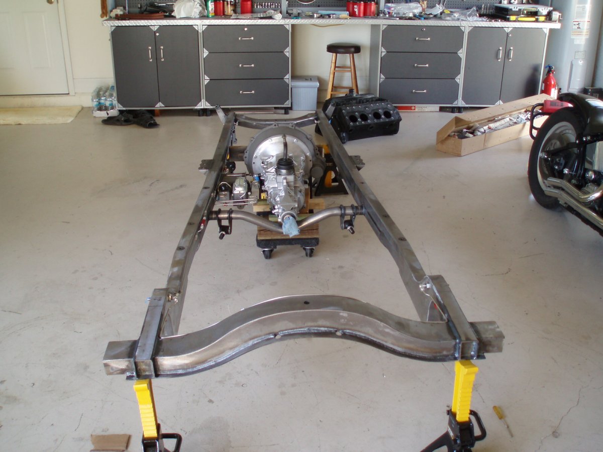

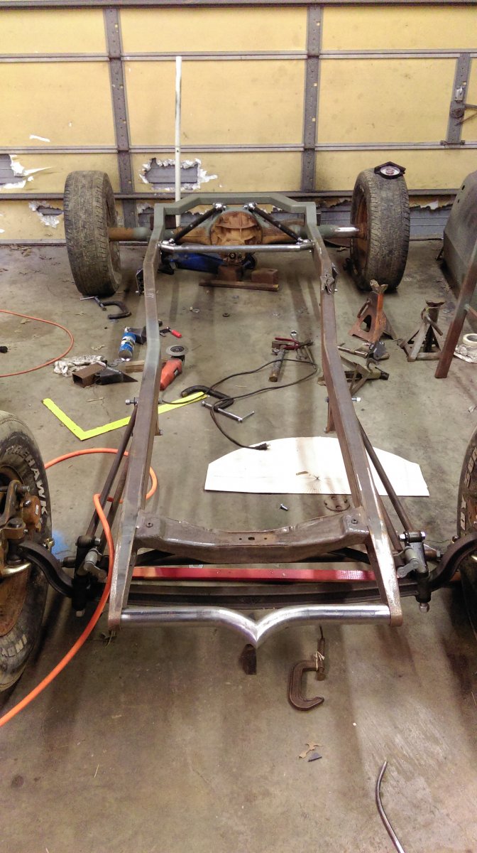

    IMG_20190804_162134.jpg IMG_20201118_153156.jpg MVIMG_20190725_141319.jpg MVIMG_20190725_141319.jpg IMG_20201118_153156.jpg mine is a fabricated frame for my 36

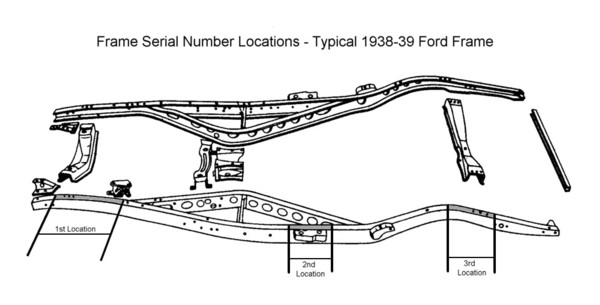

    Some Other Cars Became "Frame Donors".....When 40 Fords Were $100.00... Flathead_Frame_serialnumber_location.jpg

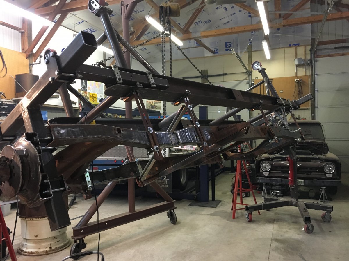

    My 66 Suburban was dropped about six inches and anyone that knows these trucks are familiar with what that does to the front crossmember and A-arms.
    So it went on the operating table.
    The rear of the frame was notched about three inches for axle clearance, had to make a riser in the cargo area to clear the new adjustable panhard bar and differential housing which was narrowed twelve inches.
    All this was replaced and an all new tubular front suspension with coilovers was installed.
    Sorry, that is probably not HAMB "kosher", so no photos.

    ....I am not trying to start a war but I have a question...the guys that make their frames or buy ready made frames...what do you do for the serial numbers? You can not stamp the numbers from the old to the new!...thanks Miller

    If I have a title for a car with a bad frame I just make a new tag and mount it on the new frame, I have also seen them stamped. HRP
