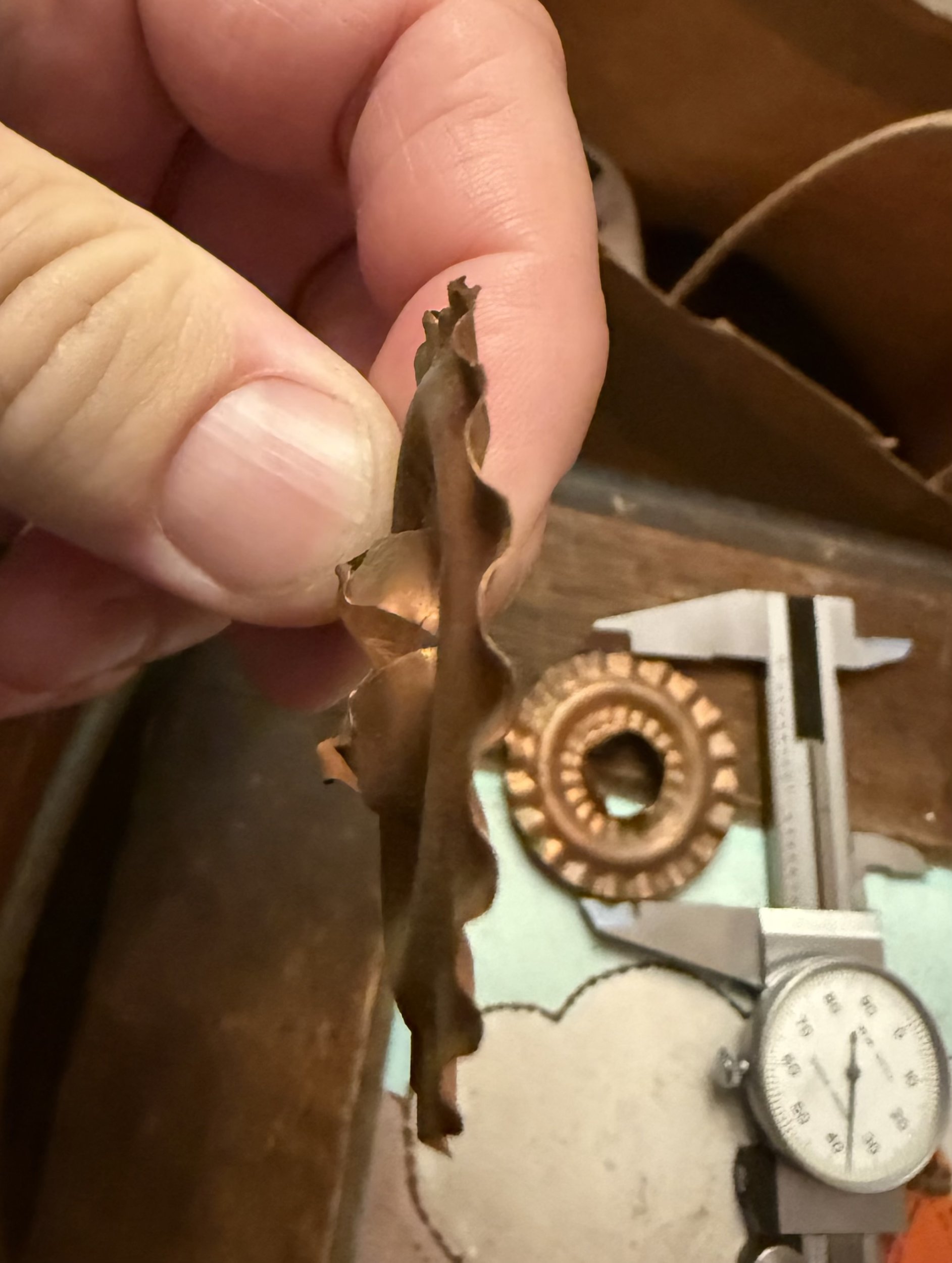

    the fins are 1.835” in diameter and 0.015” thick. have a floor mount brake rivet press that i’d like to use as it has removeable dies.

    The round part you posted isn’t just die cut. It is also embossed with a male and female die. We used to do embossed aluminum signs but the dies ( matching male and female ) are very expensive.
    Our dies are made of 5/8 furniture grade maple board. An average single die is between $250 to $1,000 for the die. Embossing dies ( matching male and female ) run between $3500 and $6,000 due to all the extra ejection foam pieces needed
    I was under the impression you wanted strips cut to be folded like a normal radiator fin.
    Based on conversations here, buy a radiator for a lot less money. Just my 2 cents

    Actually, anyone with a small CNC (Computer Numerical Control) milling machine should be able to make you a matching set of dies fairly easily. You need to make a drawing showing them what you need or provide an existing part that they can measure. If you have an existing part many of the machines can touch the surfaces and record the dimensions making plotting the moves much easier. Once the program is made, it's pretty simple to make multiple dies or a pair of plates that can make multiple parts in one pressing. You will need some decent steel that will hold its edge even though you are stamping br***. As for making the CNC program, if they know the dimension of one "seration (?)", they just tell the computer to put the number of serations you want and that area is done. Really easy . You may be able to find someone doing that stuff at home if you look on Facebook.

    Don’t waste your time scanning it… the part is too simple. The scanner will pick up all the minute imperfections and distortions, and they will carry over to the die set. Get out your ol radius gage set and make up a sketch of the part.
    Might consider trying a single side die used with rubber block, this way you don’t have to worry about timing the dies. Probably not gonna work on the ol brake rivet machine, but might work out good in a 2-3 ton arbor press. Start with a laser cut disk, drop it in the die, and squeeze like hell. The center break out is gonna be rough on the rubber, so would leave the center underdeveloped during forming. Piercing would need to be a separate step. Could be as simple as a hammer and star shaped punch over a block of wood

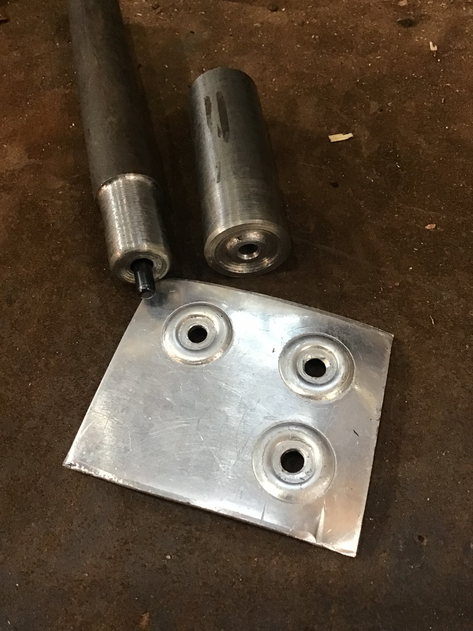

    Yes a CNC machine would make the forming dies quicker and easier to produce. Being your dies were made in the 1970s don’t think that method was used. A simple lathe and mill with a turntable would make it . It’s going to take a bit of time and a few setups along with some hand work.
    I would recommend finding a used Di-Arco Roper Whitney punch and die to cut your copper blanks.
    I would then use the forming dies on your rivet machine to press the shape of the cooling fins.
    A simple form punch to make the raised ring and cooling fins on another forming die setup. This is one I made for screw holes to stamp .062 aluminum . This was made out of s****s and punch is an old ford steering shaft.
    We made millions of parts by hand forming on a kickpress
