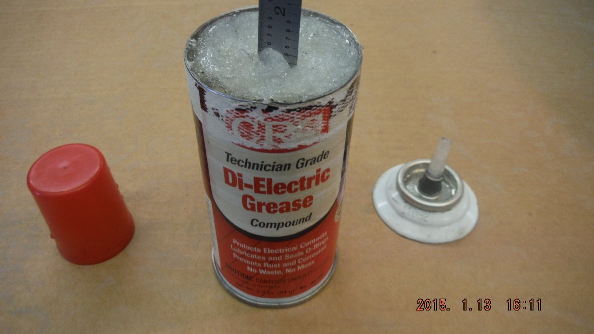

    I've kept a can of it around since. This particular brand is CRC. Probably like orange's
    Thing is, I had bought a can of the stuff and in (what seemed like) a short time it lost the pressure to expel the grease. Took it back to Ace Hdwe, they gave me a new one but not without a condenscending side-wards glance.
    The replacement can eventually did the same thing.
    There's a small rubber plug in the bottom; it must not have sealed very good, 'cause all the pressure was gone. What was odd though, was that none of the grease came out the bottom, so I don't know if that was the problem or not.
    I carefully took the can apart to see what was still in it. Much surprised to see the can almost full.
    So, I found a plastic cap that fit the can and keep it covered.
    Like others, I use it alot now on connections.
