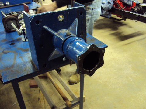

    from Roy, WA
    I use 3/4 inch plywood cut into the same cir***ference as the tires and drilled to match the bolt pattern I am going to use on my rear end. That way I can roll it under the car and center in the wheel well. The stand pictured is what I use for overhaul and panting. Works for me............Terry
