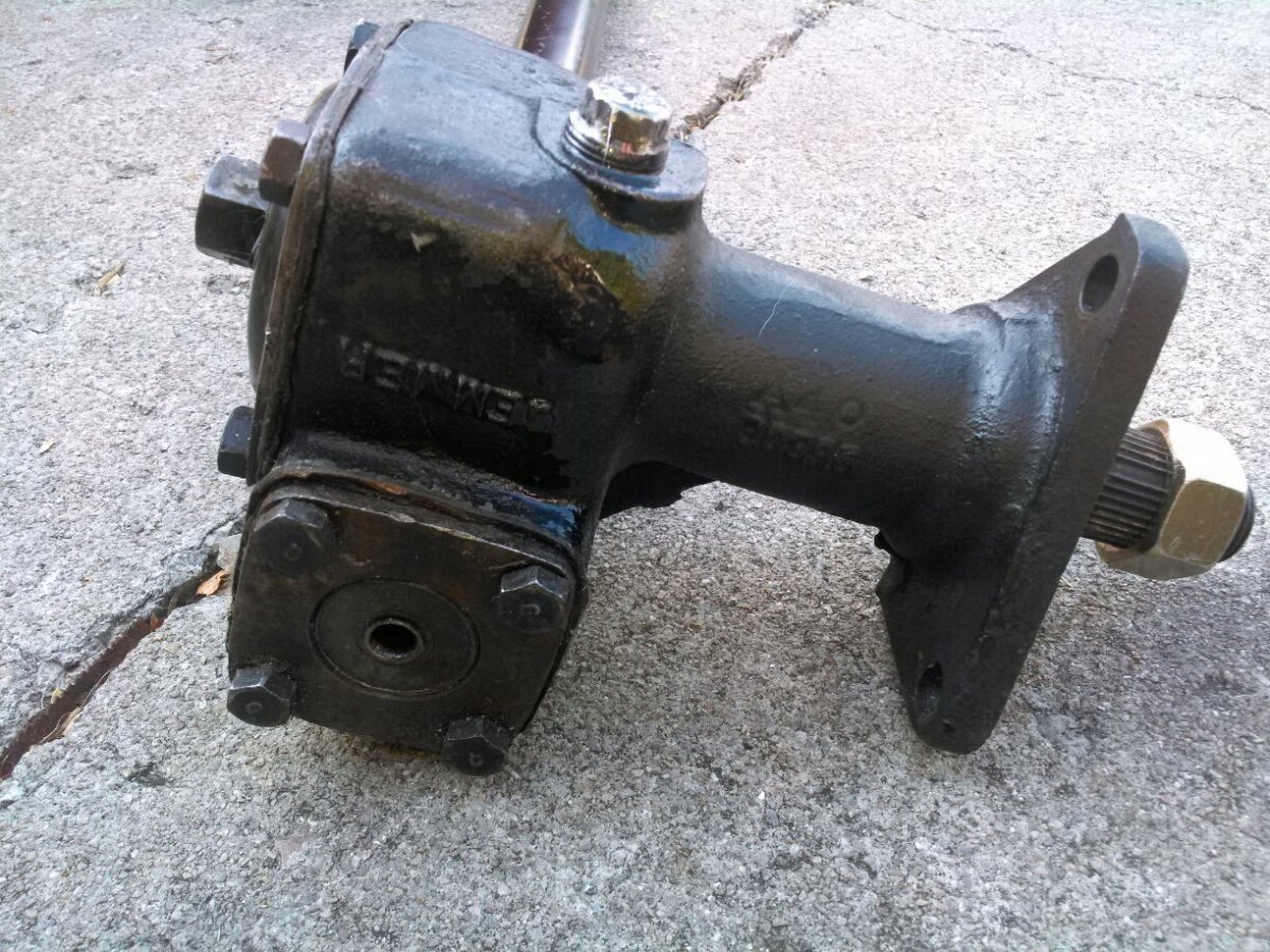

    Here are two photos of an F-1 box and one of an F100 box
    I borrowed one of Junkmanjr's photos out of the classifieds so give him photo creds for the F-1 box photos in the top too and used a somewhat generic F100 box photo in the bottom photo . F1box 3.jpeg F1 box.jpeg
    Note I have been informed that the lower photo was altogether wrong
    48fordnut likes this.
  7. alchemy
    Joined: Sep 27, 2002
    Posts: 22,592
    alchemy
    Mr48chev, that last pic is not an F100, itsa stock 32 Ford.
    29AVEE8 likes this.
  8. Kiwi 4d
    Joined: Sep 16, 2006
    Posts: 3,870
    Kiwi 4d
    Sorry MR48chev but the last image will confuse folk as to me it looks very much like a 32/36 ford car steering box. The top two appear to be F1 with the off set mast and splined sector shaft.
    48fordnut and 29AVEE8 like this.
