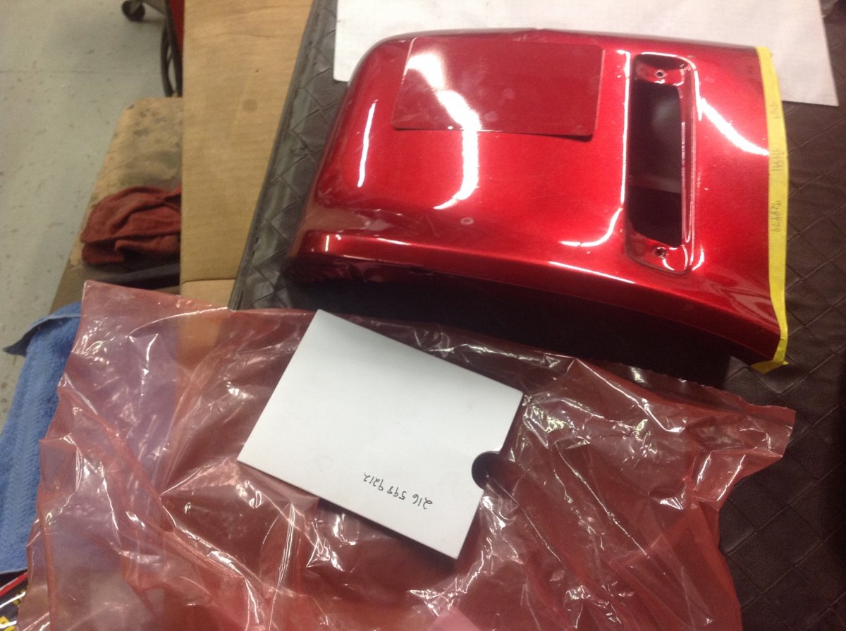

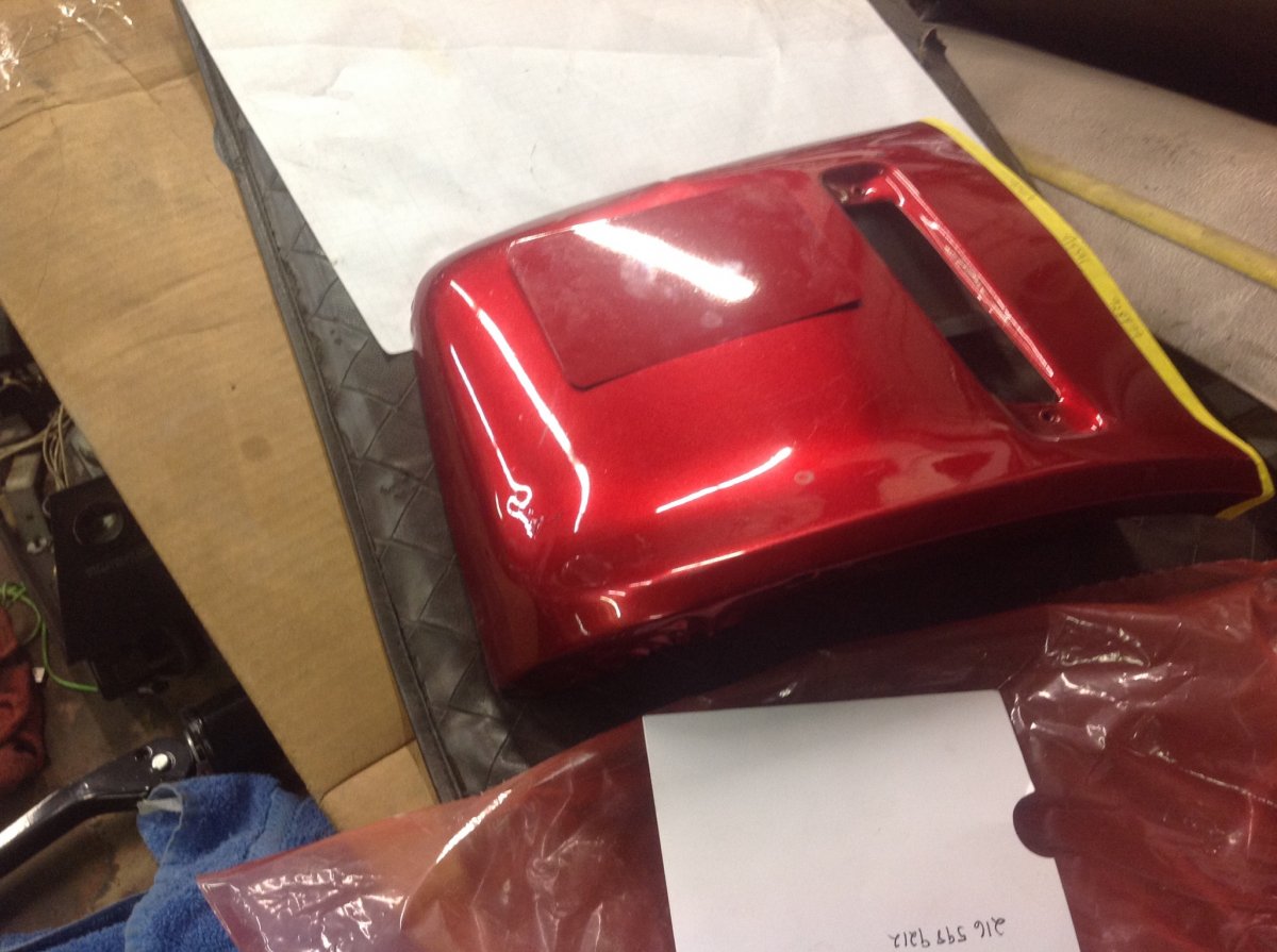

  18. Are you good at paint matching?
    Up for an impossible challange?
    I've had 1/2 dozen guys try and then
    Thru a friend I got this into the main lab at the local headquarters of a huge manufacturer. Took them almost a year and this is as close as they could get to a match. Supposedly they ordered special pigments and additives and there was a wait to get them. I was told they took it as a challange.
    It matches pretty darn close in the shade but they missed the pop and vibrancy by far.
    Here's the pisser- the fender tip was shot with the contence of a harvested rattle can, then cleared. It's cheap too. Billion dollar company can't get there with expensive and labor intensive tri coats.
    Pm me your address and I'll send it to you if your up to it.

    I can match 3 stage no problem, reds are my weaker color but my wife and niece are excellent at reds, only issue is the time and labor involved. If you are not in a huge hurry we can hit it.
    That color is no where close. I can get you a blendable match.
