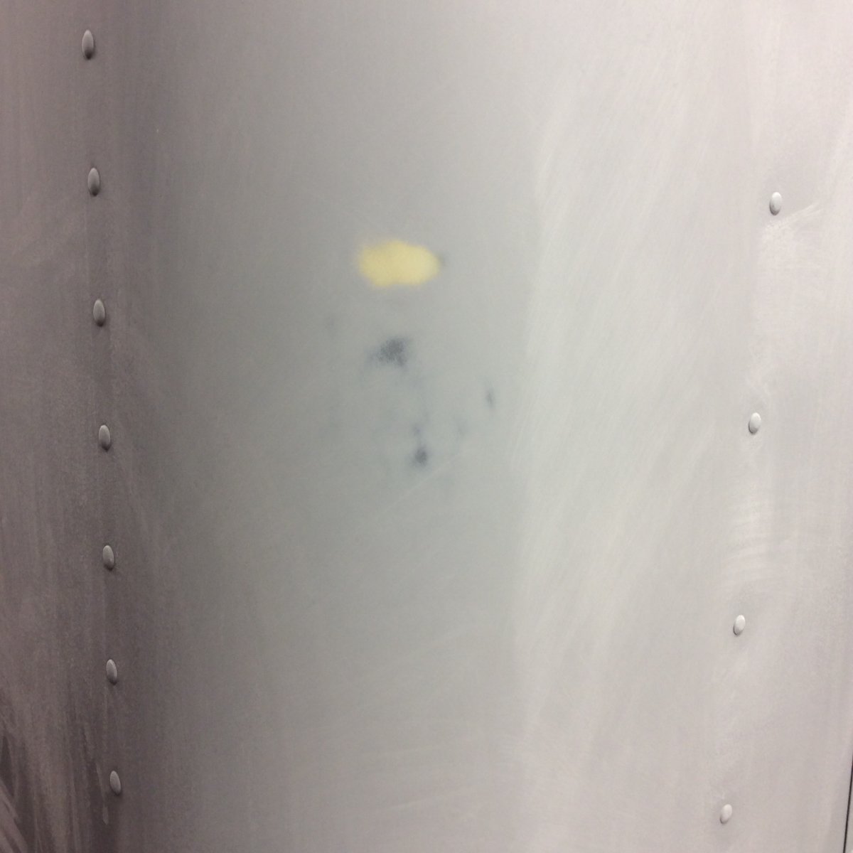

    image.jpg image.jpg Hello from Texas . Mr. Guru I have a question. I'm doing a big project that I'm painting in sections as I go . I'm in the process of doing the sleeper now . I'm painting with a turbo gun I love it for color but no so much for primer . I coated the stripped body with epoxy primer , then covered with 3 coats of surface primer after doing minor body work . Block sanding today and I got into some plastic and epoxy . Will be top coating with single stage paint in color . In this spot should I patch with more primer before I paint or can I paint as is . Love this site and thanks for the help . Paint is PPG . Will never do another project with rivets , 256 in sleet alone , not fun to sand . Blue
  7. K13
    Joined: May 29, 2006
    Posts: 10,016
    K13
    Are you planning on applying a sealer before top coating?
  8. JOYFLEA
    Joined: Jan 22, 2013
    Posts: 2,056
    JOYFLEA
    Wasn't going to use a sealer that you buy . I learned to use color thinned for a sealer . But that was in the old days when we made pigment out of ground dirt . LOL really I don't know much about this new paint . Blue

    I think you will be fine painting right over that spot. Just Paint over that spot first until you get full coverage, giving proper flash times between coats, then start painting the rest.
    A tip for sanding big panels with rivets , get a velcro pad for your da sander and stick a full sheet of a red scuff pad on the da and now you can sand over the whole panels without issue and you don't have to worry about sanding the rivets to bare metal.
